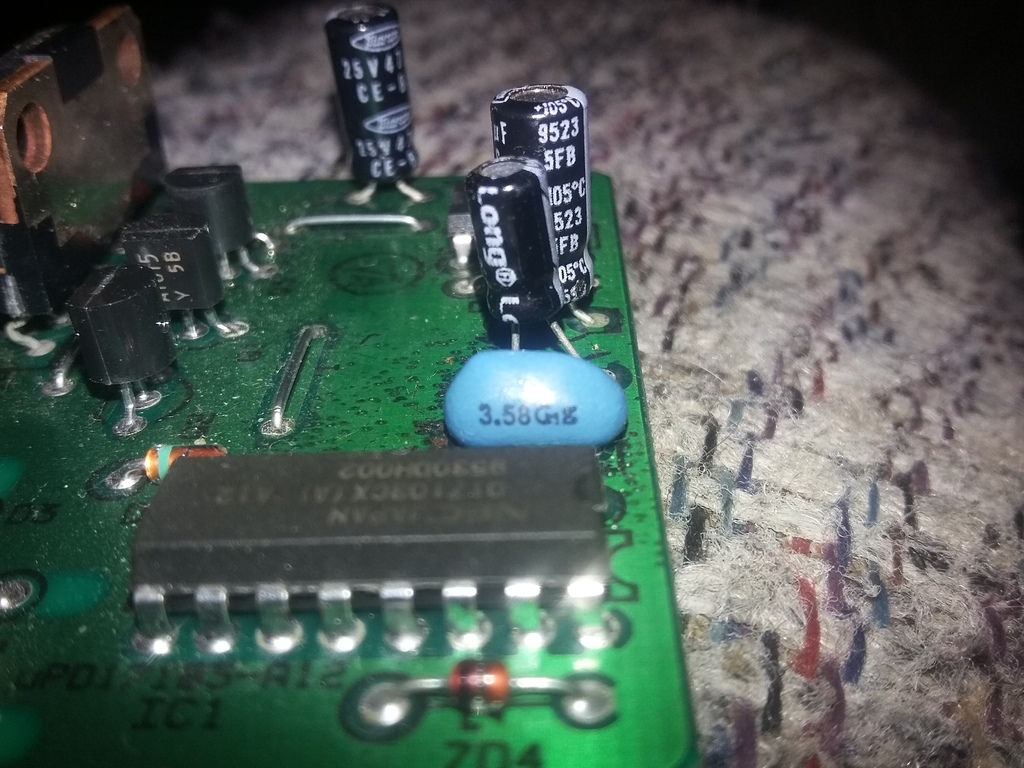

This is off a 94 toyota camrys power antenna relay. Looks as if it exploded so trying to identify this so could buy a replacement. Its the blue component in the picture it has three pins thik maybe its a capacitor or ceramic resonator or a crystal.

That blue component looks like a ceramic resonator (oscillator) for the chip next to it. 3.58 is probably its frequency in MHz. That is a very common frequency as it divides nicely. Looks normal to me in the picture. They often look like gum drops.
Another view might show the defect you suspect.
Well right next the pin on the under component looks as if it shot its guts out and removing the green coating of the board. Not sure how well you can see it in the background but the black specs on the board is its guts.
In which case it's more then likely there's other damage, unfortunately. Possibly a dead microcontroller.

It looks to me that there is a missing capacitor where the silk-screened circle is... Almost certain that just replacing the missing cap will not fix the underlying problem, which is likely to be a burned trace on the pcb...
There must be '94 Camrys in car junk yards by now...

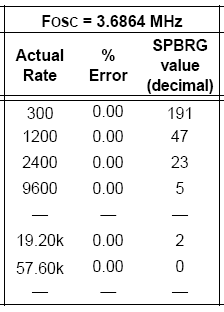

I don't know why "3.68" MHz was chosen instead of "3.69." It is a standard frequency and gives little error in baud rates, e.g.,
It is within about 0.2% of 60 x 60 x 2^10 (exact= 3.686400 MHz) .
Why its label is rounded down is a mystery to me and something I never lost sleep over. Maybe that was done to accommodate 60 x 60 x ((2^10) -1) too. Its next doubling is often called 7.37 MHz, which implies to me that calling it 3.68 instead of 3.69 was not done out of ignorance of the exact value.
I think you are confusing 3.58 with 3.68.

You are right. The numbers on the part are 3.58 and being so accustomed to 3.68, I saw, read, and typed 3.58, but my brain was thinking 3.68.
Sorry.
