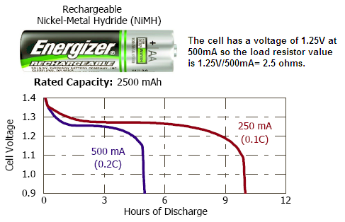

I think you should look at the datasheet of an Energizer Ni-MH AA cell.
Its capacity at a current of 1A is almost the same as at 10mA.
