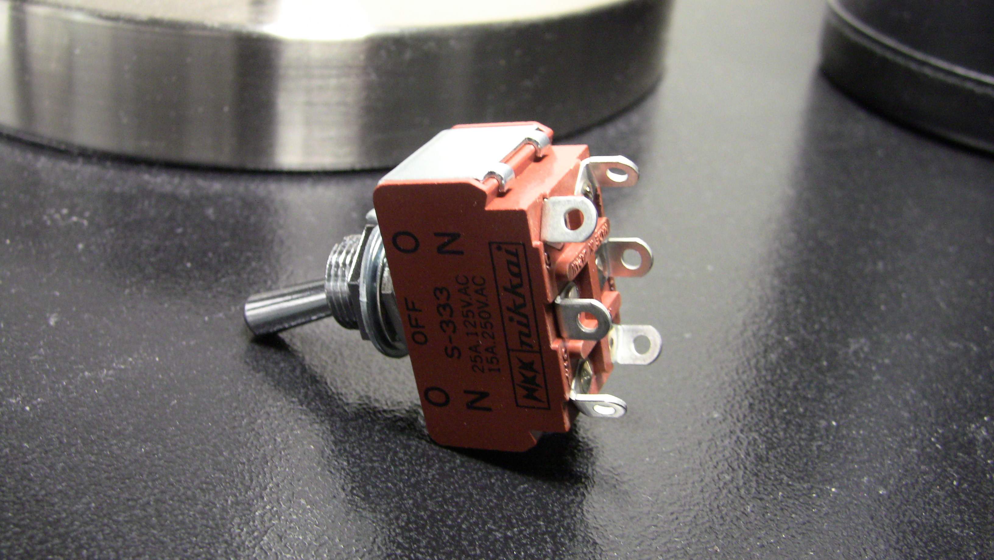

Need Help Making This Circuit Idea Work With As Minimum Components as Possible
From what I've been seeing online, they reduce the Amps by 10, and add 12v, and that tells you if you can use it or not for your DC system. Just wondering if I'm doing this right just for future reference?
That sounds like internet folklore, not any kind of substantiated science. I'd say forget it. You should derate the switch (because it's being used with an inductive load, the mower motor), but not by that weird-sounding scheme.
Didn't know they had a live chat feature on their site. Just finished talking to Chris on their live chat and told him a little about what I'm doing and he recommended this On-Off-On switch: http://search.digikey.com/scripts/DkSearch/dksus.dll?Detail&itemSeq=101550584&uq=634442981645526704
It's a little cheaper, and he also stated that, some ways to check if the switch will not work is if the switch is getting very hot, or if it stops working obviously?
I think I'll try this one first then use the one you linked to which we "know" will work. I just really like the extra Off position
lol. Okay, I was seeing that word being used as well, "derate" which I don't understand how I'm suppose to do that? Can you please elaborate the process?

Does this circuit look right to you for what I'm trying to do, as it seems like something may be missing or I may have hooked up something wrong: **broken link removed**
*Since multisim doesn't have the on-off-on switch in my library I had to just use the on-on dpdt switch.
I'm thinking a diode should go in front of the AC chargers + connection...or maybe not.

It just means reducing the rated value of something to give a safety margin. There are rules for how to derate various things (voltage, current, on time, etc.), but it can be done by a seat-of-the-pants approach as well. For instance, reduce the rated current (of the switch) by 75%. It may not be totally technically accurate, but it is a step in the right direction at least.
Looks good to me. The snubber diode is correct (but you might as well spend the extra 10 cents--literally--and get a beefier diode, like a 1N4007).
Electrically the on-on and on-off-on switches are totally identical. One just has an "off" position in the middle.
Not needed, since the switch completely isolates the charger from the motor.

Yeah I understood the basic meaning of it, however, I wasn't sure if I was already doing that in my circuit. In other words, do I need to buy something else for this circuit so that I'm correctly derating the voltage/current like a resistor or something?
Two basic questions here: 1. What happens if you hook up the diode the wrong way, what signs will you see? 2. I understand when using induction motors people recommend these diodes, however, I'm not fully clear on the overall picture of what they help protect that the motor can possibly destroy. Does the diode help reduce the large starting current or something else? I'll probably google this a bit more later though...
Lastly, what's your address so I can send you a chocolate cake! lol Seriously, you and some others here are so darn helpful it's amazing! Thanks a ton for your help thus far.
The diode will keep the switch from arcing due to the inductance of the motor. The switch won't last long without it.
If your motor draws 25 amps I would get a bigger diode that the 4007. If you put it in backwards it will smoke.
I'd suggest this switch from Digi-Key instead. It's rated for 30 amps. Even so, it probably won't last forever. Your application is a hard life for a switch.
Well according to, ronv, the diode (4007) should help protect to switch? Is there another component I can place in the circuit to help extend the life of the switch.
And I know in my original post that on the switch on the lawn mower it showed 25A, however, that's most likely the max that the mower will ever reach, but more than likely the amps will range from 5A - 15A tops. Only time will tell once I test it and hook up an Amp meter.

Okay I received the switch in the mail today, still waiting on the diodes though, but I am curious about what connector types fit on the end, and where can I buy them locally (Autozone, walmart, etc?)?
I also bought one of these **broken link removed**, and wondering if I can turn it off with a simple radio shack 125VAC 16A switch while it's connected across the 36v battery? I would think so since it does not draw much current, I was just unsure if the motor in the circuit would damage it some how or is it isolated from that side?

Anyway, I know you are busy, but regarding the derating, do I need to place something else in the circuit? That's basically what I'm worried about before I hook up this switch, as you and others said it should be derated.
Thanks carbonzit!
Are you talking about this new switch, the one to turn the voltmeter on and off? Why would you think it needs to be derated? All it's doing is controlling the tiny bit of current the voltmeter draws. Doesn't matter if you hooked it up to a 10 billion-amp bank of batteries: all it'll ever see going through it will be the 20-30-40 mA of current the voltmeter uses.
Nope talking about the original switch (dpdt) which will be controlling the AC charger and power to the motor. I know this new switch from radio shack doesn't need to be derated .
So what do you recommend about that one since it will be having more amps going through it?
Do you mean more current because of your little voltage meter?
I wouldn't worry about that, if that's what you mean. It's a drop in the bucket.
No, going back to your Post# 21, you said the following: You should derate the switch (because it's being used with an inductive load, the mower motor).
And I'm asking, or been asking what do I need to properly derate the switch? Or is my current circuit already doing that with the diode? I just want to make sure I'm not missing something in the circuit.
