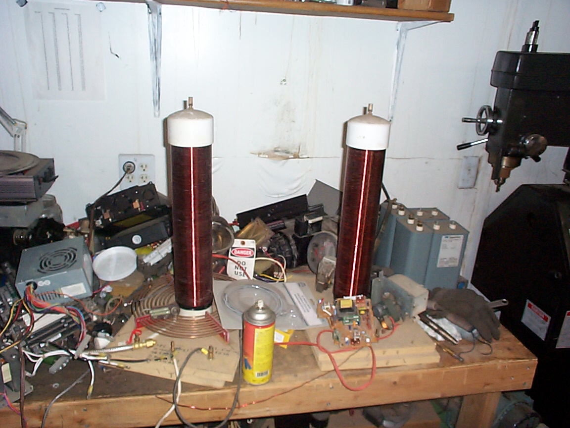

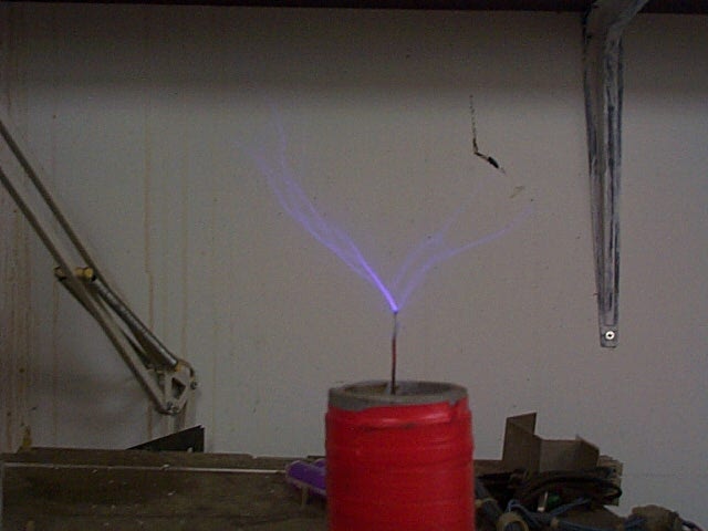

And here are two pics of my experiments. I run toroidless designs. Bit harder to do though, more math is involved and a number of misc factors come into play as well. The red one is a 3 inch PVC with a 6 inch discharge.
The pair are a matched set for doing wireless power transmission experiments. The right one is the reciever but does not have the drop down coil in place. once its tuned properly it can run a 12v 3 amp load 15 feet away from the transmitter. And the transmitter shows a loading effect too.
