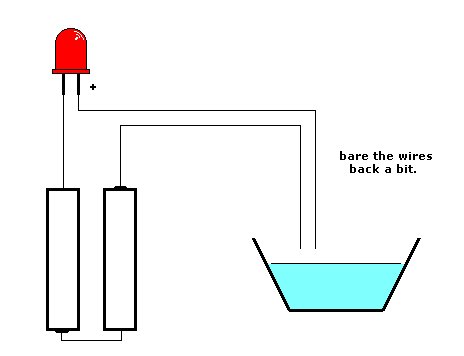

please help me in making circuit diagram of my project.
"i want to make the water over flowing project which geton/alaram when the tank is ful or going to overflow"
please help me me by giving me circuit diagram of this project

do a search for an audio oscillator, and build it. As soon as you managed to produce a tone, your circuit is 99% done.
Now disconnect one battery terminal from the circuit, and instead of connecting the hanging wire and the battery terminal to a switch, you connect it to the water. Yes, use another wire! You dont want both battery terminals to be simultaneously connected to the water!!!
An alarm could be just a red LED.
In which case all you need to add is a couple of single cells,
and some wire.
Just position the wire ends to touch the water at the desired level,
and put the LED somewhere visible.
(my post has crossed with Nigel's - i found that the water made
a suitable resistor for the LED, did it in a cup, only took a few
minutes.)
