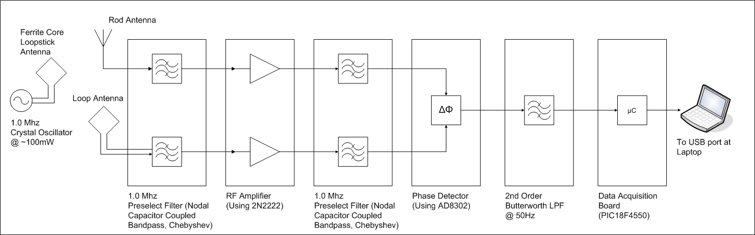

Hi, is the BJT amplifier suitable for a sin wave with a swing around 4vpp amplification? Or any suggestion on the amplifier that should i build for the above-mentioned purpose?
By the way, there is only one amplifier for each channel in my design (as shown in the diagram). Will the amplifier provide enough amplification (20dB) for the received signal? Or should i add another amplifier in the design (each channel in receiver part)?

I do not understand. You have not defined the purpose of this amplifier enough yet. Is this amplifier shown in your diagram? If you are referring to the RF amplifier between the filters on your diagram, then I do not expect the signal to get as high as 4Vpp. This is meant to be, as we call it, a small signal amplifier, that is, one that does not have to deal with large voltage swings.
For each channel, we have the choice of having only 20 dB to start with, using one transistor, or we can decide to put two transistor amplifiers in cascade to get 40 dB. More than this would not be a good idea. The sensitivity of the phase detector is about -60 dBm (if I recall correctly), so we can expect that one amplifier stage in front of that chip will improve the sensitivity to about -75 dBm. This might be enough for your purpose. I suggest that we settle for using one amplifier for each of the two channels in hopes of getting sensitivity of -75 dBm. It is important that the amplifier provide not only power gain, but also a reasonable noise figure. For now, we will focus on gain and not worry too much about noise figure since this is difficult to measure anyway. We might assume that if we build a good amplifier, we might hope for a noise figure of about 4 dB or less.

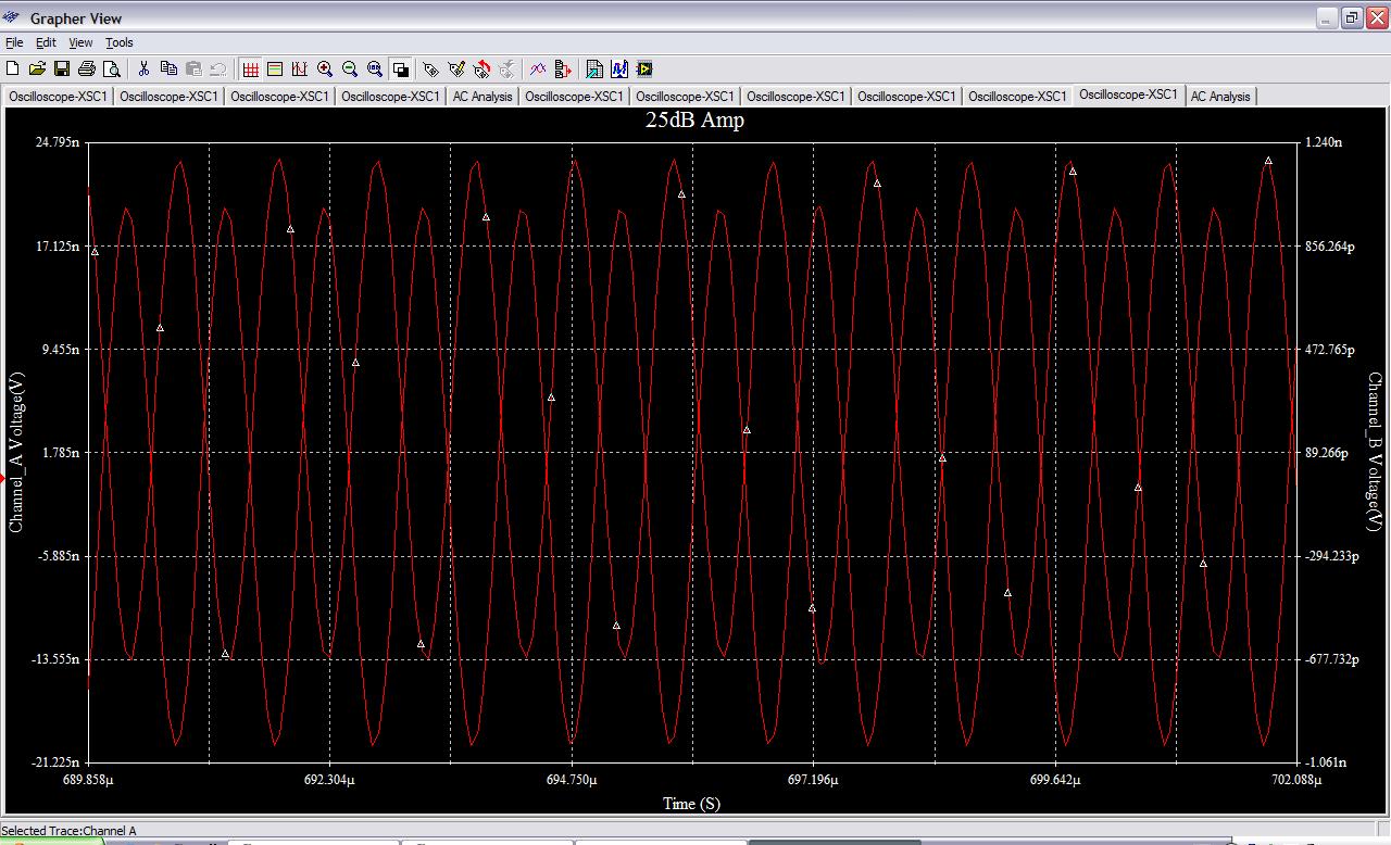

Sorry, I have misconceived the usage of small signal amplifier. By the way, i am planning to add a power amplifier to the output of the crystal oscillator to boost the transmitting power of the transmitter to 20dBm (100mW) if possible. Do you have any suggestion on the type of amplifier that i can build?
I have rebuild the small signal amplifier, and it works quite well where it produces 20*log (37/2) = approximately 25dB of gain. I can only simulate the circuit using the signal ranging from 1micro to 1nano Vpp. The simulator went wrong when I was trying to simulate the circuit using 1 pico Vpp signal. On your opinion, does this amplifier work well? (The diagram and waveform included).
