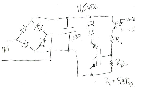

What I want to do is replace the bridge and triac with a DC power supply and use a IGBT to control the motor. I ordered the parts and wired it together. Just a bridge and capacitor, I shouldn't need anything more elaborate should I? I've got a little more ripple then I expected, but more capacitance should take care of that.
My question/problem has to do with the transistor. It's not turning on. I have a opto-coupler with the collector tied high, and the emitter bringing up a voltage divider tied to the base of the IGBT. The data sheet says it needs 20 volts (emitter to base) to conduct. Do I need a current limiting resistor in the base? I just don't have any experience working with them.

Post a schematic of what you have so far.

first, the spec is not how much it takes to turn on the IGBT, it is how much is safe to apply.
second, IGBTs do not have bases they have gates that love to see over an amp for under a micro second for each transition.
third, triac drives are difficult but not impossible to get to work at low speeds.
start with a PWM IC. filter the motor voltage and apply it to the feedback pin instead of an output voltage. apply a speed command voltage to the feedback pin as well.
that will work much better but will still bog down a bit at low speed due to the voltage drop across the armature resistance. this can be sensed and fed into the feedback junction as an error term as well.
This is EXCACTLY how simple treadmill motor controls do it.

I don't want to just slow down the motor, I want to control the speed. I have feedback through a 1024 line encoder to a PC, and the PC outputs the pwm. What I want to do , and what I'm having trouble with, is controlling the motor. I've attached a schematic of what I'm trying to do. The opto-coupler in the upper right is driven by a transister with 24 volt supply. This transister is controlled by the PC.
Yes, I said base, I meant gate. Call it a typo. :)
Maybe the IGBT isn't the best device for this. If the gate needs an amp to turn on, it's going to be drawing as much power as the motor. I've not been able to find anything that mentions anything about the IGE
Maybe a Hexfet or something.

You have an opto that will stand up to 200V?
At what frequency are you attempting to PWM it? Neither the PC or opto is likely to be able to do it. At normal PWM frequencies "standard" speed IGBTs would not either since they are rated for only 1KHz hard switching.
FETs and IGBTs REQUIRE over an amp instantaneous to switch properly. Gate drivers are typically very small parts since they are only required to supply the rated current while the device capacitance is being charged or discharged. Average current required can be determined by multiplying the "total gate charge" spec by the operating frequency.

Which particular IGBT are you using? Are you within the maximum voltage and current specifications? Do you have it connected correctly?

An IGBT is a voltage controled device! Unless your running a 1200 volt 600 amp IGBT at 40khz consider it a voltage controled device ZERO amps Gate current.
Also IGBTS typicaly are at full on by under ten volts. The 20 volt number is the internal zener diode protection voltage. ;)

OK, the IGBT I'm trying to use is IRGB4B60KD1. I'm not married to it, just kind of picked it out. I'm pretty sure that I've got it connected right, at least according the the drawing I attached to the earlier post.

at what current?
check the circuit... that IGBT is only good for 10-30KHz and the opto is likely to only be good for 50V and 3KHz

According to my calculations, the motor draws about 1.6 amps at full speed.
Right now I'm investigating a mosfet driver. From what I've been reading, IGBT's are recommended for 600 volts and over, mosfet's for less then 250 volts.
The program I'll be using to control the drive / motor has a number of ways to do it, with either PWM where I can set the frequency. or PDM what they call pulse density mode where the computer sends out a pulse of set width, less then a millisecond, but then increase the frequency to control the speed. The computer is pretty busy, counting pulses from the encoder, and sending out pulses for this motor, and also two axis. The third axis, "Z" doesn't move that often. I think it's pretty amazing just to watch it "do stuff". Sometimes it really gets busy.

smaller pulse widths, either the ON state or OFF state, load down a CPU. as I said before, you need to compare the frequencies with the speeds of your parts.
you also need to supply a separate gate supply since neither the opto or gate can handle line voltage, which I implied earlier.

As far as the voltage, I've got a small variac that I can use to lower the voltage to 100 volts DC or so. That should make it a little easier to find a driver and mosfet combo.
One thing I liked about the opto was it allowed me to isolate the higher DC from the rest of the circuit. Maybe it doesn't make a difference. I don't know.
