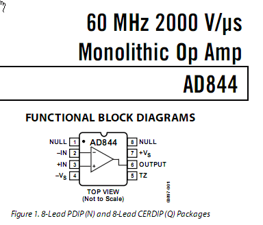

I have run into a problem trying to use the AD844 model in LTS, I will try once more.

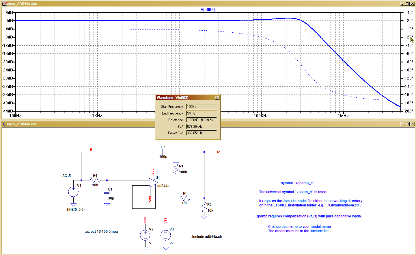

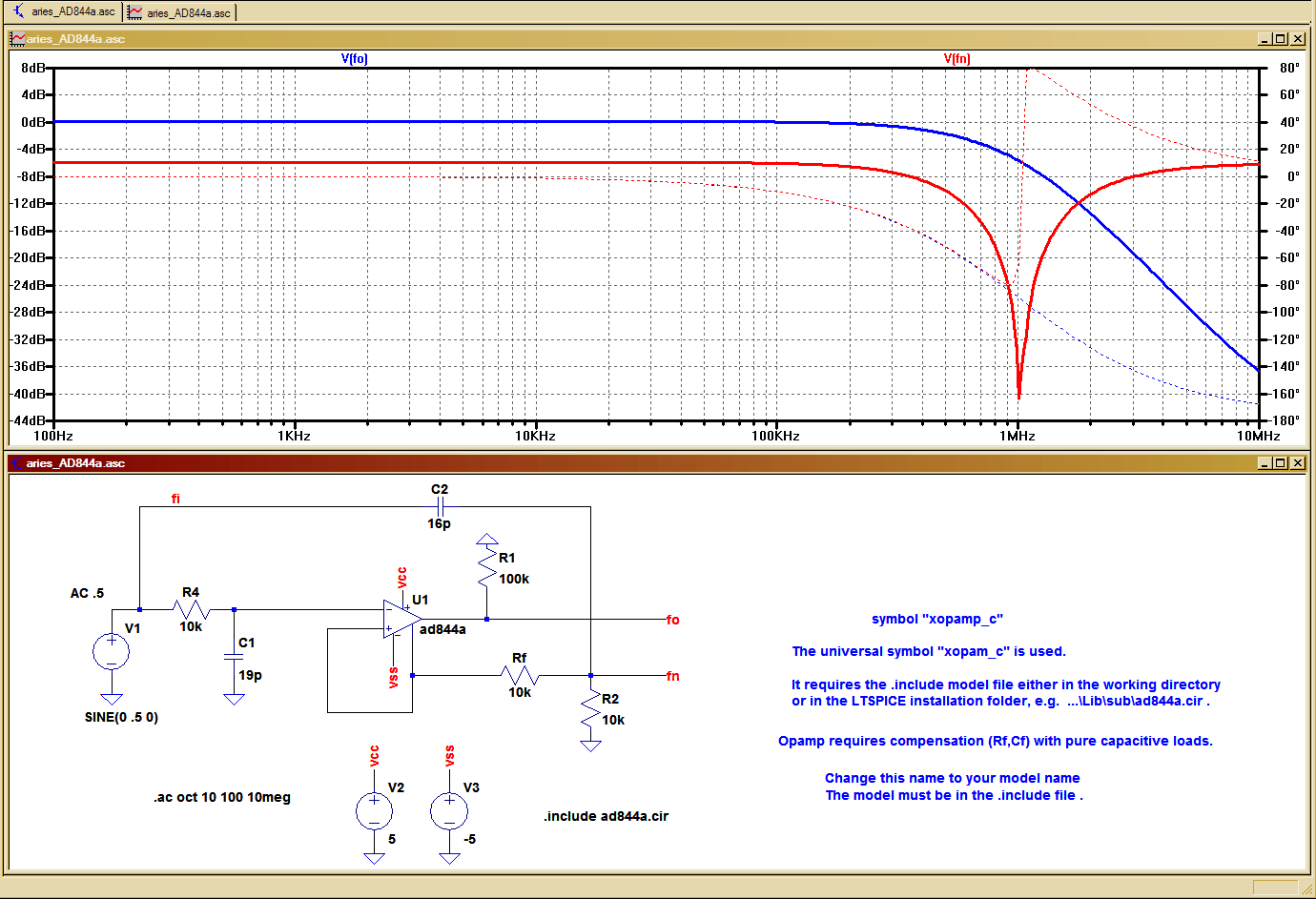

Downloaded LTspice model for the AD844A, using your values this what I get.
I would say your filter values are incorrect for a 1MHz point.
EDIT2:
Option2, later version shows the notch at 1MHz.

Look at my second image in my last post, its set for about 1MHz, use the new component values and pin 6.
Use pin 6 of the AD844 to measure the output using the scope, not the TZ on pin 5.
hi
I want the output from pin 2 (required ). Why u are taking output from pin 6. Any reason for taking output from pin 6?

When i designed the same filter circuit which you have sent me with the values having cutoff at 1MHz. I have simulated this circuit on Pspice but i am not getting the cutoff at 1MHz. Why i am getting changed cutoff ? when the circuit is same yours cutoff of the circuit you sent is 1MHz and i am simulating the same circuit i am getting cutoff at 300KHz why like this?

I want the output from pin 2 (required ). Why u are taking output from pin 6. Any reason for taking output from pin 6?.
Because pin 6 is the output pin of the AD844, pin 2 is the INV input.
Please post your Spice circuit diagram, where are you measuring the output of the AD844.?
