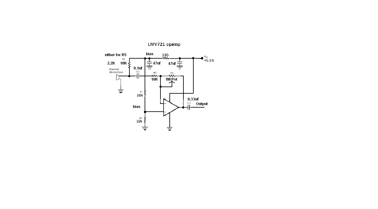

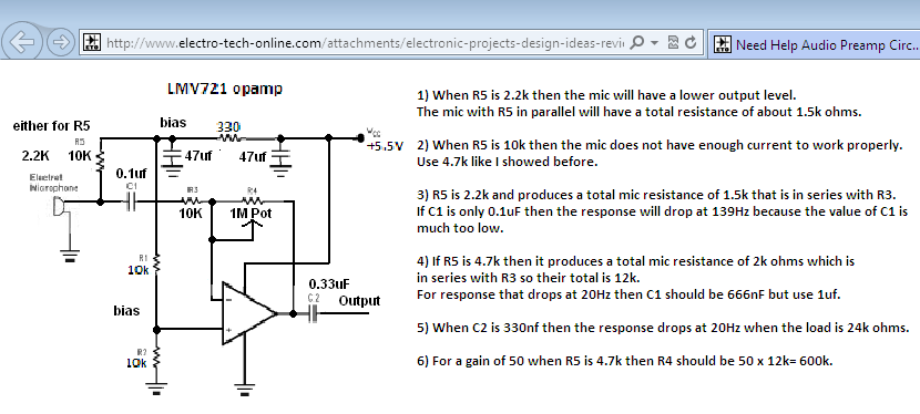

Enclosed: Circuit thats in post #21.With the changed parts that i have on hand.
I need exactly a gain of 50.With out loosing any gain.at the highest FQ 20Khz to
the lowest fQ of 20Hz.
Tell me what will happen with those values with the changed circuit. And what parts would need to change.To get what i need.

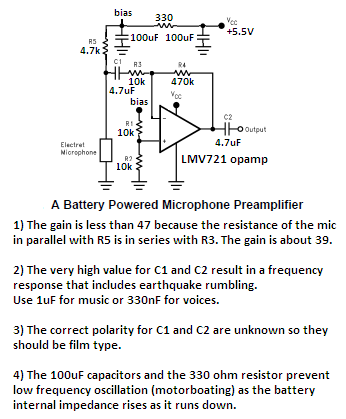

You need to learn when parts are in series and when they are in parallel.
You also need to learn the simple formula to calculate the value of a coupling capacitor for a certain cutoff freqyency.
I comment on and correct your schematic here:

The 1M trimmer pot can be use at 600K. The 1M is what i have.
My mistake.I Had a 4.7K and 10K. It was not 2.2k.I tested the resistor with my multimeter.Was
4.68K 5% gold band 1/4watt. Close enough.
So i will use this. As you suggested 4.7K.

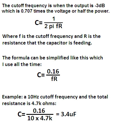

What is the simple math for calculating these capacitors for the cutoff FQ.Please explain.If you May.
Also! I only have 1uF caps in my juck Box. So i wrote the wrong value it should of been 1uF not 0.1uF.Sorry!
For capacitor C2 should that be a 1uF cap also as C1... Is 0.33 to low.:confused:

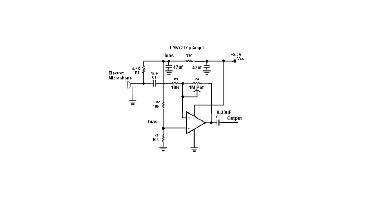

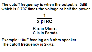

The simple formula for calculating the cutoff frequency or calculating the capacitor value or resistor value if you know the other two is:

If Capacitor C1 is at 1uF shouldn't C2 be the same value capacitor at the ouput.Correct!
Or should it be 3.4uF for a cutoff of 10hz.Not sure.
If Capacitor C1 is at 1uF shouldn't C2 be the same value capacitor at the ouput?
The value of C2 depends on the resistance it feeds. A power amplifier or a recorder?
If it feeds 12k ohms then the cutoff frequency of a 1uF output capacitor C2 is 13.3Hz.
The input 1uF input capacitor and the 1uf output capacitor each reduce the output at 13.3Hz by -3dB or 0.707 times the level. Then both add to produce an output that is -6dB which is 0.5 times the level of higher frequencies.
If the power amplifier or recorder input is 12k ohms then 26.6Hz will be -3dB which is 0.707 times the level at higher frequencies. -3dB is heard as a small drop of level.
