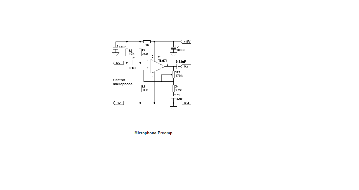

Hi
I came across this preamp by doing a search on this site. I been trying to find a TL071
preamp circuit. This amp was posted by poster Audio guru.
I have a direct upgrade replacement IC that has a lower operating supply voltage of 4.5V-16V
Will this amp circuit work as is with the TLE2071IP upgrade IC.
I like to use this preamp circuit.
I will be using 5.5V for my supply voltage.
Also is the 1k resistor directly connected to pin 7 or is it just connected to the positive supply
rail.Please explain. Will i need to add or change any parts for the circuit to be functional at
the supply voltage of 5.5V.

Hi...Will this amp circuit work as is with the TLE2071IP upgrade IC....QUOTE]
Not according to the datasheet.
For single supply Vcc situations, TI recommends using the "TLC" or "TLV" series chips.
Fit the chip in a socket and try it, although what are you hoping to gain with the later chip? - I suspect you will see VERY little (or none at all) difference.
The TL07x are really extremely good chips.
You can get a TL081 at radio Shack - almost as good. And yes the 1K is just to the positive supply.

Are you using a single supply? The TLE2071 specifies a dual supply, e.g. ±5.5V.
This one is real good and swings close to the rails.
Yes! I'm using a single supply at 5.5V.

The TLE2071 minimum supply is plus and minus 2.25V so it will barely work with a single 4.5V supply if its input is biased at half the supply voltage.
It will work fine with a single 5.5V supply in the TL071 preamp circuit.
Its gain is very high as a mic preamp so I doubt if its inputs will exceed the input common-mode voltage limit.
Dont think about using general purpose op amps for audio work. Generally they are too noisy.

Very sorry, but that's complete and utter nonsense - almost all opamps in top end mixers are normal standard opamp types.
The TL07x series make exceptionally good audio stages, and replacing them with supposed 'better' ones generally makes no difference.
The old LM833 is a good dual audio opamp designed to be the preamp in a record player or in a tape recorder/player (remember them?).
Some "audiophools" use an OPA2134 dual opamp with distortion at the extremely low level of 0.00008% and add a class-A load to reduce the tiny amount of crossover distortion that cannot be heard anyway.
The LMV721 opamp makes a good mic preamp. Since it does not have the low current Fet inputs of the TL071 that I use then use the inverting circuit shown on the datasheet of the LMV721.
It is tiny and is surface-mount. Can you connect to it?
Is this the reason why you are using the TL071 in the non-inverting set up.Because of the low current input.Do to the Jfets.And With the electret mic.
And the LM721 uses a bipolar transistor input.So its better to use this amp in the inverting set-up as in the datasheet.If im wrong about this,Then. Please explain!
Can i use the circuit in post #1 with the high gain as you have it and the part values you have and using lmv721 in the inverting set-up shown in the datasheet.What parts will i need to add and change
so it works propertly with the inverting set-up.And with a 5.5V power supply.
