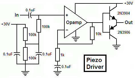

audioguru,
Can you draw a circuit used from an opamp like LF411 and emitter follower for my job...
I want to try it out too
Here is an amplifier that will drive your piezo transducer.
If fluid is used then the little transistors might melt, so use TIP31 and TIP32 little power transistors instead.
audioguru,
I made your circuit on beardbord I used a pair of BD139 and BD140 transistors, I have kind of distortion and perhaps harmonics..

epilot said:
audioguru,
I made your circuit on beardbord I used a pair of BD139 and BD140 transistors, I have kind of distortion and perhaps harmonics!
How can you hear harmonics of 65kHz?? Even bats won't hear it.
I didn't post a low distortion audio amplifier, it is class-B and therefore has severe crossover distortion. It is made for an ultrasonic transducer.
Audio amplifiers use a substantial idle current in their output transistors to operate in class-AB and include the output transistors inside the negative feedback loop for no crossover distortion.

As Audioguru says, why are you bothered about distortion?, it's for driving an ultrasonic bath - distortion doesn't matter. If you wanted to reduce the distortion somewhat (but wby?), then connect the feedback to the output of the transistors rather than the opamp.

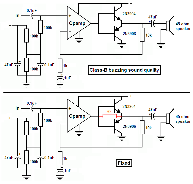

In 1980, a Telephone System made in South Korea was sold by the company I worked for. Many complaints were made by users about its buzzing speaker sound quality. It used a class-B audio amp like I posted but with a slow 741 opamp and included the output emitter-follower transistors inside its negative feedback loop which didn't reduce the crossover distortion much.
I fixed it by cutting the copper and adding a resistor so that the opamp can drive the speaker directly for the 1st volt, then the transistors drive the speaker for louder sounds.
