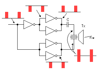

Some days ago I made a circuit like the picture to increase the input voltage of an ultrasonic sensor used as a range finder, the source voltage was 12V and the designer of this diagram according to wave forms wanted to increase the voltage on the ultrasonic sensor by factor 2 , there is a 180 degree phase shifting between output pins.
Ok the question is that how this is possible getting 24V from a simple inverter circuit?
My confusion is because there should be a complex circuit to get a NEGATIVE voltage but as you can see in the pic we have nothing more than few inverter gates,
Well, we have a 12V source and it has a +12V and a 0V, I think ideally we will have a +12V on one output pin of the gate and a 0V on another pin at a moment, there is no else component to generate a NEGATIVE voltage, so what is the problem with my understanding of this circuit?
I have this problem with bridged amplifiers too.
Thanks for any input.

No Dr. EM, there's no need for dual supplies on a bridged amplifier, and they effectively provide double the HT supply to the load - that's the whole reason for them!. With a 12V supply the simple bridged circuit shown above will provide 24V p-p to the load (minus the usual losses in the circuit of course).
Perhaps you're being confused by the scope picture on the output?, there's actually no ground reference point on the bridged output.

Doesn't the output waveform simply rotate about the operating point established by the inverter pair?
Think about a "normal" single-ended amplifier with one wire of the speaker effectively at half the supply voltage (capacitor-coupled or a dual-polarity supply). The amplifier then drives the speaker's other wire to the supply voltage or to ground. The supply voltage peak-to-peak.
Now connect the speaker to a bridged amplifier pair and one side of the speaker will be driven to the positive supply and the other speaker wire will be driven to ground. Double the supply voltage peak-to-peak.
Nigel is correct, I had a piezo curcuit (connected to a microcontroller) and I need more voltage to it. Nigel and Ron H told me to take the ground pin, tie it to another IO pin on the microcontroller, and pulse one high and the other low and flip them back and forth.
It was a 6V supply and sure enough, much louder. I even pulled out the scope, a nice 12Vp-p squarewave from a 6VOLT supply.
Yes Nigel, I was confused with the waveforms in the picture,
it make sense now, the positive and ground are reversed according to input signal and with this trick we can get a double voltage.
