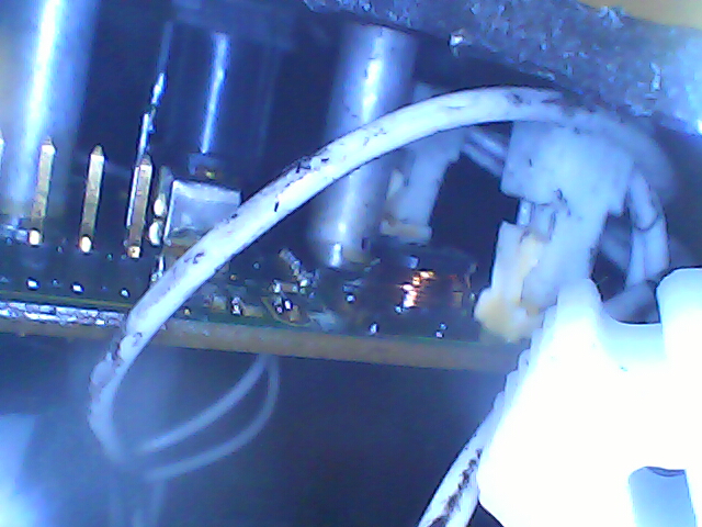

So I'm trying to reproduce something already in production, that the company has gone out of business. I'm in the process of acquiring the patients but the tooling and productions are not able to get a hold of. I need to redesign what's there slightly. And i know what they have. I can post pictures of some of the components, so you understand.

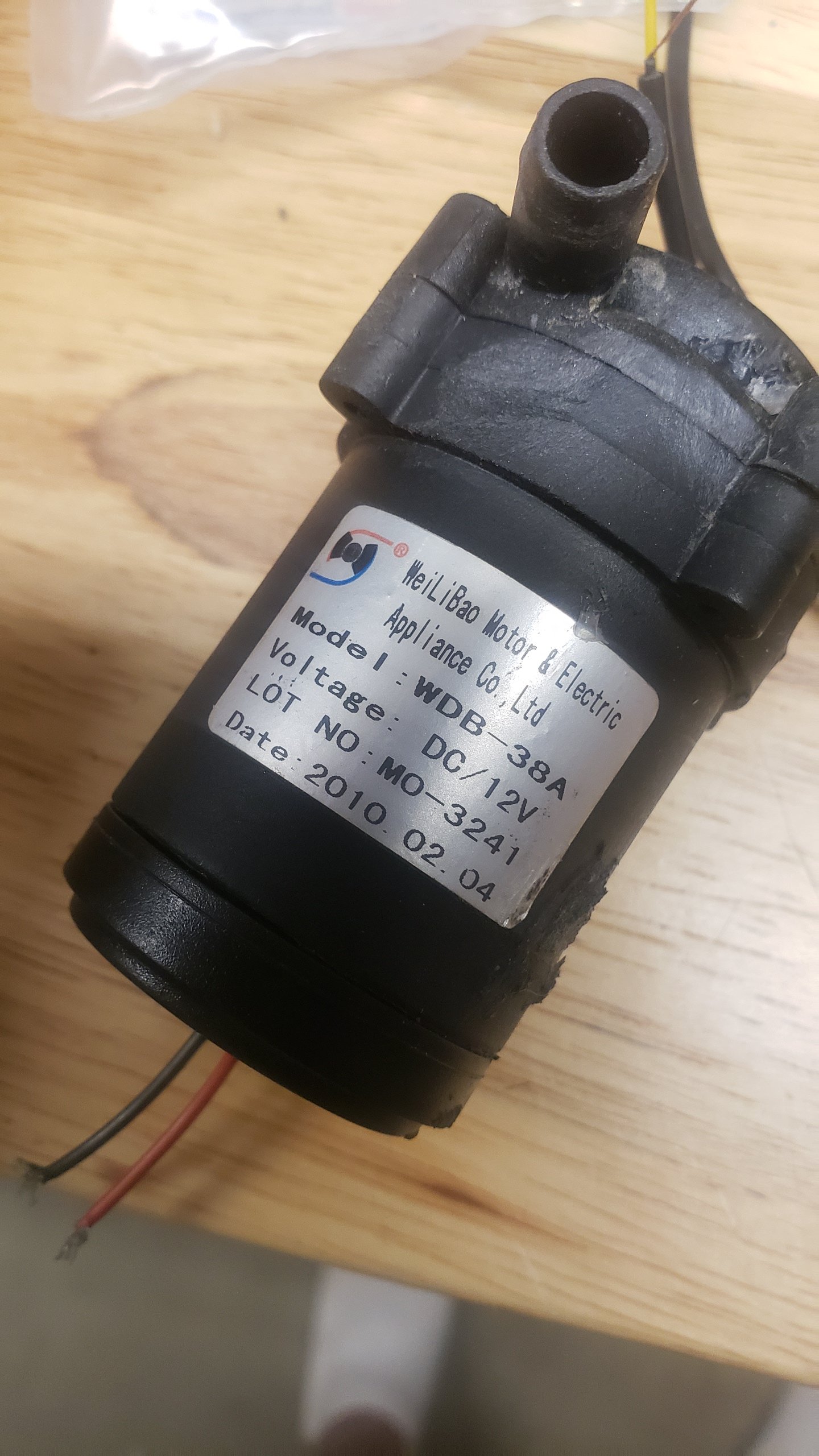

Pump that pumps the water out. Its.back and I ordered a new one.

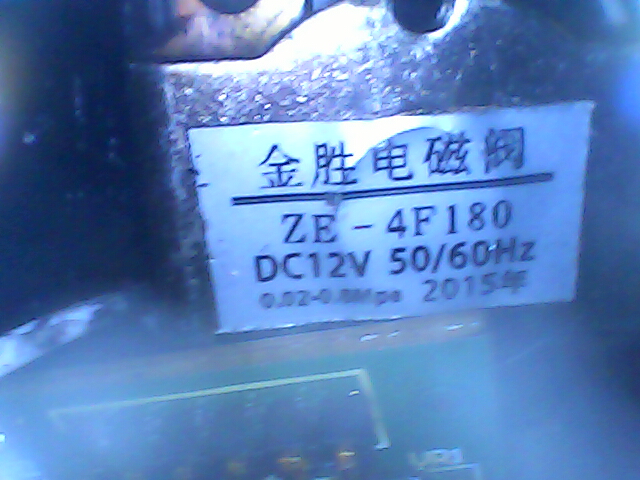

Solenoid, that comes on when the sensor, which I have yet to find, triggers it.
Pictures are taking with a borescope

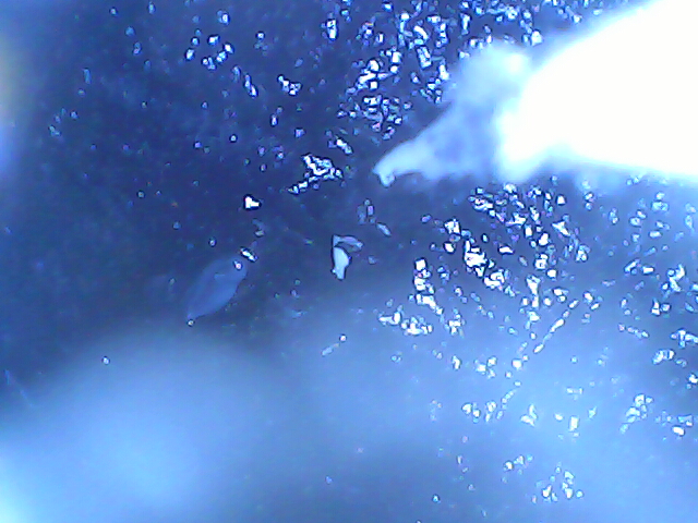

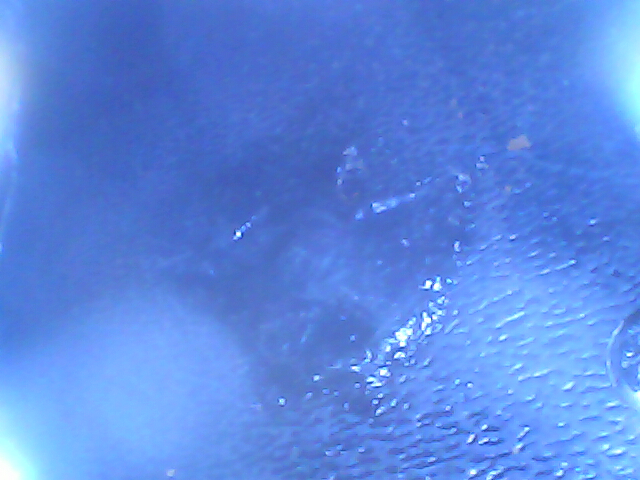

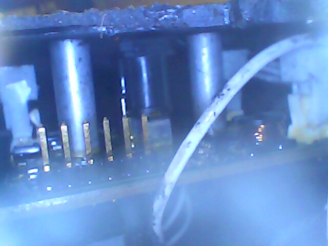

Circuit board
Front side of water sensor looks to be covered in black silicone and the back side with the white wire.

You could use a 555 timer for the water level sensing and latching, and a PIR motion sensor module (readily available and cheap) to drive the solenoid through a buffer transistor. A circuit might look like the following:
118544
Each water level switch is simply a pair of wires with exposed tips. The resistance of the water between the pair of wires should be less than 200k for the circuit to work with the 470k resistors I drew.
Sounds like what there now for the most part. What do you thing the parts would cost me to make myself, or have someone make for me?

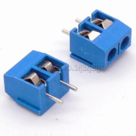

Thinking maybe having terminal connections like the picture so i can wire in the solenoid and one for the pump. This way its easier to swap them when they need to be replaced.
Parts are under $20; less if you are willing to wait for shipping from China. If you want someone to make it for you, which country are you in?
Terminal blocks are good. You'd want to have them inside the enclosure, with some waterproofing mechanism on the wire entry ports.
