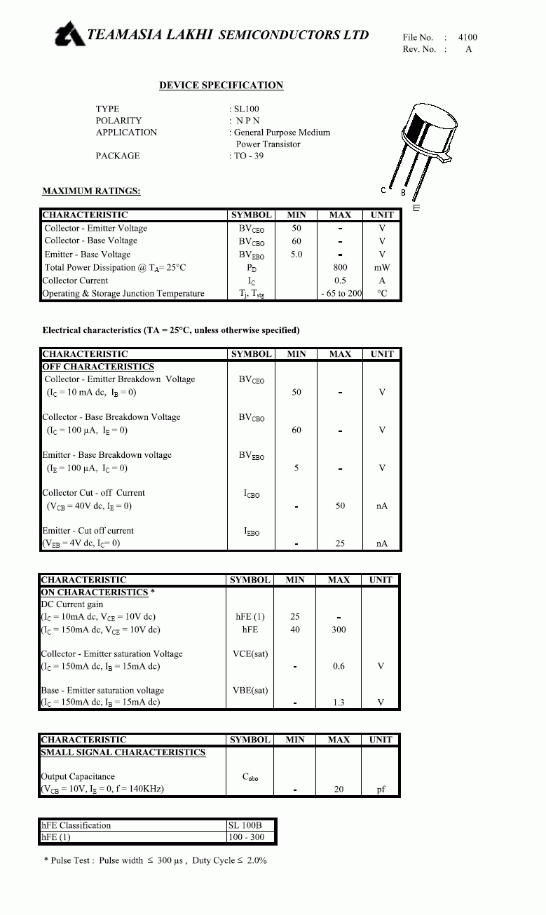

Does anyone have the data sheet for the SL100 transistor?
Does anyone know where this component is offered at retail?
Does anyone know of an equivalent transistor? I'm having a hard time finding what I believe is a NPN MOSFET transistor or detailed technical info about it. Any help and/or suggestions will be greatly appreciated.
Here it is
  • SL100_teamasia.pdf

I would probably use 2N2222 for the SL100. It would all depend on the circuit.

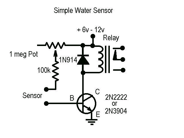

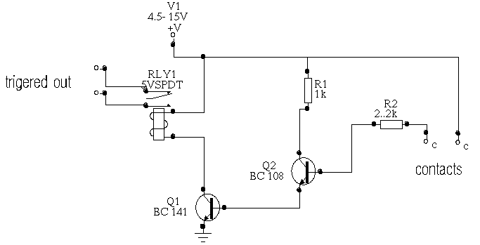

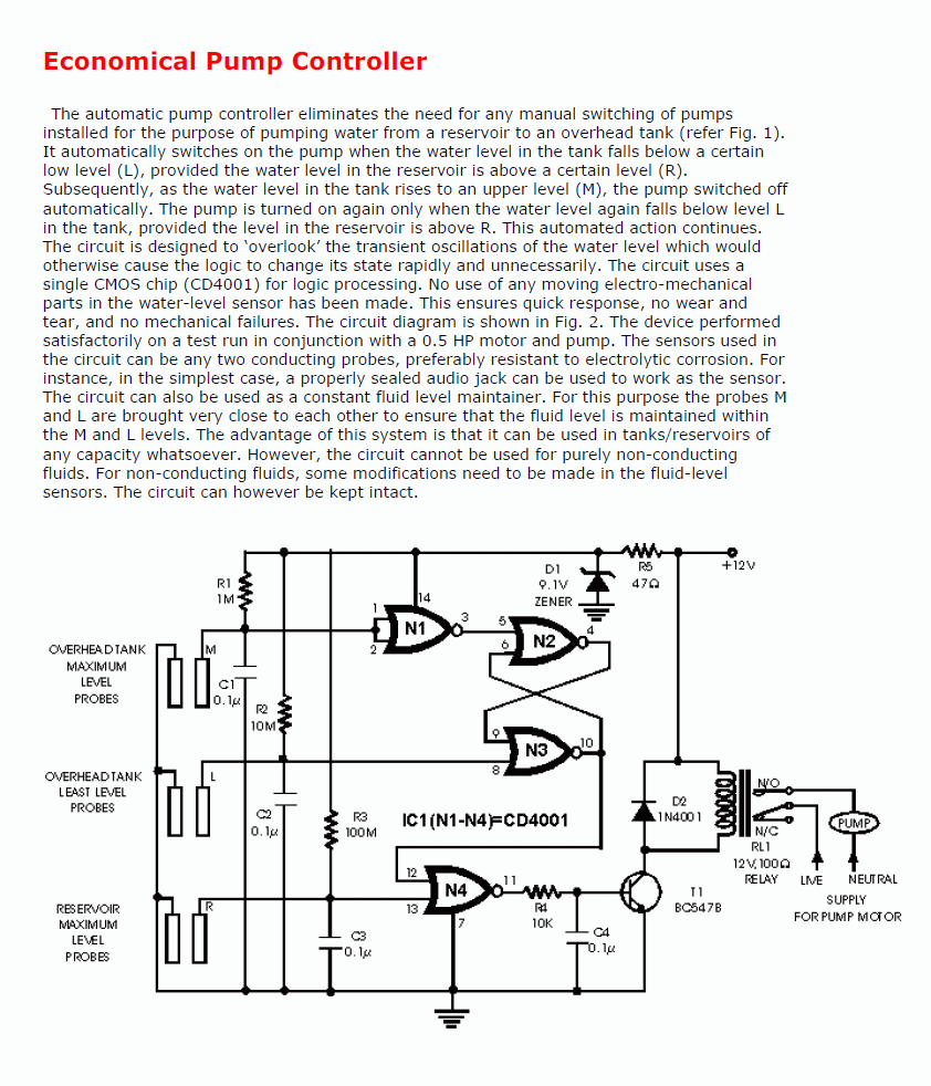

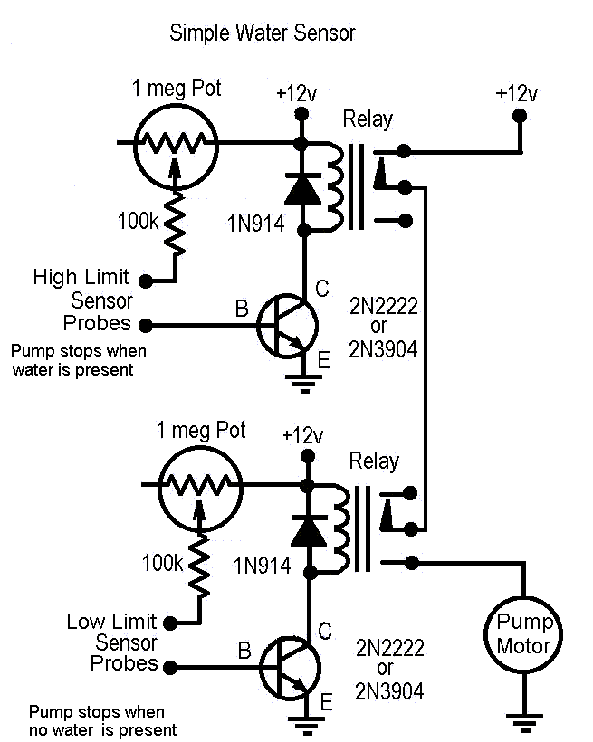

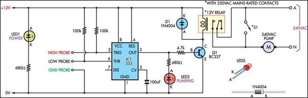

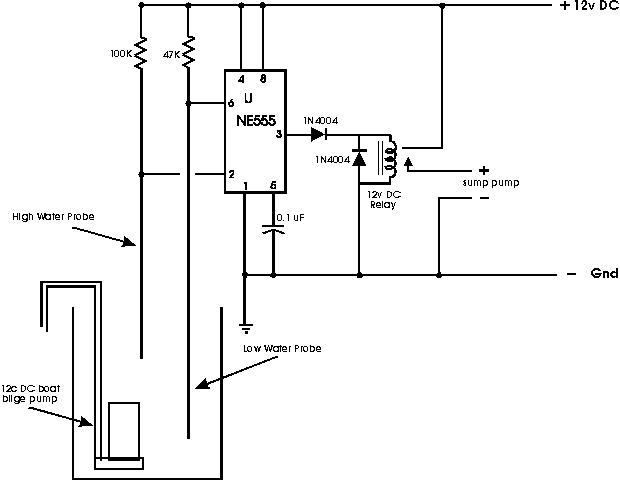

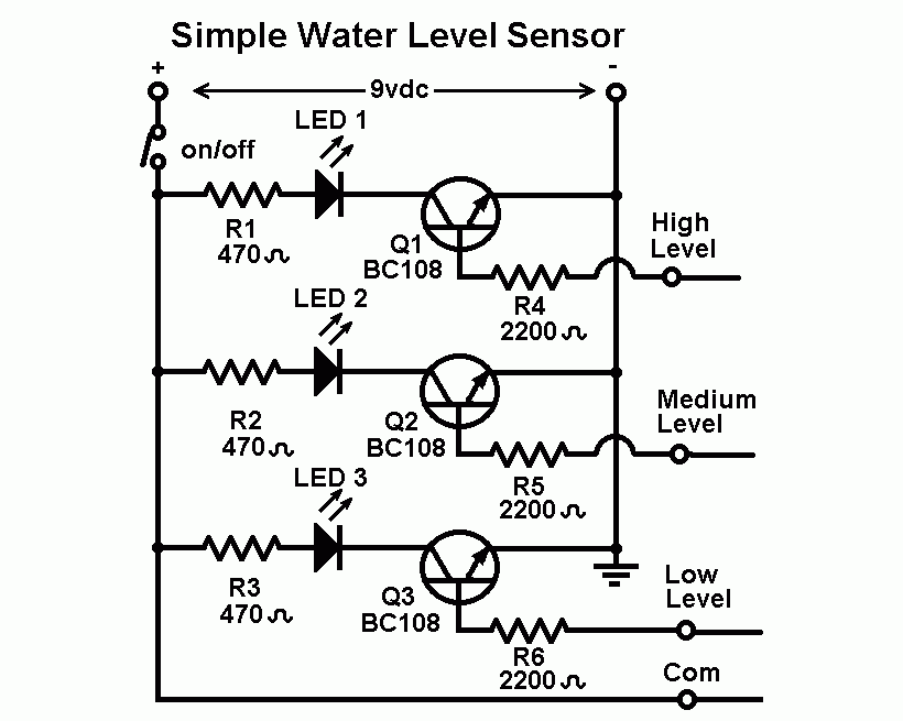

i make a water level controll ckt..but sl100 transistor are not avaliable.so what can i do. plz help me.
Make a different circuit or try another transistor
