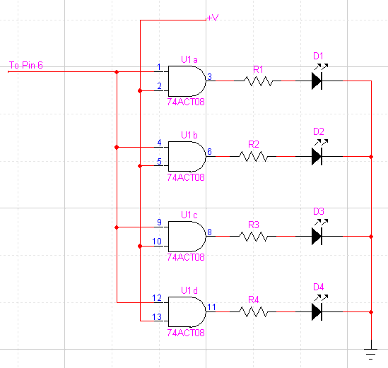

You could use a 74ACT part. They can drive an led no problem.
Wire it as shown in attached.

What if you were to use an AND gate like MikeBits recommended, but have each output of the gate drive an individual gen. purpose transistor. Then have each transistor drive a single LED.

JRZ126, thanks for the input. The problem is the weak output of 25mA (from the IR chip) and the 16mA output (of the AND chip I have installed). According to audioguru, these are not suffice to switch the transistor to push more voltage from Emitter to Collector.
