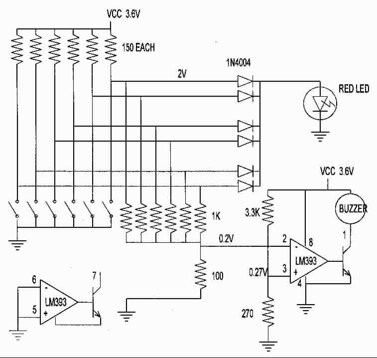

OK, 6 drawers is too many switches, try diode and resistor logic:
With one drawer open the bias on the LM393 is 0.2 volts, with two open the bias is about .4 volts and the buzzer sounds.
The switches should have been shown normally closed!

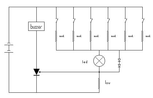

Hi pwollner,
I feel some of these replies are a little over-done.
You might like to consider something simpler.
I haven't worked out the resistor values,
they depend on the SCR.
The two diodes would be chosen to give appropriate
voltage to the led.
The resistor on the gate would be chosen so that one
drawer would not engage the SCR, but more would.
Any drawer would light the led,
any two (or more) would operate the buzzer,
the intermittent nature of the buzzer would turn it
off when the drawers are closed, or one left open.
SCR's have a very high resistance, almost open circuit
when not operated, not enough to affect battery life.
Two or maybe three U2 type batteries should give a
very long life, its hard to guess but i would expect
a year, more maybe, depends on usage.
Sorry this took so long, i think i had a mental
block.
Best of luck with it, Regards, John :)

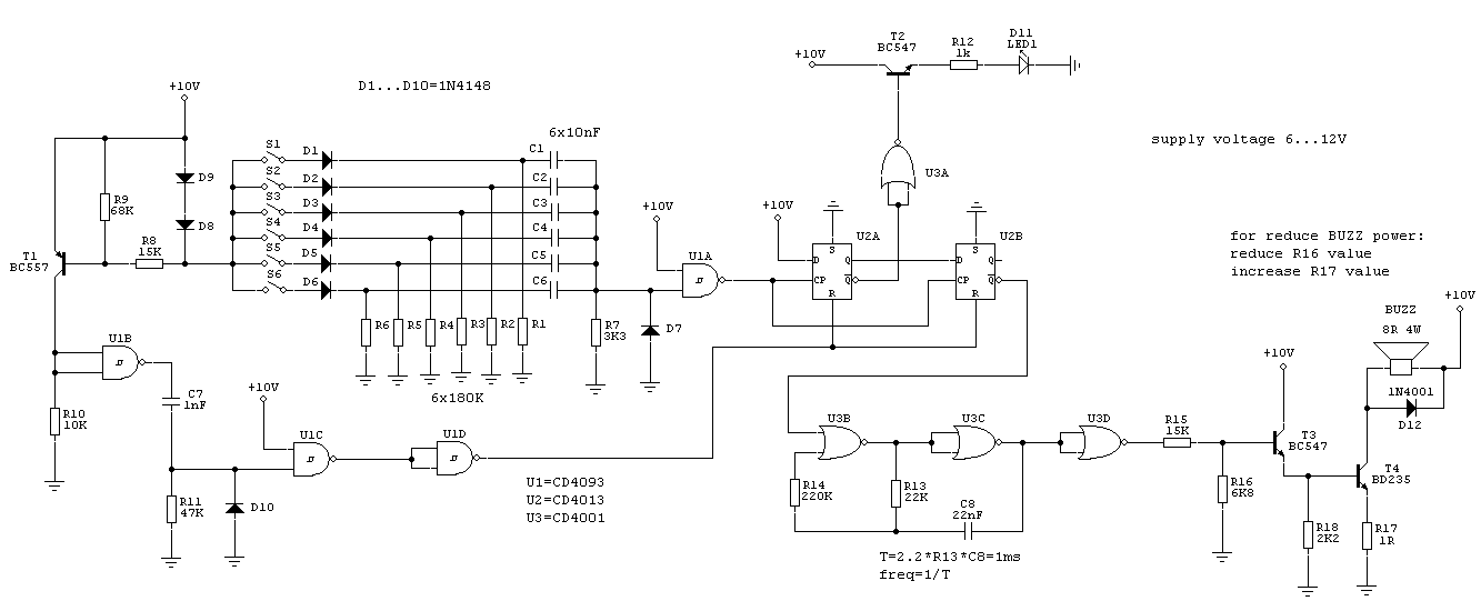

I have some comments.
1. The current will avoid the LED.
2. The SCR is trigger by current not voltage, over 0.6V a very small amount of current will trigger the SCR, this current is more small when pulse is more long.
3. The buzz will never stop.
This is a schematic with CMOS 4000.
When all switchers is open the current sink from battery is very low.
When 1 switch is close, the first D bistable is load with 1 and LED become light.
When another switch is close, while first is close, the second D bistable load 1 from first and allow NOR gate oscillator to start, so the speaker will start buzzing.
This state(LED on and buzz on) is keep until all switchers become opens, when D bistables are reset with a short pulse(50us), and schematic return in standby state.
