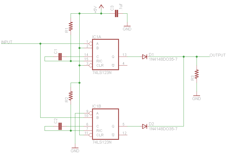

Use 1 half for positive edge detect and other half for negative edge detect and or the Q output. You can set pulse width using R and C.
The attached circuit should work, but it requires 5vdc not 9v.

Thank you for the circuit... that's a big help. Just wondering, in using the74LS123N, is it okay that the input pulsewidth is much longer than the desired output pulsewidth? I've heard that's not a good idea with the 555 and I'm wondering if it's an issue here. The input pulse is very long (seconds to minutes) while the desired output pulses (one at the start and one at the end of the input pulse) may only need to be 20 msec or so.

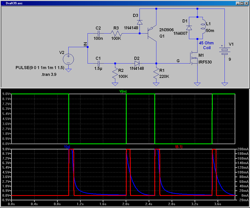

Another way to do it: Drives a low resistance coil directly.

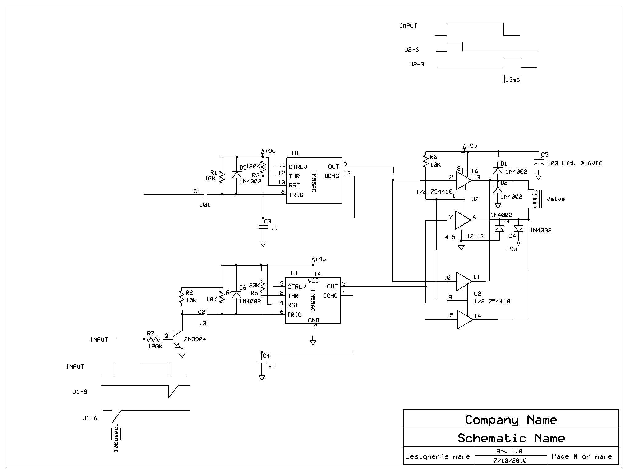

I am planning (unless there's a better way) to drive this using an SN754410 quad half-H.
Right now, I'm trying to figure out the best way to interface the "front" and "back". The front-end signal is either high or low depending on whether an animal is present. But, I need to convert this to two brief (maybe 20 msec) pulses to drive the SN754410 and solenoid. This saves power. The pulses can be fairly crude as to timing and waveform.

I believe I will need to take the "front-end" signal ("FES") and convert it into three signals to drive the H-bridge:
1) An unchanged (carbon copy) of the FES that will go to input 1 of the SN754410
2) An inverted copy of the FES to go to input 2 of the SN754410
3) A signal consisting of brief positive pulses (20 msec) at the rising and falling edges of the FES to go to the "enable" input of the SN754410
I'm wondering how best to do this. Are discrete transistors the way to go? Or am I better off with CMOS 4000-series logic?
BTW, I have paralleled the two full H-bridges on the SN754410 to achieve higher max output current capacity.

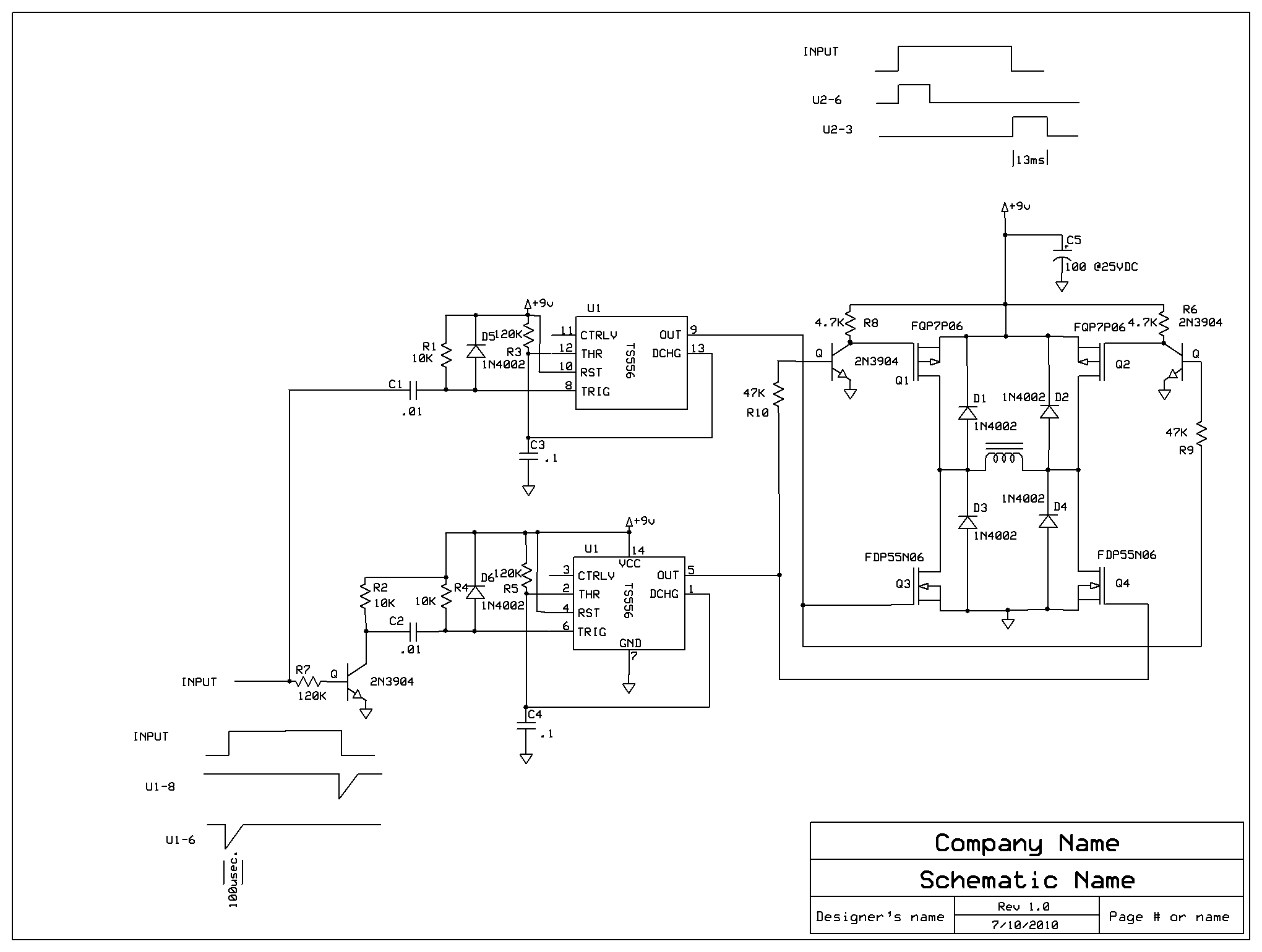

I think the 754410 uses to much power for the battery so here is a desrete design that does't us much power. Just to make sure..... The animal sticks its head in and the water turns on. He (or she) :) backs out and the water turns off??
Yep... you've got it.
