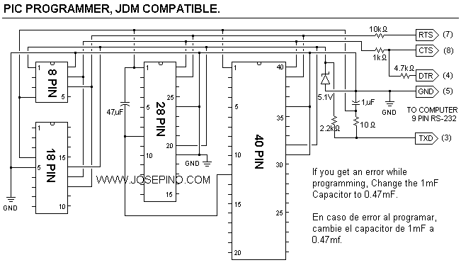

i need a free circuit and software for prgramming all pic ic (maximum) wher can i get it . same as in the atmel ic. is programming with atmel/pic which is easy
here you are
a programmer circuit for 4 kinds of pic
Unfortunately, IC-Prog and many of the other 'free' programs do not program many of the newer PICs...
You may want to consider building an ICD2 clone (info' at STOLZ.DE.BE)... You would need help from someone to initially burn the 'bootloader' code into the 16F876A but after that you simply use MPLAB to program many, many different PICs...
