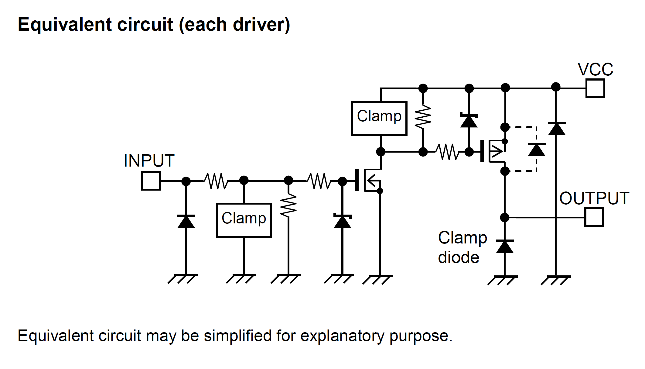

Might try one of these
Toshiba TBD62783.
Toshiba has a few of these type of arrays.

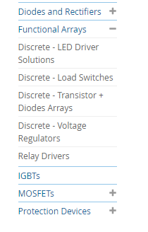

diodesinc.com shows following on their products page -
Regards, Dana.

Tiny.. 16 ~ 25mA... Large scale display.. But I'm bumping it up to 12v from 5v.
Toshiba TBD62783.
Cool... This may do nicely.... DMOS??? Never heard of it til now... Double diffused Mosfet!!! There you go... I learn something again..
AND!! In stock at £1 a piece.... Cheers for that..
