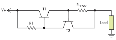

So what we want is a 1mA current source with two probes
The easiest is probably a two transistor current source x such as this,
with a 60V supply.
The current limit is approximately 0.7V/Rsense so Rsense should be about 700Ω.
With a 1mA limit that should be quite safe.

You need a little flyback inverter similar to the one I designed to test zener diodes. It works off a 9v battery.
