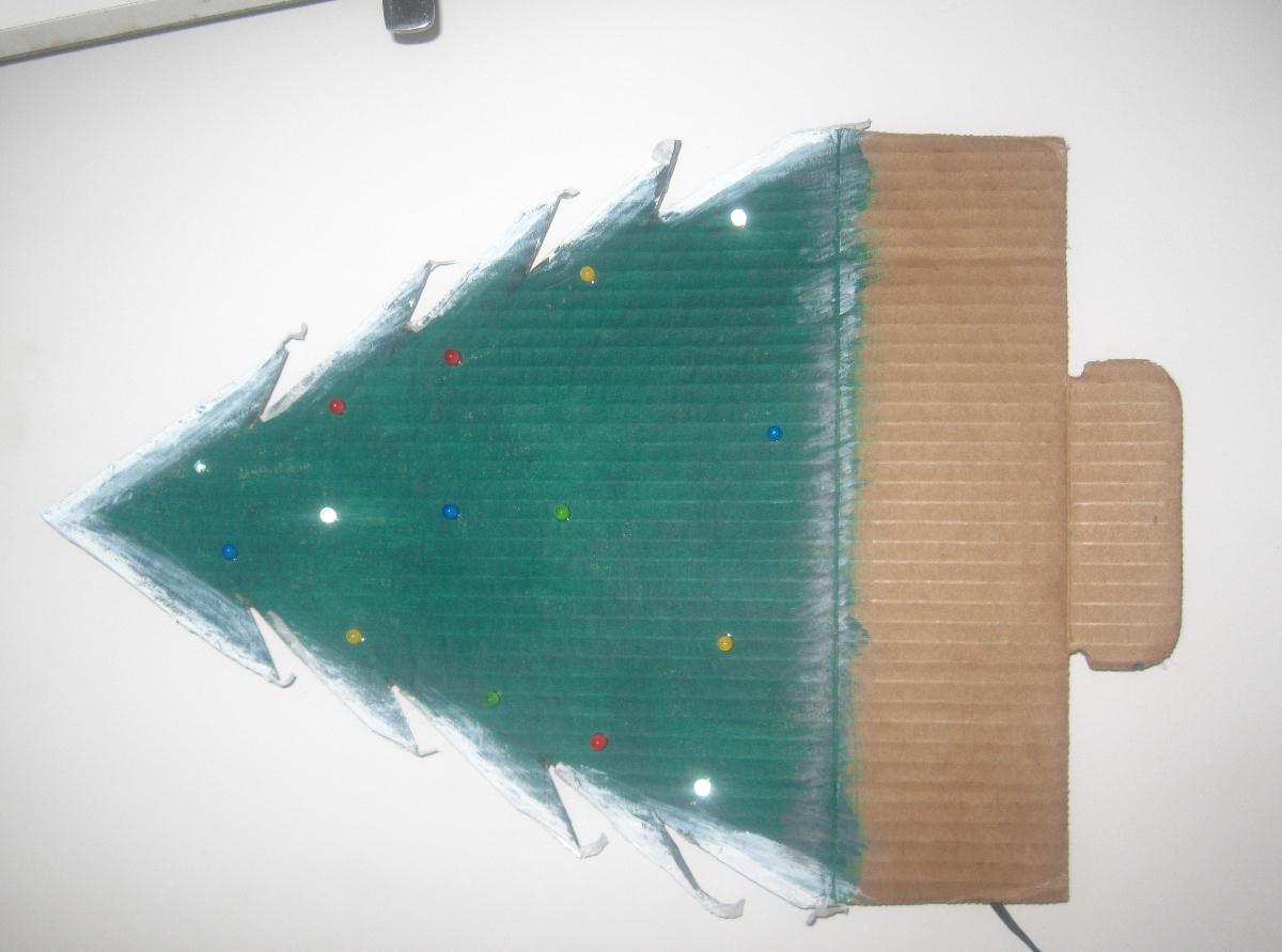

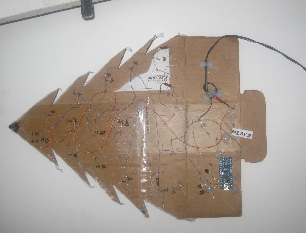

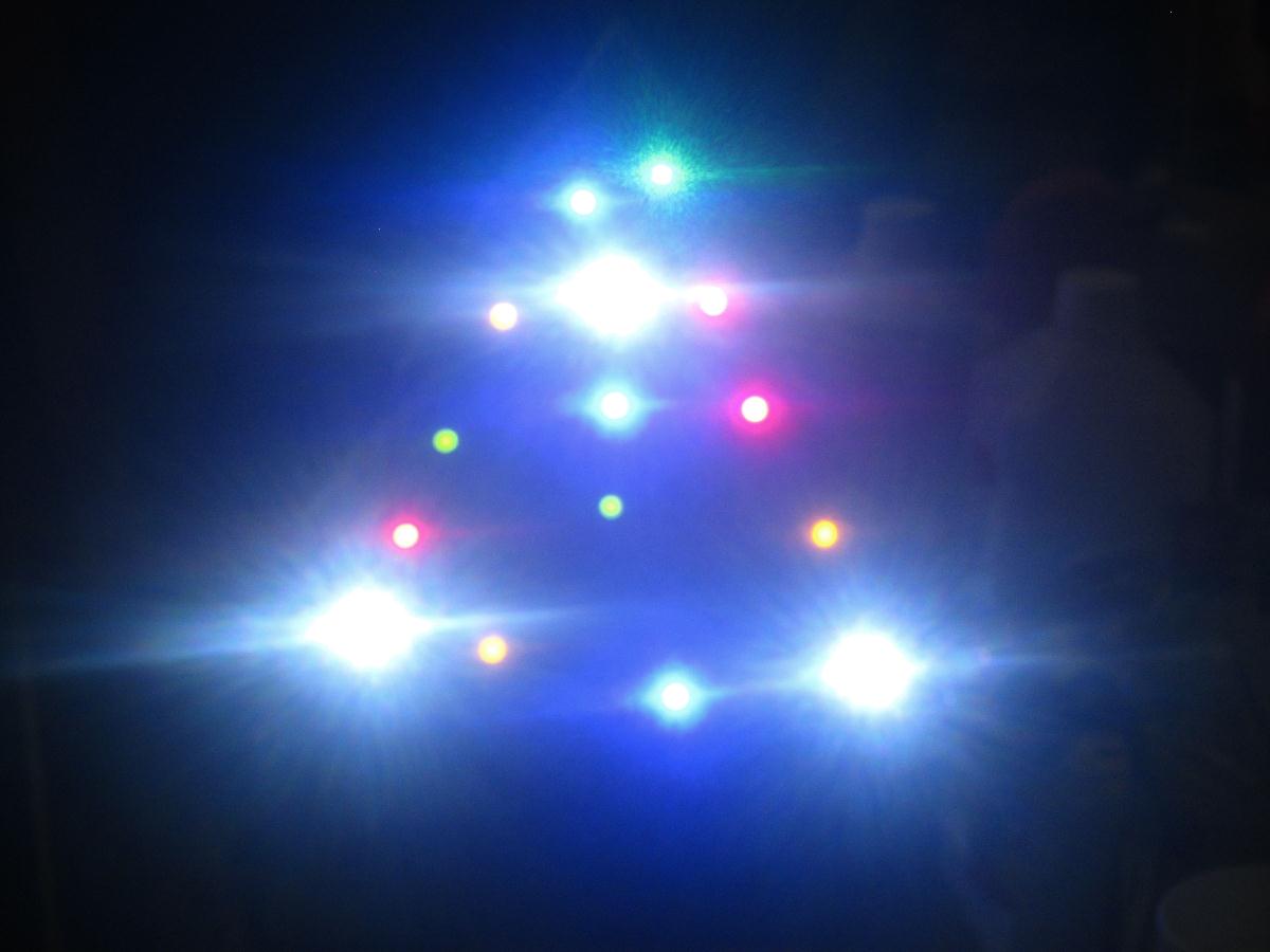

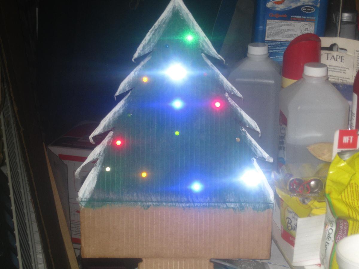

Hi there,
I am getting ready for Christmas and i like decorations, so here's a little project prototype that is very simple to construct.
It's a 2d LED Christmas tree controlled by a Nano micro controller :)
It was fun to build really, and didnt take too much time. It's programmable so you can change the way the lights blink.
Too bad i cant take a video yet, as the lights are too bright. I might try dimming them later to get a video. It's hard to understand how cool it looks as the LEDs blink at random rates and times so it looks pretty nice.
If you make one you can be a little more elaborate too, i just wanted to stay simple so it didnt take too much time. I might make a better looking tree cutout though later some time.

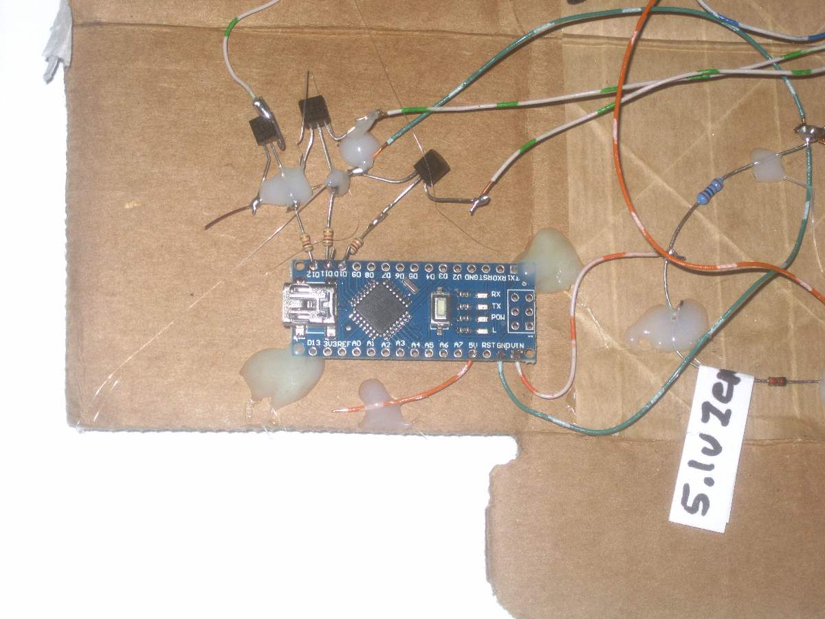

The pics are shown in the attachments, but keep in mind that the brown bottom part folds under to act as a stand for the tree. As the photos show, that is not folded under yet. The Nano and driver transistors are clearly visible from the back but will not be seen from the front. A closeup of the Nano controller is also included.

As Nigel thankfully pointed out, the controller for this was the Arduino Nano. I chose that module because it is self contained and ready to go, and maybe more important, it's SMALL. It's only about three quarters of an inch wide by maybe 3 inches long, so it fits right on the tree in the bottom section without getting in the way at all. The board i used did not have headers on it either, like many of them do. I got it that way so i could hard wire it up to whatever i was going to use it for and that would make the electrical end of it more stable. The Nano also took only about 15 minutes to program with the random blink code using the Arduino IDE software set.
You might also note that this is probably the simplest tree you can make. Some other ideas you might like are:
1. You can go 3d, making the tree have depth as well as width and height, so you can have LEDs visible from the sides as well as the front.
2. You can go super 3d, where you make the entire tree out of LEDs running up all sides.
3. You can go super duper 3d with girth, where you actually fill the entire 3d cone space with RGB LED's, where each one is individually controlled. That would be the ultimate Christmas tree i think. The LEDs can then be illuminated not only at the surface of the tree, but actually inside the tree body also. The lighting/blinking pattern could be quite awesome to watch. Of course it would be much harder to build and you'd need several communicating controllers so you would have enough i/o pins to drive each LED RGB pins separately. They also make serial programmable RGB LEDs now too though, if you wanted to try those instead.

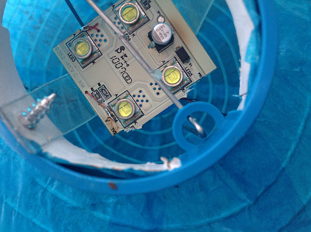

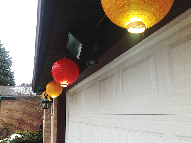

$1 Chinese lanterns and just 4 LEDs, nothing else used in 12.0V parallel string. (salvaged from 16 LED Ambulence LEDs scrapped, found at scrap metal yard for the alum. substrate. hundreds of boards for $20) Clear sprayed to protect from weather.
AWG 30 magnet wire to 18AWG speaker wire to small 12.0V SMPS.

Looks like a lot of LED's...do you have a parts count?
Where did you get the Chinese Lanterns?
That adds an interesting touch too.
