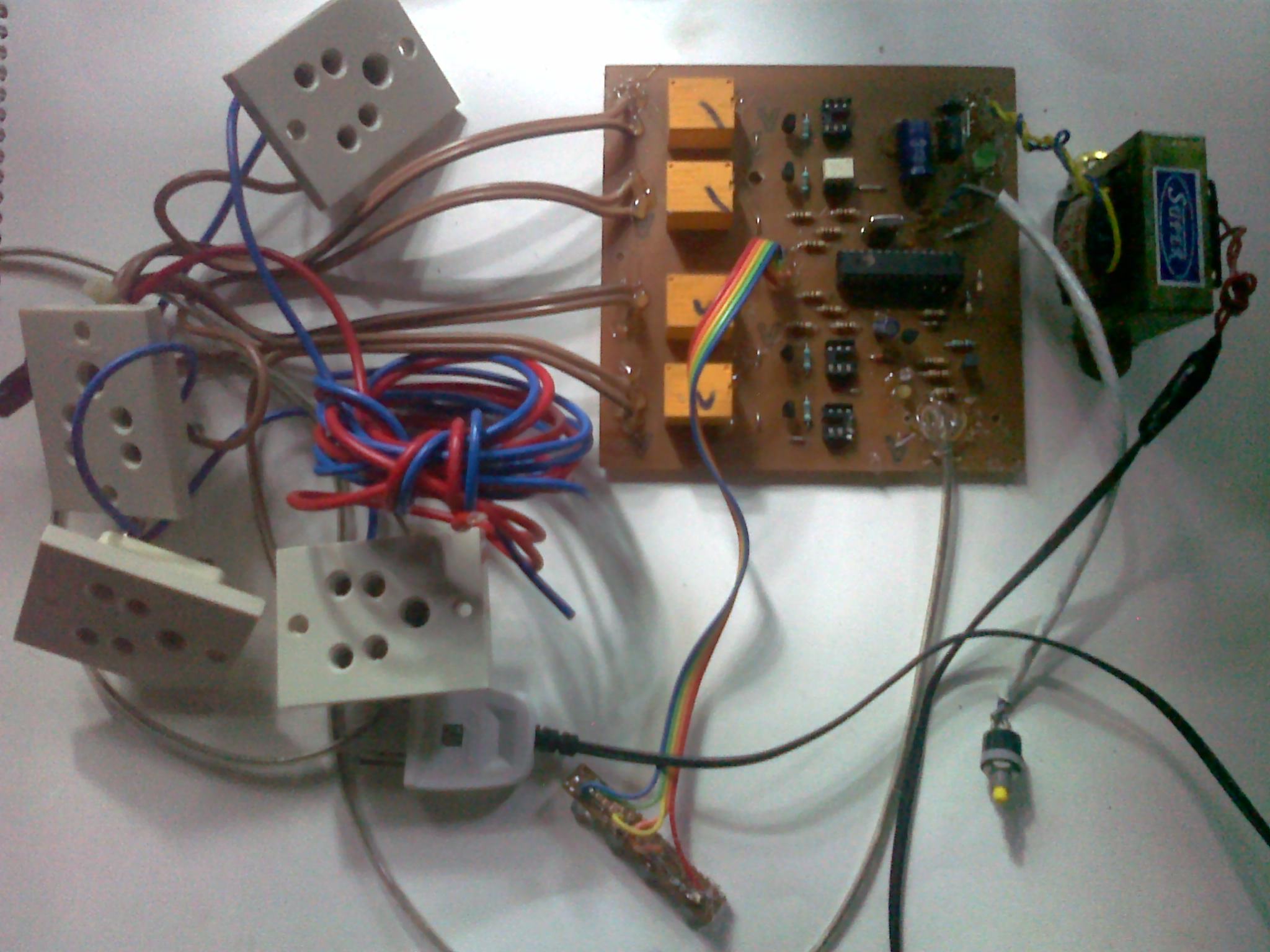

it works off a PC, really what i got to do was to just say the device and it will come on/off accordingly..
planned to share but the code is too complex to post.. it's based on adaptive algorithm. i'll try
uc is basically an atmega 8 programmed by using an arduino.
uc program: it's actually quite simple

No pressure, just curious about the intent of your post. I figured you'd have more pictures or details to share about your project, maybe you hadn't gotten around to posting them yet.
yeah, i'll post the video of it working after a day

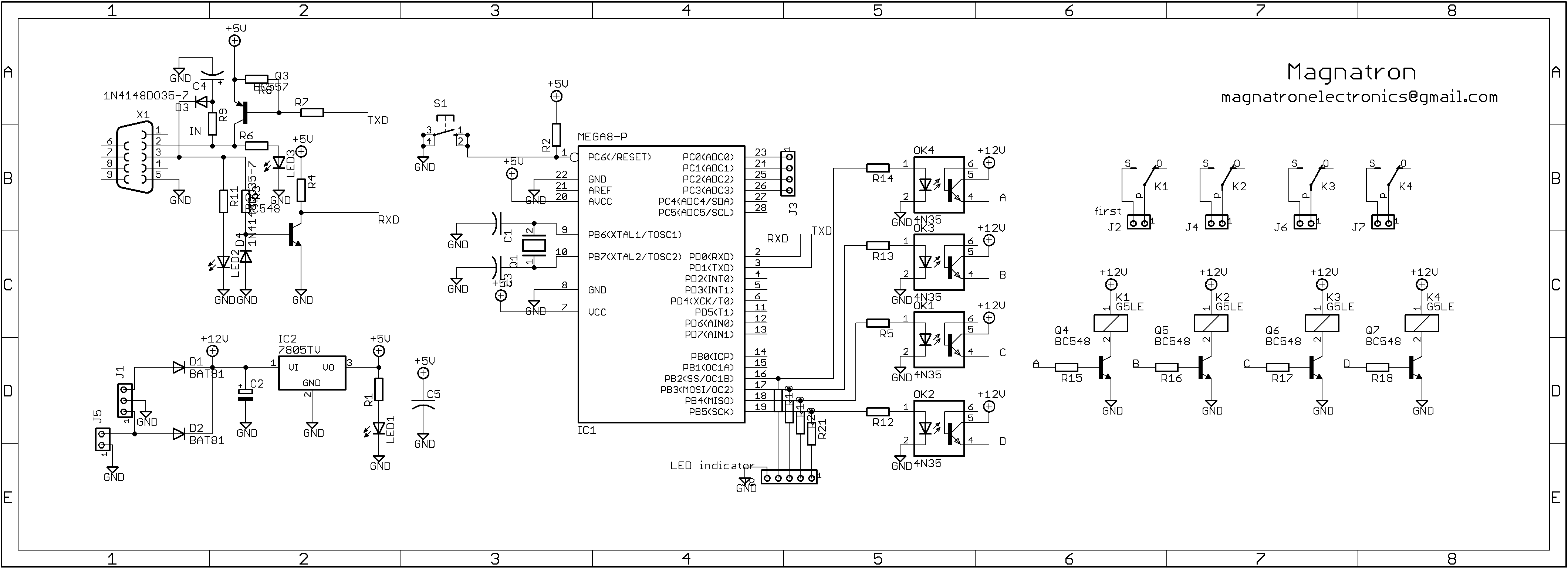

schematic
the schematic of serial controller

there's a serial link to the PC (central server) it has got an array of microphones in each room. according to where the user is present, the mic is turned ON/OFF. the processing is done in PC. the resultant vector will be 11,10,20,21 so on.. 11= turn 1st appliance ON, 10 OFF and so on..
So how do you overcome the problem of it reacting to words being used in common conversation?
it has got a key word for starting command acquisition.
