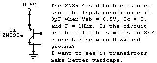

I was wondering if the transistor schematic below would also qualify for a varicap, just because transistors can output some capacitance, just because they are two diodes with anodes or cathodes tied together.
and because 1/2 the manufacturers do NOT provide a chart displaying the capacitance of a diode, is there a formula I can use to calculate capacitance based on voltage?
I would think it would involve using log, ln, sin or cos, because capacitance isn't linear when dealing with diodes.

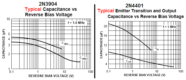

Look again (and again and again). The datasheet for a 2N3904 doesn't say it has 8pF. That's its max and only a few in 100 of them will be max. The curves show that its typical capacitance is only 4pF. Some might be only 2pF.
Its typical tuning ratio is next to nothing: 2.8pF at 5V, 4pF at 0.5V.
Its emitter-base is a low voltage zener diode whose leakage current at 5V will messup your DAC.

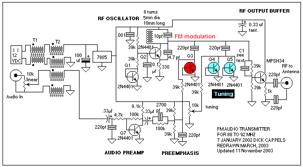

You nave millions of other transistors to look at but the 2N4401 that is paralleled in the circuit I posted looks to be much better. Notice that the circuit uses its low-leakage-current collector-base junction as its varactor diodes, and it tunes only a small part of the FM band.
2N3904 to 2N4401 comparison:

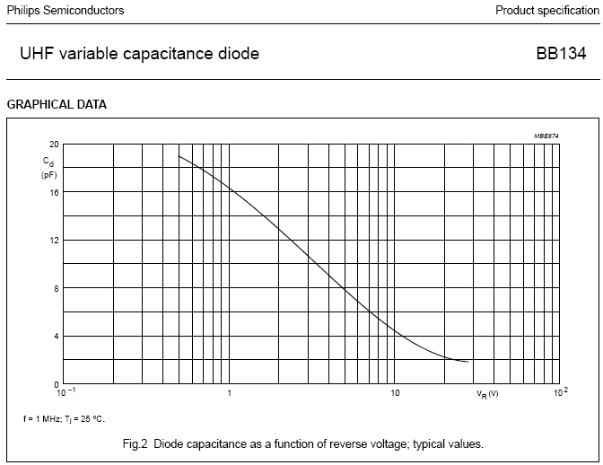

Look at the capacitance ratio on a real varactor diode.
This BB134 has a low capacitance for UHF. The BB132 and BB133 have double the capacitance for VHF tuning.

The perfect varactor for me is one that can produce an output capacitance of 0 to 10 pF based on an input voltage from 0 to 9.
That's not nearly enough capacitance.
Add about 10pF of stray capacitance and then the range becomes only from 10pF to 20pF. It won't tune the entire FM band.

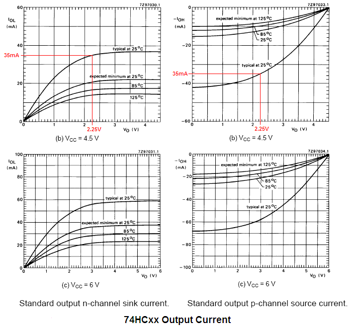

Cmos ICs have a higher output resistance at lower supply voltages. Using a 5V regulator at its minimum of 4.5V, a typical 74HCxx output can provide 35mA at 2.25V which calculates to be a 64 ohm resistor. Its minimum current is 12mA so its max resistance is 188 ohms.
All the 74HC4017 ICs I've used in my 6V Ultra-bright Chaser project measure typical or better, that's why they're so darn bright!
If you use 10k resistors as the minimum value in your resistor ladder at the outputs of the counter then the circuit's max error would be only 188/10k= 1.88%. If you use 100k resistors then the error is 0.2%.
If you operate the counter with a 6V supply (its absolute max is 7V) then the error is halved.

does your error level stated above determine the chances of a short circuit?
Of course not! A 74HCxx IC on a 5V or 6V supply can provide much more than its absolute max continuous output current rating of only 25mA to a short and will go "poof". It can momentarily provide an output current of 60mA to quickly charge stray capacitance for its high speed. An ordinary CD4xxx Cmos IC can provide an output current of only a couple of mA to a short with a 5V or 6V supply.

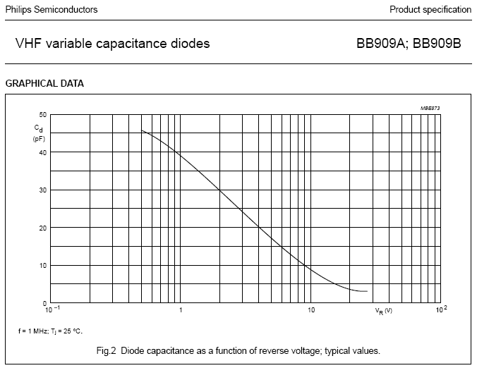

Here is another good "real" varactor diode:

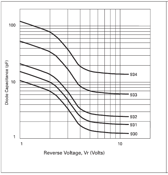

And here are Zetex's hyperabrupt varactors. They have wider tuning range, but they also have fairly high temperature coefficients. This is not a problem if you are using them in a VCO that is within a PLL, but it might be when run open-loop, as mstecha is doing.
There are other mfr's of hyperabrupt varactors.
