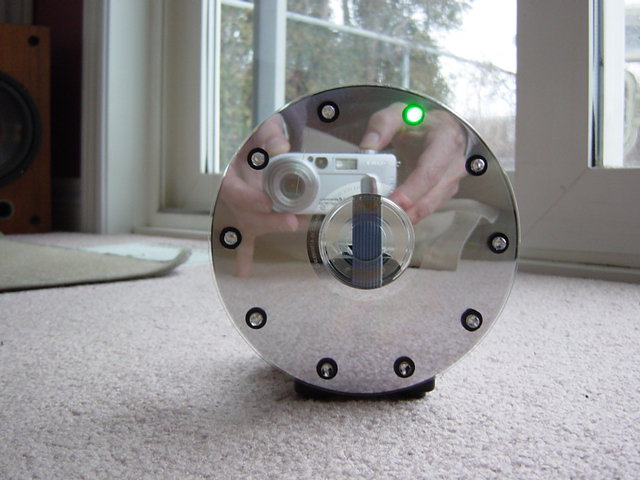

audioguru, do you have a picture or video of your led chaser? I just put one together...here is mine
Your chaser has more LEDs than mine and does nice patterns. But it has a mains power supply.
Mine blink each LED brightly for a very short duration and have a pause after chasing around a few times. Then the AA cells battery lasts for months.
I used old CD ROMs from America On Line (dial-up internet) programs.
I made about 20 of those chasers. I gave some away, sold some and kept 7.

I love LEDs, they are so amusing! :D Can I ask what IC you used? I would have used a 4017 with a 555. I have a circuit that I accidentally created that uses multiple 4017's to run even more LEDs. the circuit can run any number of LEDs as long as the number is a multiple of 2 or 5. when I finish the schematic I'll post it (I'm only using 50 LEDs as an example:p).
What's the secret in keeping the system as efficient as the one you're having?
I use a 74HC4017 that draws almost no operating current and has plenty of output current. It works with a supply voltage down to 1.4V (the datasheet guarantees 2V).
Ordinary 4017 circuits always have one LED turned on but mine blink for only 25ms for each LED then after chasing around a few time they pause for two seconds before chasing again. I use a 74HC14 Schmitt trigger inverter IC for the 3V ones and a 74C14 for the 6V ones for the oscillator and monostables.

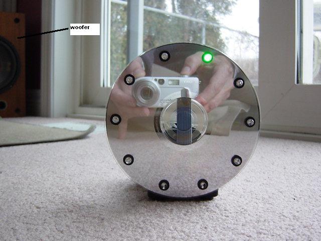

Just noted that speaker in the corner..:D
I think it's everywhere in AG's house **broken link removed**
I have 5 speakers in my living room, 4 speakers in my family room and 4 speakers in my computer room. The rooms are not connected together.
