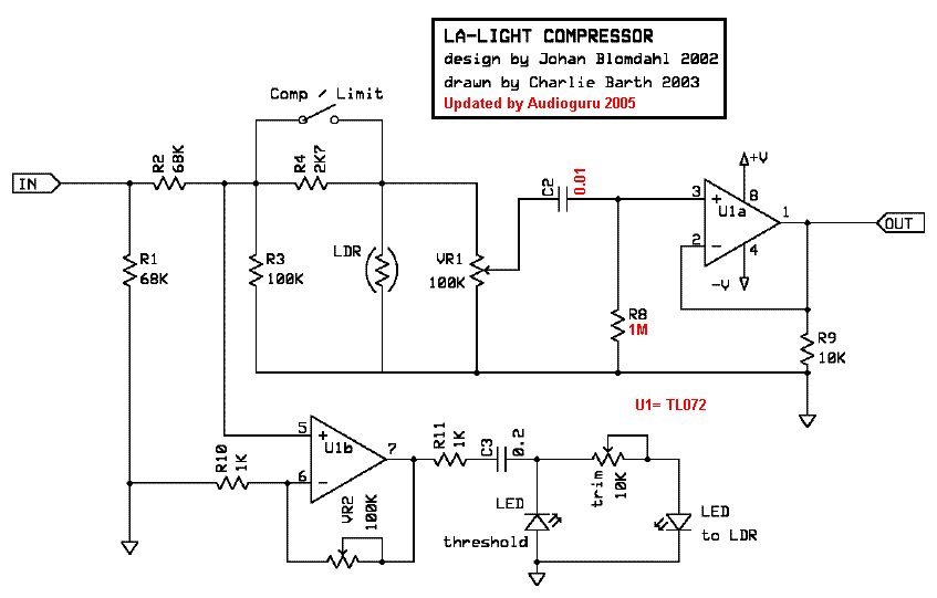

Better late than never :lol:. I was searching for "optical compressor" because I remember Audioguru made some alterations to the circuit, simplifying it, but this is the only post my search returned. Anyhow, I found some free webspace, but have absolutely no idea how to make a page. Nonetheless, the mp3 should work, as should the picture:
If Audioguru still has the compressor diagram, I would be really grateful if he could post it/send it, I want to resvisit it with a 10000mcd LED :lol:

Hi Dr. EM,
Maybe you want this compressor circuit:

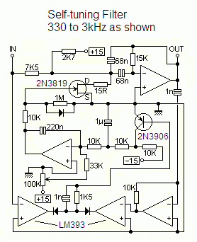

Here's another neat circuit to try. Its output is supposed to follow an input frequency:
Thats it, cheers :D

Audioguru, I tried the modified compressor with little success. It was impossible to get rid of the distortion that occured, and there was quite a buzzing (low output level). It also started boosting the high frequencies as I adjusted that 100k level pot. That said, I added in the FETs to convert it back to the original (and changed that 1M to 33k etc) and am still getting similar results. It has worked in the past, with the 1458, very well too, apart from the noise. I'll look over it in more detail, try changing the op-amp etc.
I see what you mean. The LED rectifies the input and isn't filtered so modulates the LDR with severe half-wave distortion. The circuit needs a rectifier and filter stage followed by an LED driver.
The LDR is probably picking-up mains flicker from lightbulbs.
The pot and output opamp have a frequency response down -3dB at about 16Hz and a flat response from 80Hz to about 8kHz with old opamps.
With a TL072 opamp its response will be flat up to 100kHz at full output and flat up to 3MHz at lower levels. I don't know what is boosting your highs.
