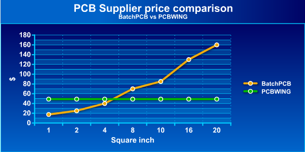

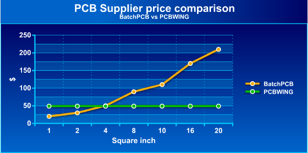

I have been discussing a simple comparison.
When 1 pcs of PCB
1pcs-png.43960

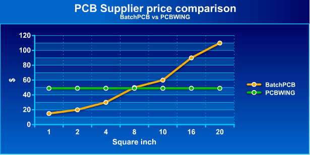

When 4 pcs of PCBs
4pcs-png.43963

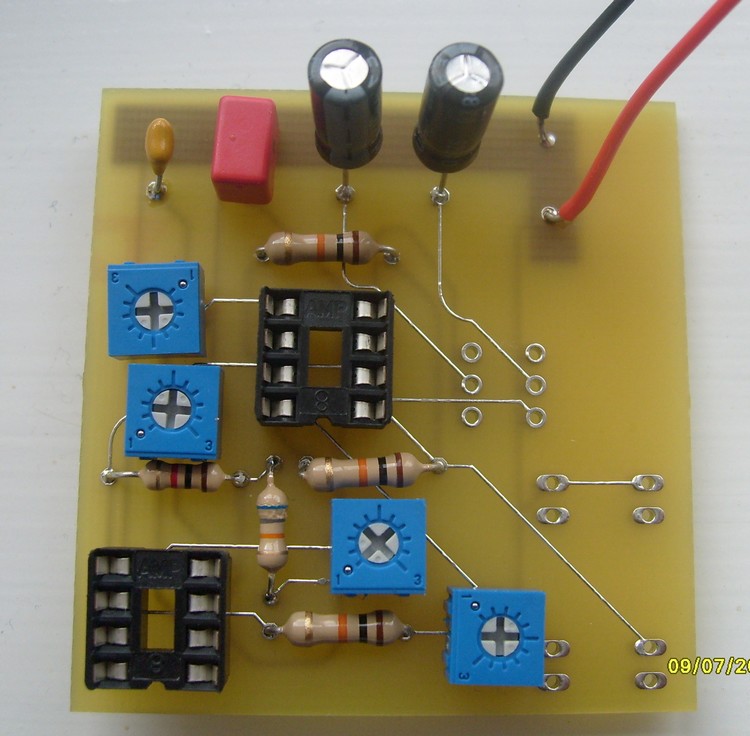

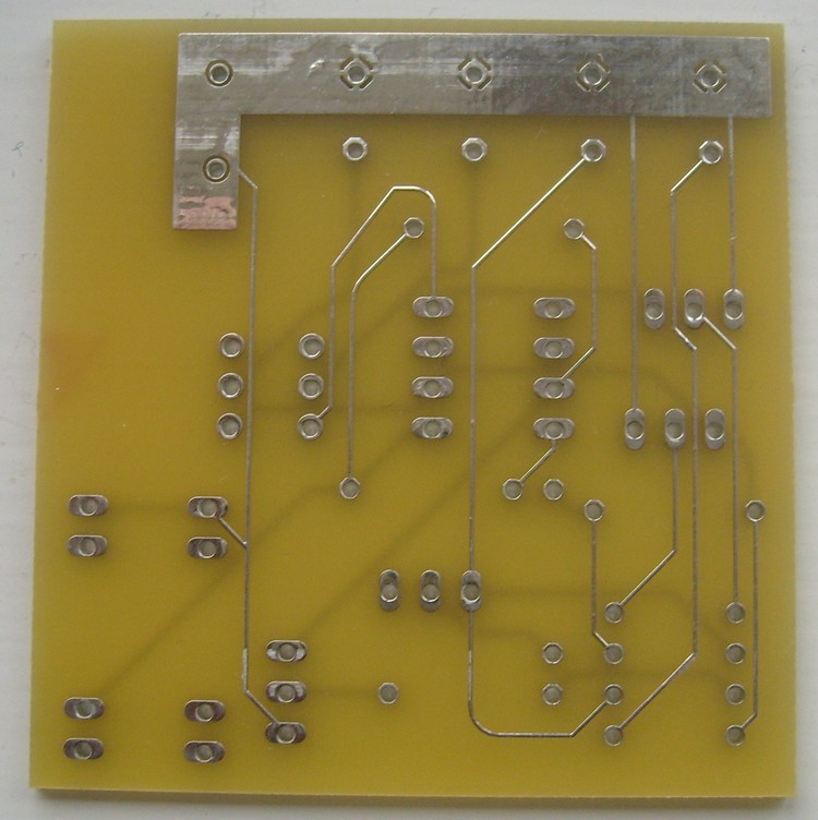

The boards came back and I'm pleased. The quality of the board looks good and i think they have been manufactured well. One of the IC's has pads which aren't that small on my computer and the traces look a bit squashed in one or two places, but nothing to quibble about. I ended up getting 4 of them with an area of 1dm (3 inches square) for £48 ($70) which includes tax and delivery, so the price is reasonable. They shipped a day late, it was sent first class, had to be signed for and came in a very sturdy box.
The major problems I know about revolve around the transformer. I made the board up on stripboard and didn't test it with the load. I realised this after I'd ordered, so essentially I was thinking i'd get 10Vpp into the transformer primary and it'll be closer to 6Vpp. As I need 10Vpp I will have to see if I can get another transformer with lower primary impedance. The other problem is that the transformer doesn't fit on the board, so it will have to stay off for testing. I have almost finished making up the board and so I don't know if it will work or not. I haven't put the momentary switch on, that needs the batteries going through it and I haven't quite figured out the best way of going about that.
General thoughts are, the traces are wide enough but they could have been much bigger, the board could have been smaller, I put 2 vias into the ground plane which seem not to have been connected to it like i'd have prefered. I should round off traces more.
Feel free to comment and thanks for the input.

Antknee,
You have no silkscreen and no soldermask, I guess it does the job for a prototype.

Hi lilimike,
That is an excellent price, I looked at the website and it is american so I assumed I'd be paying shipping of $20-30 to get the board to the UK, I could be wrong and will investigate further. I will add silkscreen and soldermask to the final build, I printed off a copy of the board from Eagle and used that to place parts.

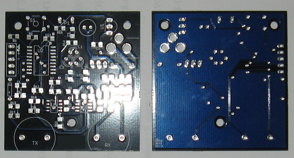

I got by board back from DorkbotPDX and I am really pleased with it so I just found my future resource for prototypes.
I got 3 copies of this board, it's around 4.5² In delivered in a little more than a week for under $23.
I just wish my camera was as good quality as yours because the board looks much better in person!
Mike
That board does look good! I saw it and it reminded me of constellations in the night sky, what is it? That is a good price, I checked the website a few days ago and they don't ordinarily ship to the UK, I'd have to ask and get the shipping price. I sent another order to PCB-Pool last night, my board is around the same size as yours and I'll get 3 copies for around $75 including everything.
