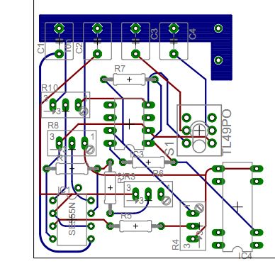

My first Eagle schematic and board
I would be curious to know what you are using for IC2, I don't have too much experience but all of the dual op-amps I have used where the inputs were on pins 2 and 3 had the output on pin 1 and also, unused inputs had to be tied to negative supply.

You're ahead of me. I had the wrong pins on IC2. Edeca made me think about it and when I checked I thought omg I nearly chucked £30 down the pan. The intention was to get it made and see what the mistakes were but that would have been something that couldn't be debugged. I've had a look around to see if I could find a library containing the chip (TCA0372) but I can't find it, so I'm currently reworking with just the package - DIL8 - rather than the chip itself.
That was a good spot! Thanks for the input.

I am not criticizing here but rather providing pointers that will simplify and the routing and make the board easier to use.
R4 looks to be a variable resistor. I would rotate it so the adjusting screw faced the edge of the board. If you run the trace going to pin 1 under R5 you can do it without running traces between the pins.
I am thinking the routing for IC1 is more complex then it would need to be
In some cases you can use resistors to bridge traces.
For example if you move R8 directly below and in line with R9 you can eliminate the need to run the trace between IC1 pins 7 and 8.
IC1 pin 6 (and 3). You have a right angle bend just prior to the pad. This is bad because it reduces the clearance between it and pad 5.
I would try rotating IC1 90 or 270 degrees to see if it could be routed easier.
I fixed the pins on IC3 and will be very careful to use the right chip/package in future. I rounded off the 90 degree junctions. I added two pots to adjust the voltage across the 555. This meant no matter how I tried I could no longer get everything onto one layer so I had to use two. I tried making the circuit smarter by putting components around the 555 and rotating to help the routing. I might have a go at making my own components for the next build.

I have fixed the T pieces. The via near IC1 is a mistake I hadn't noticed, I was putting vias in the ground plane for my dual supply and must have clicked by accident.

I do not know if you are having this board made or etching it yourself. If you are going to have it made ignore this post.
If you etch it yourself you will not be able to solder under chips (top layer) if you use any sockets other then machine tool. The same it true for parts like the variable resistors and possibly the caps.

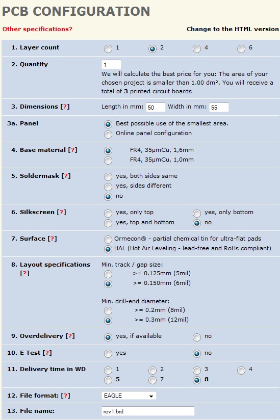

I'm going to use this company:
They were recommended to me a while back and it is around £30/$50 for 1dm/3inches. I should get 3 boards. I thought about etching it myself but it would cost me around that much in kit and there would be the limitations you've noted. I'm tempted but it is a challenge for another time. Thanks. Antknee.
I'm going to order the board, there are a few terms that I'm not familiar such as soldermask, silkscreen and HAL. What do these mean? I have defaulted to answering no. It will be £38 ($55) + delivery.

Don't miss the little question mark, which explains these terms.
A silkscreen is the (usually) white printing on a board which indicates where components go. It can be quite useful for production boards, but you could live without it for a prototype.
The soldermask is a layer applied to the whole board to make soldering easier. It covers all metal except for the pads and other parts which will need soldering. This makes surface mount parts a breeze (even in a frying pan) and also helps through-hole soldering too. But like the silkscreen you can probably live without it for a prototype board that only uses through-hole.
It has been ordered, delivery was a bit more than I'd expected £7 ($11), I will watch out for that in future. The silkscreen info link was blank and the explanation of soldermask a lot less intuitive than yours :)

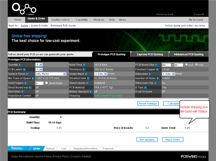

welcome to try for the next time from us. Just make a comparison to see which one is more suitable.

10in² less is profitable.
yes that is for sure, I was referring to a small prototype in a quantity of no more than 3.
Actually I was wondering how these people can manage to get this cheap to put together a bunch of PCBs and send them to a Fab house like yours!
Why can't a Fab house do the same directly?
By the way you have good prices, when I get into quantities you will see me drop by.
