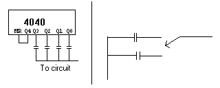

When I tested the radio with the push-button station changer (I also made myself) on a breadboard, everything works perfectly. HOWEVER, as soon as I turn the station-changing component into a PCB circuit, it doesn't work.
My station changer is basically a 4040 CMOS counter that uses 5 bits. The 1st bit gives output to 0.3pF capacitor (4 1.2pF's in series), the 2nd gives output to 0.6pF, and so on and so fourth. Bits 4 and 5 have outputs whose capacitors are wired in parallel. This circuit will give me a range of capacitance from about 0.3pF to about 9.3pF, enough for me to change stations.
All the connections are the same whether the circuit was on PCB or not, except that on the PCB, there were three wires (ground, +ve, and output to tank) about 1-2 cm long, and 1 (reset pin) about 5 cm long.
I would figure these wires shouldn't make much effect on the circuit with the exception of maybe 5Mhz down in frequency.
When I tested the PCB, the counter seems to work perfectly, and the resistors I used on the PCB are 27K resistors.
On the PCB, the circuit acts as if it was the antenna connected 2mm away from the +ve wire, but on the breadboard, it did not act this way.
Why doesn't it work now on the PCB?

Below is an explanation of your tuning ckt as I understand your description of it.
The CD4040, in my opinion, won't really switch your tuning capacitor in and out of the circuit. It might change the inductance you have in series, which will probably be a lot different between the breadboard and the PC board, as Evandude pointed out.
Edit:
I reread your post. If you made the PCB look just like the BB, then parasitics may not be that much different. My comments about the effectiveness of the 4040 as an RF switch still stand. Note that the output is never high impedance.

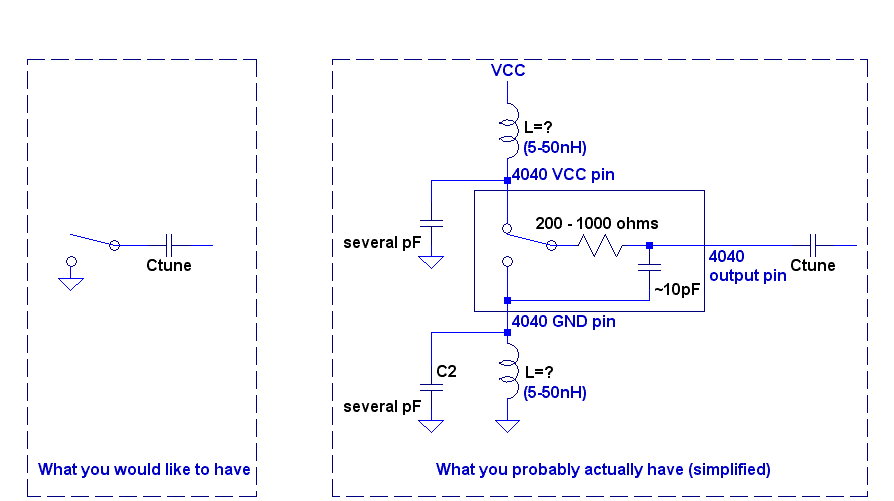

The left picture is the basic idea of my circuit. The right-most capacitor is the lowest (0.3pF), and each capacitor to the left of it is doubled (0.6, 1.2, 2.4, and so on).
The right picture shows what I would like to happen. Basically on the right, it would have been a rotary switch style circuit, but I don't like the rotary switch idea.

The outputs of a 4040 aren't a switch. They connect your capacitors all together. They are together because the outputs of a 4040 are either at the positive supply or at ground. The supply bypass capacitor in your circuit makes certain that the positive supply and ground are the same at RF.
Also, the outputs of the 4040 have an internal and wiring capacitance to ground of about 10pF on a pcb. Another reason why your little caps are all connected together.

You don't understand that the outputs of the 4040 don't switch the capacitors in and out of the circuit. The capacitors are always switched into the circuit with the logic voltage changing at the 4040 end of each capacitor.
