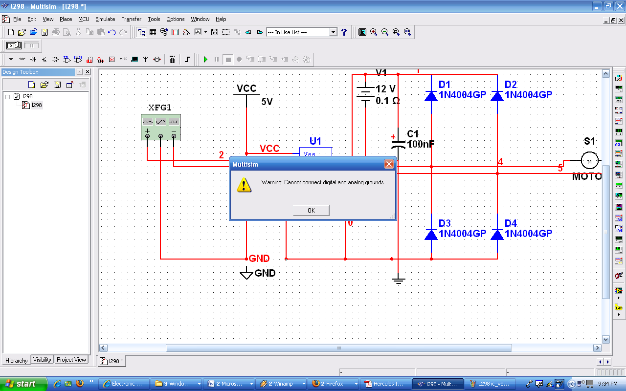

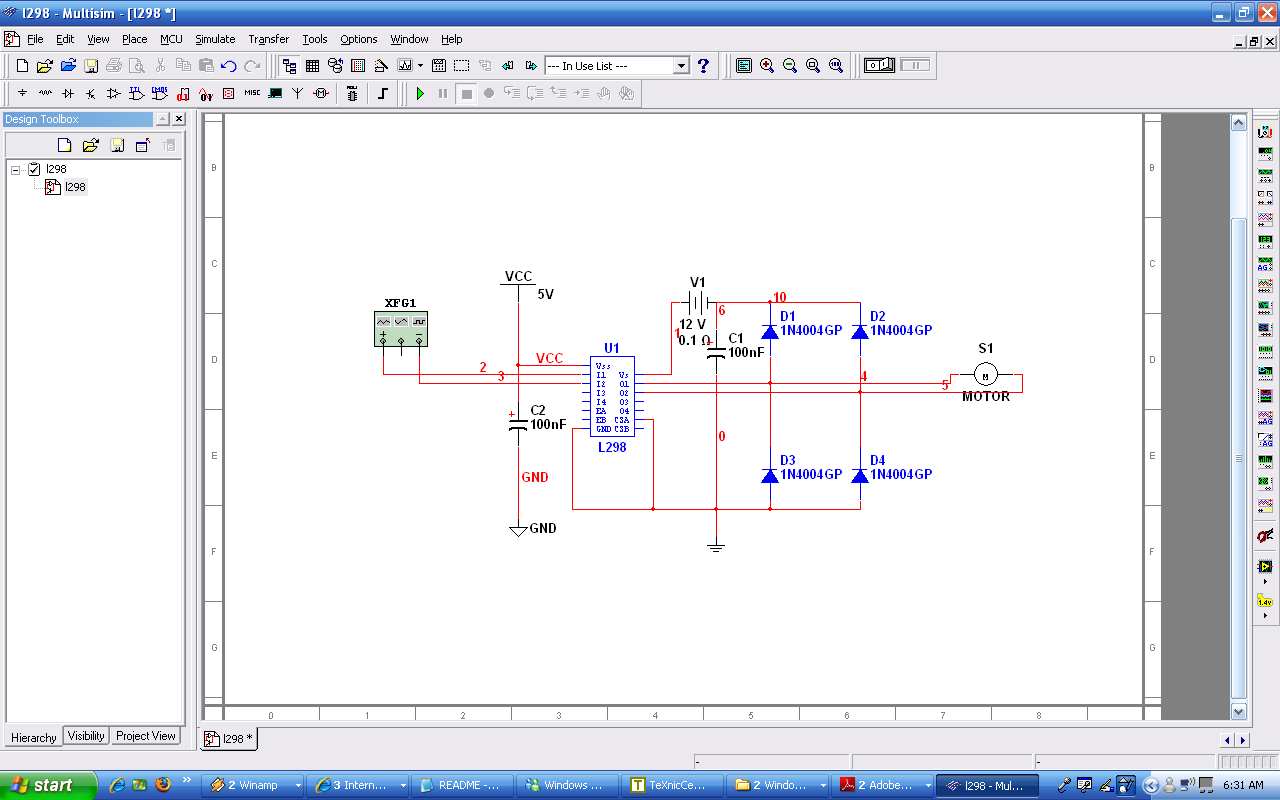

this is the schamtic with no dots...so can anyone give me a hand tell me what is the error on this circuit..this is because i am new to schematic diagram..

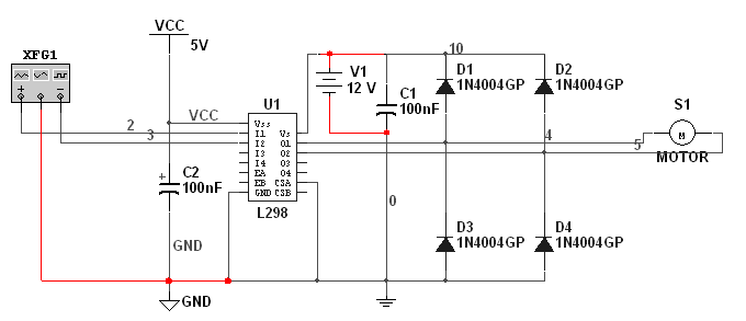

In addition to the input not having a ground reference, the 12V battery was not connected properly.
Try this:

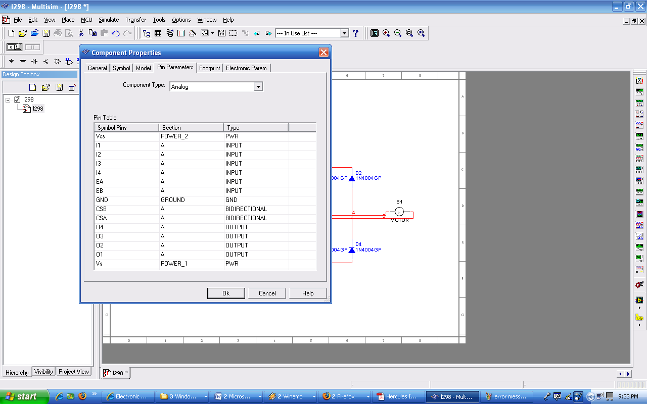

i follow what you said, however is still the same result. The problem i scared is that the component that i create my own got mistake on it...i meant the L298IC..this is because i cannot find the library.
And another problem is that when i connect the ground, it pop up warning saying cannot connect the digital ground and the analog ground.
i already attach the image below

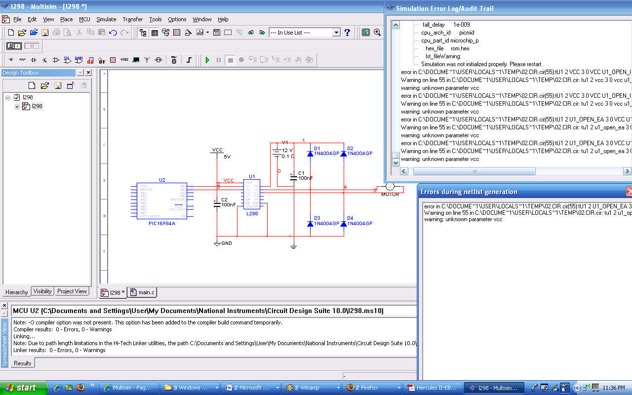

Get rid of the analog signal generator and use digital logic inputs to the L298.
i still face the same problem after i changed to digital input.what should i do?

I have used Multisim before. You don't need a ground to the function generator as long as there is a ground in the schematic. This is the same for the oscilloscope.
You can't use + and - of the function generator to test this schematic and it is also not needed.
Just connect one of the input to Vcc and you will see the motor turnning in one direction. Remove the Vcc from the input and connect to another input, you will see the motor running in another direction. Remember to connect the enable pin to Vcc.

still got error on it..it say wat u1_open_o3
by the way, if the component is not found in the library of multisim, can i simulate that chip?

What is u1? Can you show your current schematic? I have no idea if there is no the chip you want.

the chip is L298...i cannot find the lib file which i can fit into multisim
