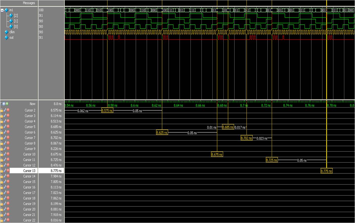

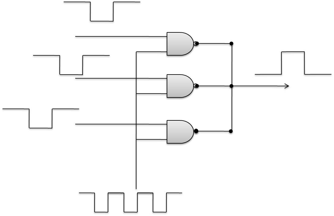

This Idea May Help you
The Above logic is a simple idea, But you can use this...!
But if you want to know the interrupt from which line then it will not help you.. For entire Interrupt if you have same ISR, then you can ........!
If you need more write in...
