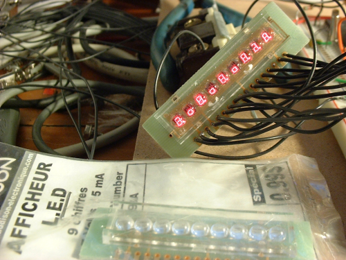

PS: where did you get this little 99 cent 9-digit display?
It comes from a local electronics surplus store called Addison Electronics (**broken link removed**). Their website is as crappy as their customer service and all around "customer experience". But the prices on the surplus stuff are well worth the visit! And at 99 cents, this is a very nice development LED display!
See the attached picture. It looks like it's from the 70's or 80's. It has a strange déjà vu kinda look. I was born in 1978, maybe there were appliances with that kind of display around the house!...
N.B. Yes, there is a broken segment. It died during a soldering accident. Luckily, it's the only digit that died. The first digit (same segment) did suffer a little though, you can tell by the picture it is a bit dimmer...

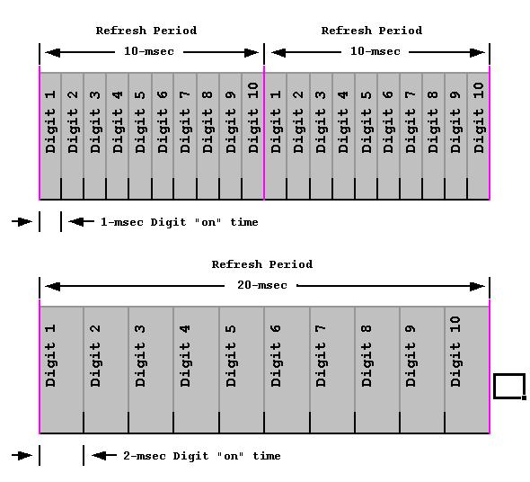

10 Digits, 10% Duty Cycle, Refresh Rate = 100-Hz
Each digit is turned on for 1-msec... It takes 10-msecs to complete a cycle... There are 100 cycles in a second (1-sec/0.01-sec)... Each digit is turned on a total of (100 cycles/sec * 1-msec) 100-msecs / second...
10 Digits, 10% Duty Cycle, Refresh Rate = 50-Hz
Each digit is turned on for 2-msecs... It takes 20-msecs to complete a cycle... There are 50 cycles in a second (1-sec/0.02-sec)... Each digit is turned on a totla of (50 cycles/sec * 2-msec) 100-msecs / second...
I hope that makes sense? Different Refresh Rates but the same amount of "on time" per digit per second... Refresh Rate does not affect the total amount of "on time" per second... Duty Cycle does... Please try the math to confirm this for yourself...

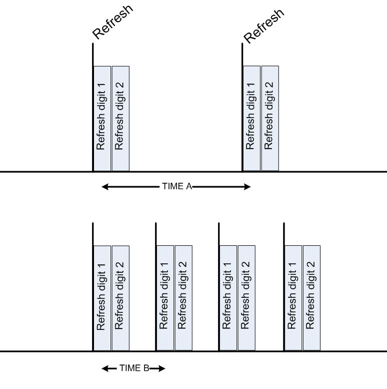

Hello again.
Well i agree with the calculations of both posts. What it seems strange to me is this
so digit 1 gets 1A for 0.5 seconds then digit 2 gets 1A for 0.5 seconds
Why should each digit get 0.5seconds??? All it needs is some miliseconds right?
I made a figure to show you how i think of it
At the top figure you can see that digit 1 is updated every TIME A.
(1) TO MIKE: Even if more digits are added ,digit 1 will STILL be updated every TIME A. So why adding more digits will make it less brighter???
(2) If the refresh rate is increased (bottom picture) Digit 1 is updated every TIME B which is much less than TIME A that was before, meaning it would be brighter since current passes much more frequently.
Thank you very much.

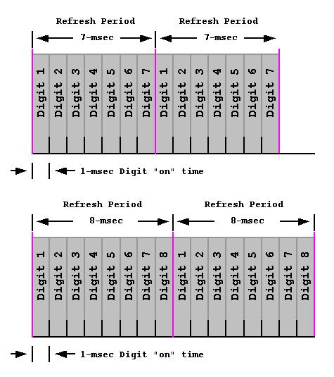

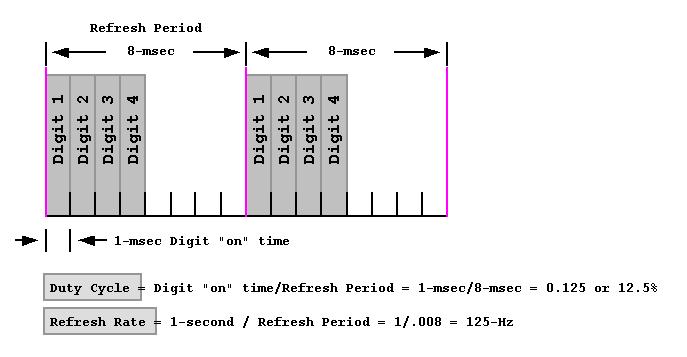

I'm afraid your drawings (and conclusions) are somewhat meaningless if you don't include the important parameters and work through the math...
I apologize for not being able to explain this concept better...
I've tried to make the drawing below similar to your Example A... In this case, yes, you could add a Digit 5 right behind Digit 4 and the display would have the same brightness... But that's because you left holes for extra digits within each Refresh Period... If you work through the math you'll see that Digit 1 still has the same Duty Cycle because you did not change the Digit "on" time or the Refresh Period...
Regards, Mike
Here's an example where adding a digit would change the Duty Cycle and Refresh Rate...
Again, I apologize for not being able to explain this better...
Regards, Mike

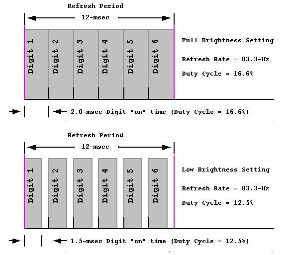

I know I promised "no more drawings" but I have one more I'd like to share with the Forum, if anyone is interested...
This drawing shows how you could increase or decrease display brightness by changing the duty cycle (while keeping the same Refresh Rate)... This could be used perhaps to dim a Clock display during night time when all the lights are off... Basically you change the amount of "on" time for each digit to effect a change in duty cycle (and brightness)... You could even change settings in smaller increments over a larger range, say 10% to 16.6% Duty Cycle, for a wider ranging brightness control...
Best regards, Mike
