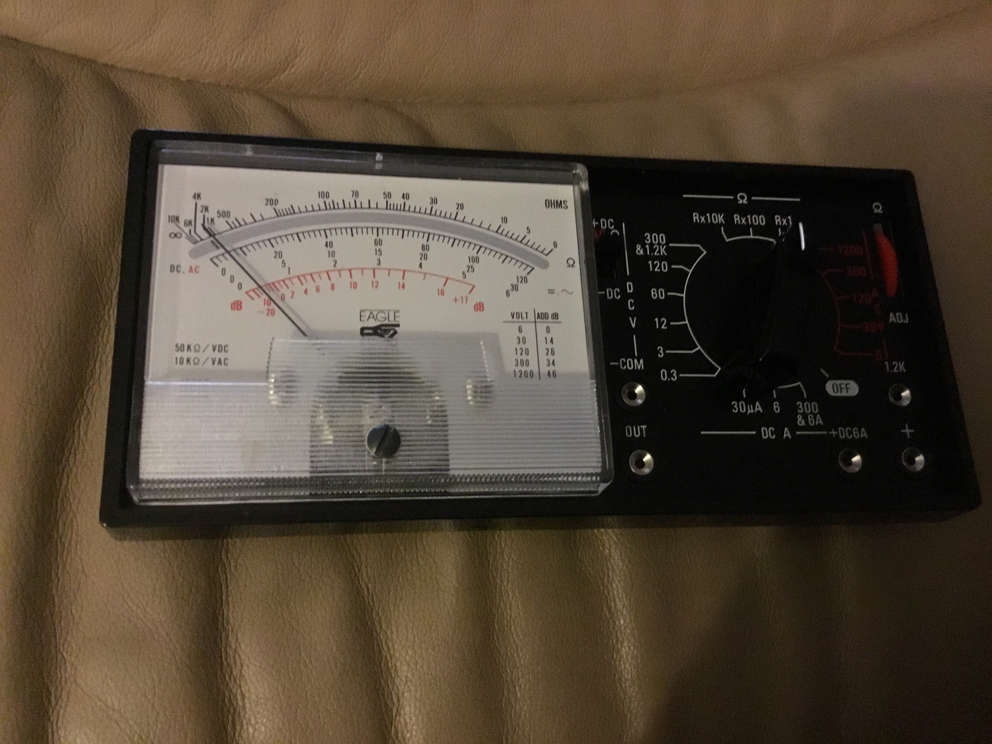

I have an Eagle Analogue multimeter which was not used for a long time. I have fitted new batteries but nothing works. Can’t find a fuse. Can you help?

It is a simple meter possibly from the 70’s. No amplifier or fuse. Test leads are ok. I have two digital meters already. I would just like the challenge of repairing this. Hope this helps. image.jpgimage.jpg

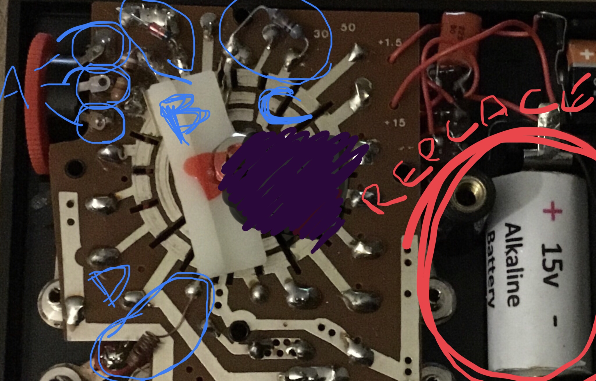

Well, it looks like you MAY have changed the 1.5V AA battery recently but the 15V Alkaline battery looks original and needs to be changed. You can look for a A220 or 504A in a vintage camera shop. No idea if their batteries will be dead from sitting on the shelf so long. Rare battery these days.
It also looks like the potentiometer "A" in photo below was changed and poorly soldered.
Also, diode at "B" looks a bit hokey - are you the original owner or did someone hack it to adjust a range or repair an over-current issue in its past? Same is possible for the weirdly placed resistor at "C".
Also, the coil at "D" looks like it may be burnt or corroded and it may be shorting out the trace on the perimeter of the pcb.
I'd say "Good luck" but I am guessing your wife will soon appreciate that you have one less piece of crap laying around the house when it falls into the bin.

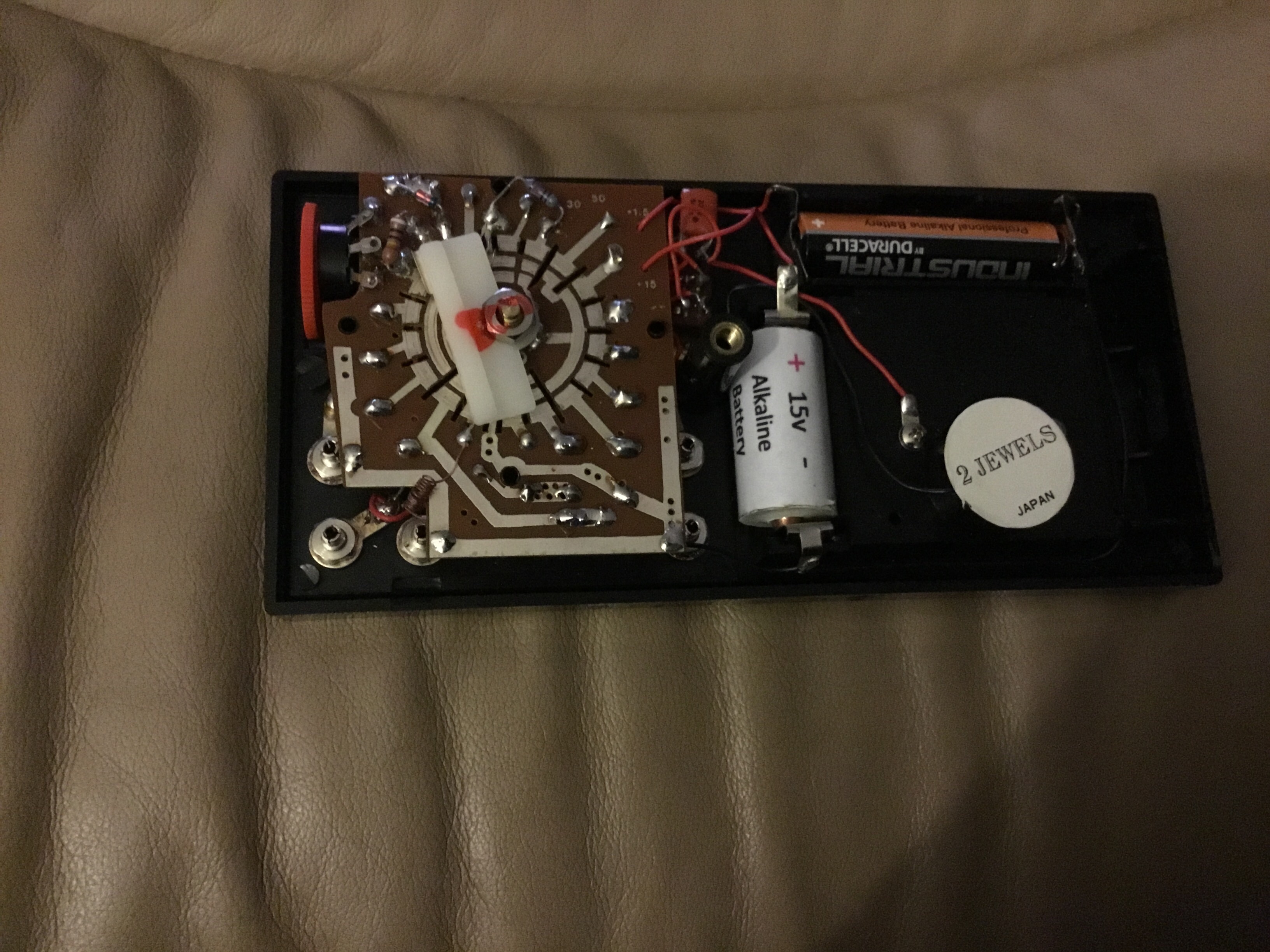

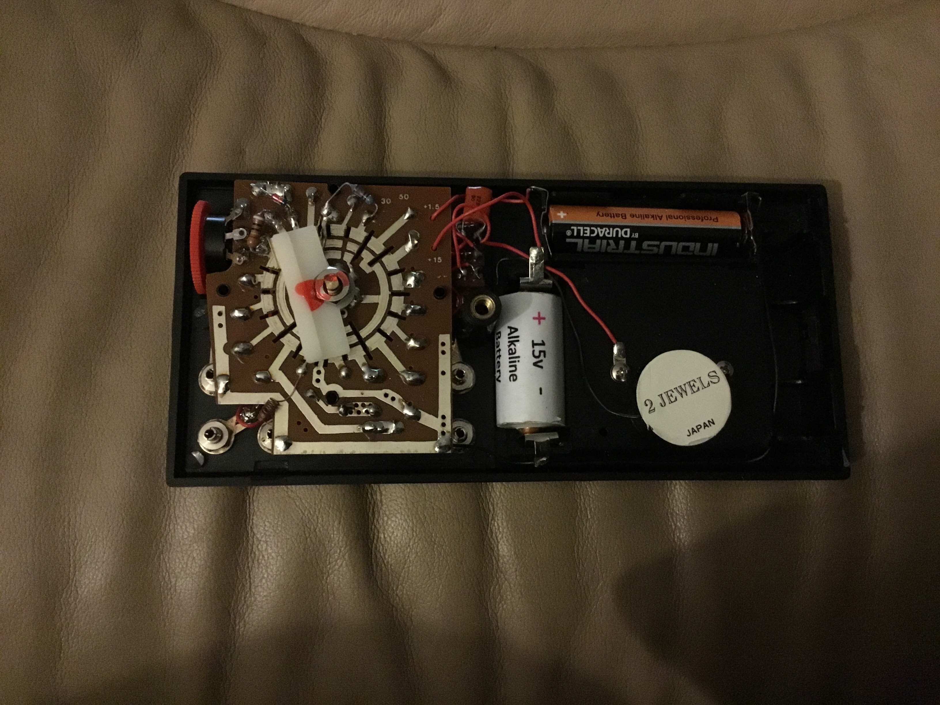

I would disagree with gophert, it all looks original, apart from the batteries - both of which have been replaced - you didn't get Alkaline batteries when this meter was made.
As far as batteries go, they only have any effect on ohms ranges, on volts or amps it works perfectly with no batteries fitted, which is quite handy as you can use such a meter to test it's own batteries (with them removed).

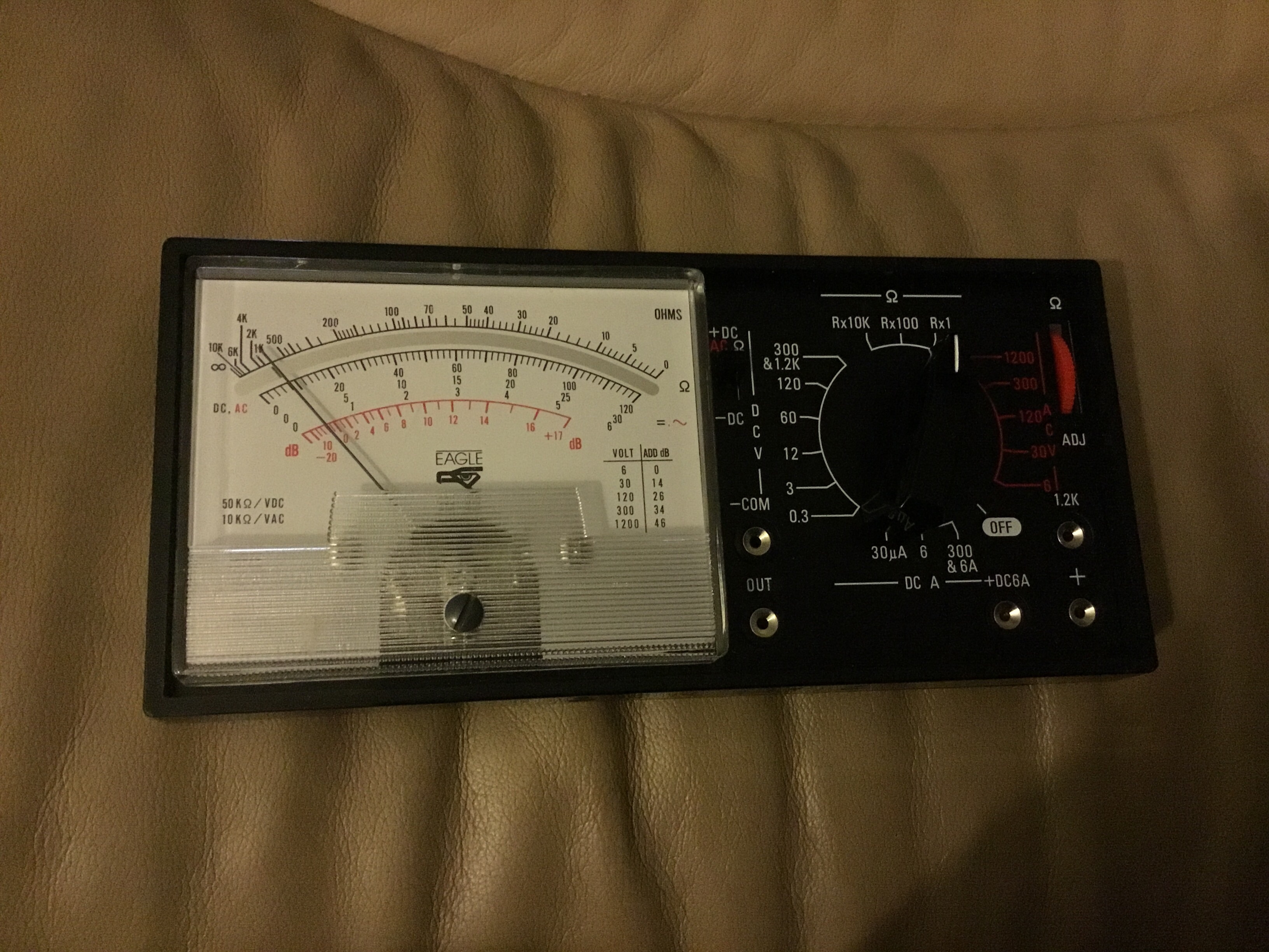

The very first thing that requires to be cheked is that the analog movement works or not.
With your DMMs set in ohms, briefly touch the movement terminals to see if it moves.
Having 2 batteries, one of them 15v makes me wonder if its a fet input meter, but theres no sign of that on the board.
If you gently wiggle the meter does the pointer move?
