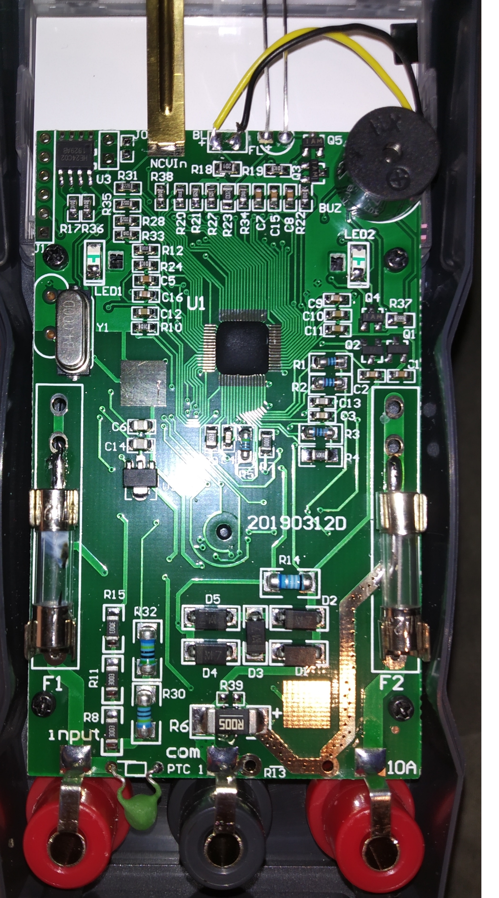

Hello,
I have a 6000 count multimeter i was using it and i blew the 600mA fuse, so i couldn't measure the current with the red probe on the VOmA socket, but then i tried also the 10A socket and still i got 0 always. So i opened it, replaced the 600mA which was completely blown, i took out the 10A fuse and tested it and it gave 0.4 ohm resistance, and it also looked visually in good condition. So i put back the 10A fuse inside and tested it again and now everything is working properly. I don't understand, why is it that the the 10A socket wasn't working properly?
Maybe the 10 a range uses the 600ma range's input shunt and fuse.
I had a meter that lost various ranges when I blew a fuse, such as capcitance and frequency, it depends on what part of the circuit the fuse is in, if it was in the ground line maybe that would explain it.
Haven't read the schematic, but maybe inputs are linked - e.g. current/voltage divider.
This is a picture before changing the blown fuse:

Good image as you can see the 10 Amp current path up from the 10 Amp connector, through the fuse, back down and through a 5 milli Ohm sense resistor to the Common input. It's nice to see a decent image with good detail.
