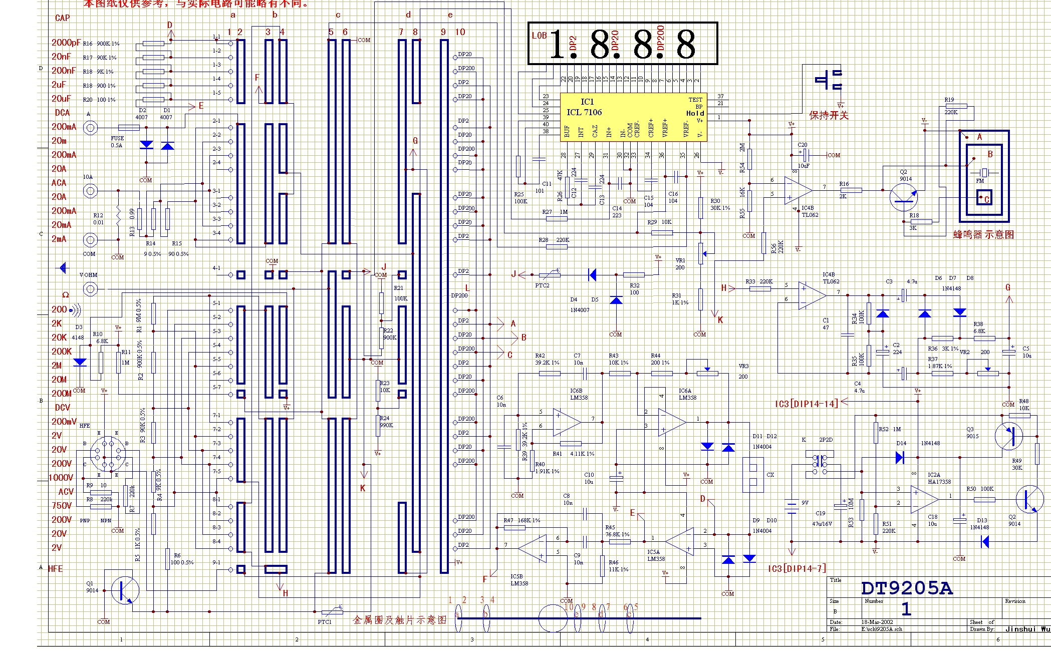

Here is the schematics..
If you can find a buzzer on here let me know....
Nice find on the schematic. It didn't even occur to me to look for it. I agree, though, I can't find a buzzer or the LED anywhere. What is that thing in the top right marked A, B, and C with a crystal symbol? It seems to have no input to the main chip.
Okay, so I ran a text recognition on the Chinese cropped from that top right object in the schematic, and got this:
蜂鸣器 示意图
which, when plugged into google translate, reads: "A schematic view of the buzzer"
It seems fairly certain that that top right portion of the schematic is related to the buzzer. looking at the schematic, it seems like that would be a good place to start. I might start by checking the outputs at Q2 and IC4.
looking online, it seems there may be several different styles of DT9205A, so there may be multiple schematic and board revisions that might complicate things. That schematic seems to be for a version that has separate input slots for the capacitance tester, which not all versions of the DT9205A have. The OP will want to confirm that this version of the schematic matches up with his unit.

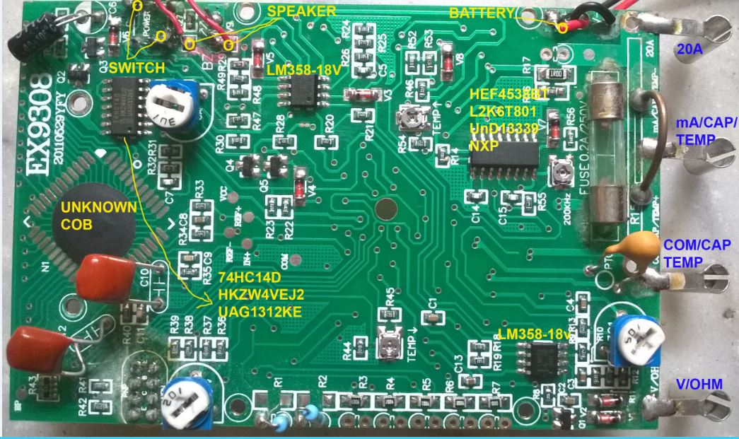

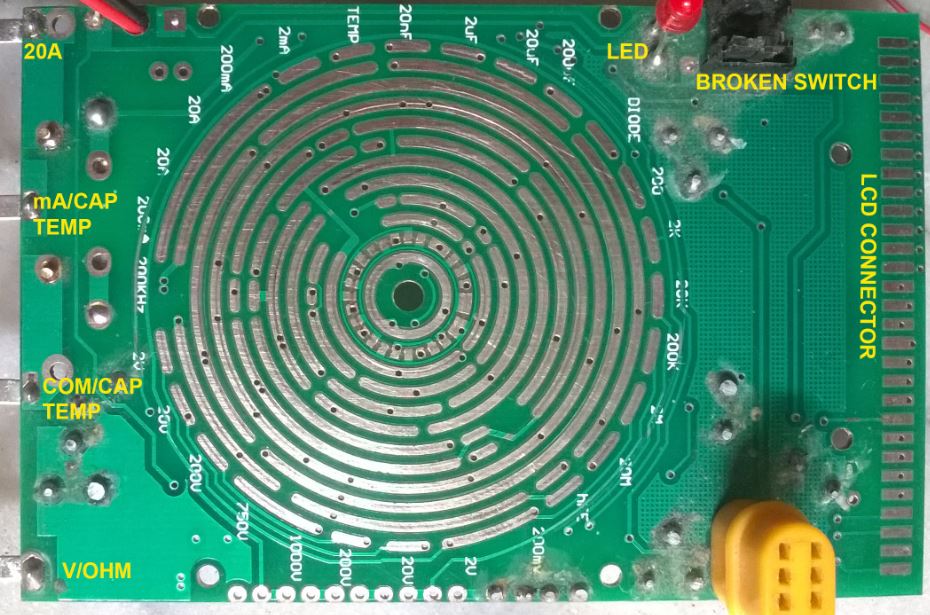

Yes we can see various versions in the market relating to this Model no DT9205A. The above schematics seems different from this board below. Thanks for your help.

Hmm. It looks like most of the through hole components were hand-soldered, and they didn't clean off the flux at all. I would probably start by cleaning off the board with some rubbing alcohol and a cotton swab, then check for cracked or corroded solder joints.
If you aren't able to find anything obviously broken, then you will want to start tracing back the circuit to figure out what components are driving it. It's hard to make out the traces with all that gunk on the board, but it looks like that LM358 near the buzzer is a likely candidate. the left-side op-amp looks like it may be driving either the buzzer or the turn-off circuitry, probably in combination with those discrete transistors in the top corner. Once you have a basic schematic of the circuit, I would start checking the voltages and maybe some of those resistors.
After that, you would need to get into some real real nitty-gritty circuit debugging, so if the problem does not begin to manifest right away, you may consider getting a new meter before you sink an excessive amount of time into repairing this one.
