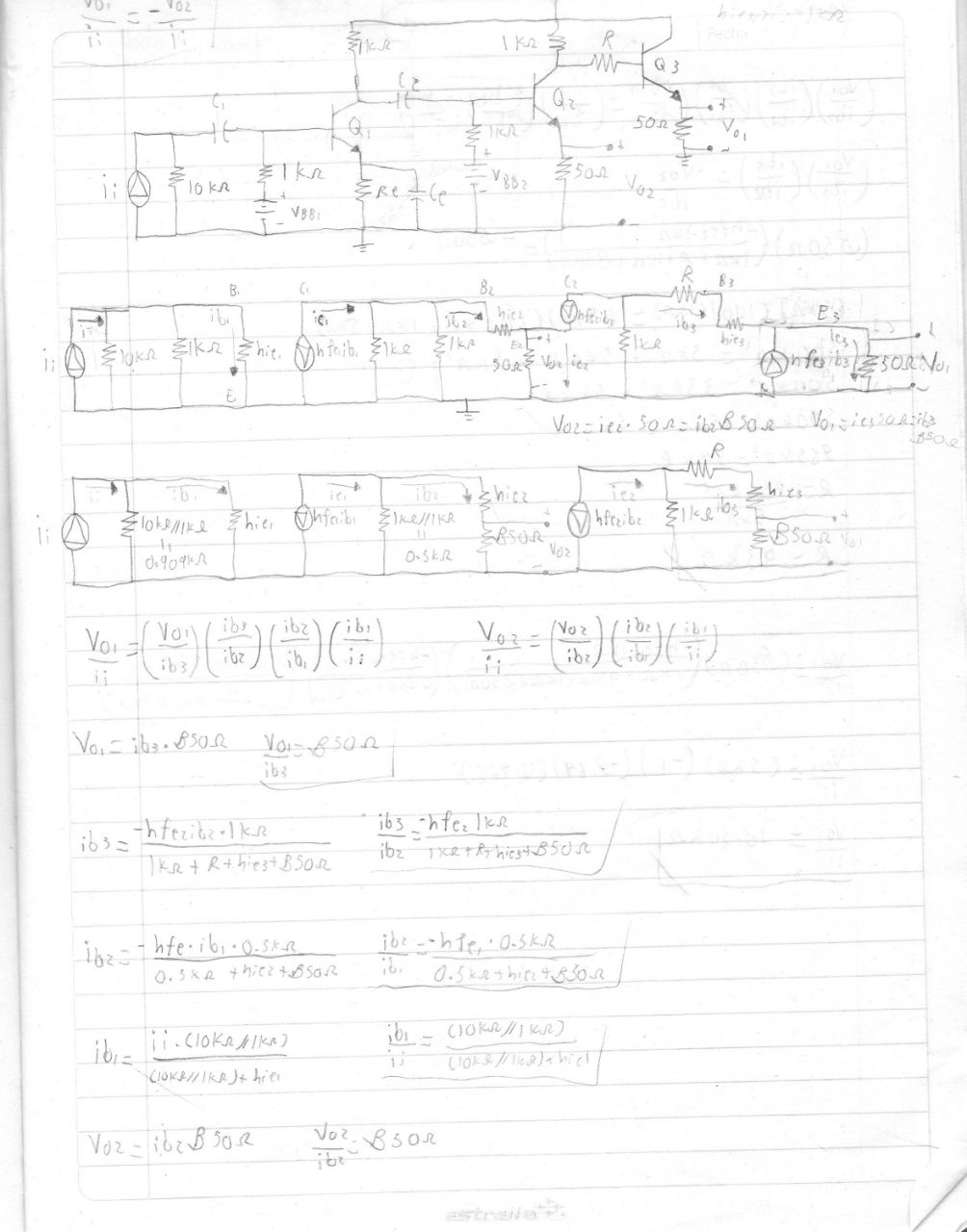

So in order for me to get credit for this problem, i have to get it perfectly!! So i wanted to post this thread to see if someone can check over it! I don't want to get anything wrong.
I had to find R so that Vo1/ii is equal to -Vo2/ii, and to calculate Vo1/ii. The original circuit is the 3 stage amplifier at the top of the first image. WhatsApp-Image-20160605.jpg
Apologies if its a bit blurry
