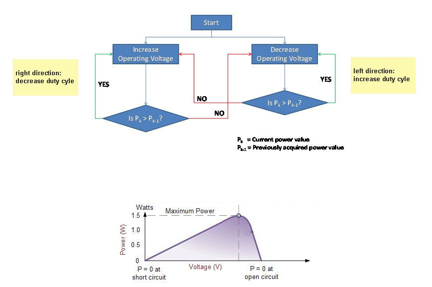

When P_new is less than P_old then according to the flowchart the duty cycle is decreased. To me decreasing the duty cycle would mean that the charge on capacitor would increase and hence more voltage on it. Let's say P_new is the green point "A" in the power figure. To get back to maximum power point, the capacitor needs to lose some of its charge and hence voltage on it, and for this duty cycle needs to be increased and not decreased, so that the charge can get more time to flow toward the output load. Where do I have it wrong?
When P_new is greater than P_old then according to the flowchart P_old is updated with P_new and duty cycle is increased. Again, it seems kinda contradictory to me. Let's say P_new is red point "C" in the power figure and P_old is the blue point "B". Clearly P_old should be updated with P_new but I don't see why duty cycle should be increased. In my view duty cycle should either be held constant or decreased so that more charge can accumulate in capacitor which will raise it voltage. Where am I going wrong?
I think that if the new power is greater, you want to keep the duty cycle at it's new value and not continue on in the same direction yet. On the next step, the controller can figure out if continuing is a good idea. If the new power is less, then go back to the old duty cycle. This is a nice simple method, but obviously there are many other methods, including fuzzy logic control.
So basically, you can step one way and then the other if power is not improving. If power is improving you will move in the correct direction.

steveB : It would be really interesting and good thing to understand the given problem in terms of control theory. But, in my opinion, for me it would be more helpful to understand the model in terms of simple circuit theory first. Once I have some understanding of the model from circuit theory point of view, I can proceed to try to analyze the model in terms of feedback, feeedforward terms. If I'm thinking wrongly then please let me know. Thank you.
Let me try to state my confusion again in the hope that you might be able guide me properly. I will be using this figure.

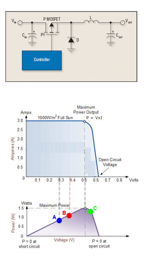

Let us think of MOSFET as a valve and duty cycle as the time duration during which the valve is open. This way the term 'increasing the duty cycle' would mean that the valve would remain open for longer period of time. When the duty cycle is increased (valve is kept open for longer period of time) then more quantity of charge will be able to reach the output terminal, V_out. Increased duty cycle will also mean that the quantity of charge being depleted from C_in at a faster rate and this depletion of charge means voltage getting lowered on C_in.
Suppose, the power being calculated is the point "A" in blue. The point A corresponds to a certain voltage on the input capacitor, C_in, and that voltage is approximately 0.3V. In order to increase the voltage on C_in, what should be done? I think the duty cycle needs to be decreased (valve should remain closed for longer period of time) so that rate of accumulation of charge on C_in is greater than rate of depletion of charge from C_in.
If you think that what I'm saying is wrong then how else the voltage on C_in can be increased so that power point "B" can be reached which correspond to 0.4V. Please remember than I'm thinking of C_in as a dummy load to the panel and also as a dummy voltage source to the buck converter.

You're right. Increasing the duty cycle will decrease the voltage. 0% duty cycle will let the panel to charge the capacitor to the highest possible voltage. 100% duty cycle will make the voltage equal to the battery voltage (plus mosfet drop).
However, you need to maximize the power, not the voltage. If you increase duty cycle and this causes the power to decrease then you need to decrease duty cycle to get more power. If you decrease duty cycle and see the power decrease then you need to increase duty cycle to get better power. Therefore, your actions depend on the direction of the perturb step taken. The flowchart you posted seems to dismiss the direction of the perturb step.
I find this description confusing, although it seems to be correct. Let's not use the word valve and refer to it as open/closed because it is confusing. I would prefer to say "switch" and then closed/open means on/off or shorted/unshorted. I like to say the switch state is value s=1 when the switch is closed, and then s=0 means the switch is open. The duty cycle is then
[latex]D=\frac{1}{T}\cdot\int_{t}^{t+T} s(\tau) \cdot d\tau[/latex]
In other words, the longer you leave the switch on (or closed) the higher the duty cycle is. If the switch is on always D=1, and if the switch is off always D=0. You don't have to define it this way, but it's my choice. If you choose, you can invert it and have D'=1-D as the duty cycle.
I would look at it from a different point of view. Think about the converter as a load resistance emulator, or a controllable/variable resistance. If you short the panel, the current is maximum and the voltage is zero, and you have moved away from point B. If you open the panel, you move to zero current and max voltage, which moves you toward B. Hence, in your case you want to increase the emulated resistance from the converter. This implies that your converter's controller can be configured to emulate resistance with a resistance command as an input, then the MPPT simply needs to perturb the resistance value, and then observe which direction increases power. The simple algorithm will search out and sit at the peak power point.
Next comes the question of how you implement the resistance emulation control, but as you mentioned above, you need to understand the low level circuit operation before you can design the controller. I've designed resistance emulation controllers with SEPIC topology, but a buck converter will have different issues to think about. So, I can't claim to have thought this out fully. I can't even tell you if this will be trivially easy or very difficult to control with this topology. Off the cuff, I see that the average input current (which needs to track the average input voltage to emulate a constant resistance) depends on D and the coil current, as I1=D I2, where I1 is the average input current and I2 is the coil current. The input current is discontinuous turning on and off quickly, while the coil current changes more gradually. This means that D can have a very fast effect on I1, while the effects of I2 take longer. If D decreases, then initially I1 goes down quickly. Also, this will begin to discharge the coil current gradually. A lower input current means higher resistance. Hence, as you say, decreasing D will put you in the correct direction.
However, an inner feedback loop seems to be needed here to make it work as best as it can. The MPPT control is a very slow controller, while typically DC/DC converters should be controlled with higher bandwidth.

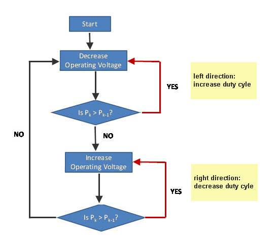

Do you consider this flowchart correct? Please note that I have edited the flowchart a little so that you can tell if my understanding is exactly correct. Now I'm also little confused about the flowchart which I posted in post #39. Thanks.
Yes, except that you cannot go both directions from the "Start" box. You can go to either "Increase" or "Decrease". Since the start occurs when it turns on in the morning, the voltage is likely to be too high, so you probably need to start from decreasing it.
Is this any better? Is there any need for modification? Thank you.

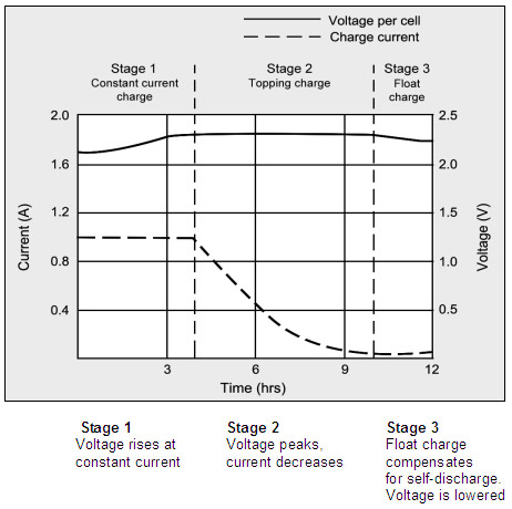

It has been mentioned that lead acid batteries are used for solar energy. Any special reason for this choice? Why not lithium-ion batteries? One of the reasons for not using Li-ion might be their high price. .When it comes to solar energy, do both lead acid and sealed lead acid batteries share the same place?
I understand that when a battery is connected to a charger then the voltage, Vout, at the output terminals of charger is same as that of the battery, as you have also told me. I'm still little confused so let's look at it from a different point of view. Let's suppose we have two batteries; the one is rated at 36 V and is fully charged, and the other is rated 12V and is sitting at 10 V. The positive terminal of one battery is connected to positive terminal of the other battery and the same goes for negative terminals. The 36V battery should be able to push current through the 12V battery because it sits at higher voltage. We have also connected a voltmeter which will read 10V at the start. But why? We know that resistance of one ohm means drop of one volt per ampere, i.e. 1Ω=1V/A where one volt is one joule per coulomb and ampere is flow of charge of one coulomb per unit time through a certain point. Think of 12 volt battery which sits at 10v as a resistance. Please have a look here. The 36 volt battery is pushing the current clockwise and 12volt battery counterclockwise and the winner is going to be 36 volt battery. We can see that 36-10=26volt. Where are these 26 volts going? They are being used to charge up the battery but then why isn't the voltmeter reading 26 volts? How do we calculate the resistance of 12V battery? I think that I know the answer but for some reason I don't know how to put it together. Please guide me. Thanks.
This is the charging profile for a lead acid battery cell. I don't think a battery internally can control the amount of current during its charging. As we can see that the current needs to be closely monitored and gradually decreased in Stage 2. There should be some external mechanism or device which regulates the current going into the battery. Obviously, such a device called battery charger or regulator. But how would a regulator determine that battery has entered Stage 2 in order to tightly control the current?
Although I have made this query before, I'm still confused so I will give it another try. Why don't we connect a load, such as electric heater, directly to the panel? We need to consider two important points about a solar panel first. First a solar panel behaves like a current source. A current source is always concerned about passing a fixed amount of current through a resistance and in order to do that it can adjust the voltage (its pressure) around the resistance. Secondly, a solar panel's maximum power is rated for Vmpp and Impp which is mostly calculated at 1000W/m^2 at 25C. Suppose the heater resistance is 20. We know that V=IR=(1.5)(20)=30V, and Power=VI=(30)(1.5)=45W. But from the figure we can see that the panel is still willing to provide more voltage (strong push or more pressure) if it is offered a suitable resistance. It appears that that suitable resistance is 33Ω. If we had used resistance or heather of 33Ω then power obtained would be almost (50)(1.5)=75W. We would only be able to utilize this extra power of 30W (75-45) if the heater's resistance can be adjusted. Or, the easier way would be to use an mppt tracker. Suppose, the tracker steps down Vmpp to 30V on its output terminal and steps up the current to 2.5A then you would be able to get maximum power even with your 33Ω heater. We should also consider another issue. If we were using a light bulb instead of heater then there would be other issues. First, if we had connected light bulb directly to the panel then in the first place we would be wasting some power and on the other hand light from the bulb would continuously vary. If we had connected light bulb using an mppt even then brightness will vary during different times of the day. So this tells us another advantage of using a battery an intermediate energy storage device. Do I make sense?

If you connect 36V battery to 12V battery, the voltage will be obviously the same. The voltage of 36V battery will drop (as any battery does under load) and the voltage of 12V battery will rise (as with any battery being charged). The 36V battery will be charging the 12V battery. The resulting voltage will depend on the size of the batteries.
If 36V battery is much bigger, it'll overcharge the 12V battery - water in the electrolyte will be decomposed into hydrogen and oxigen and an explosion may result if there's a spark (or in case of li-ion battery it'll be an explosion for other reasons).
If 12V battery is bigger, it'll overload the 36V battery. Quick discharge will release a lot of heat, electrolyte will evaporate and lead will melt, but hopefully, nobody get hurt.
Sure it also depends on the states of charge of these batteries.
Lead-acid batteries are very common, they're much cheaper and safer than li-ion. Sealed batteries are more expensive and last less than flooded ones. But they're no perfect by any means.
