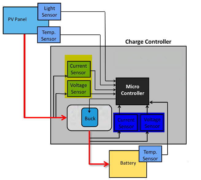

Hi
I have decided to make a buck MPPT using perturb and observe algorithm. We have discussed some of the basic concepts before in the posts above but I'm starting this discussion afresh. This might mean that I will be repeating some of the questions but this time I believe I will be in a better position to frame my previously asked questions and understand your replies. Your suggestions are always welcome. Thank you.
Q1: Why do we need a temperature sensor on the panel? I understand that the panel's voltage is affected by the temperature maximum power point can simply be obtained using voltage and current sensors. In my view it doesn't matter how temperature shifts the curve, the maximum power point can still be calculated without using temperature sensor. In other words, temperature sensor is unnecessary.
Q2: I think both sets of current and voltage sensors are equally important. One set is used to calculate maximum power point and the other is used to control battery charging. But I think there is one thing missing. There should be mechanism to turn off the charger under two conditions. The first condition is that if it's dark outside and for this purpose light sensor can be used, and the other condition being that the battery has been fully charged. What do you say?

Q1. You do not need a temperature sensor for "perturb and observe". You could use temperature, voltage and current to calculate the entire I-V curve and MPPT point so that you do not need to perturb anything, but it's totally useless for perturb and observe.
Q2. For the night disconnect you need a latching relay. You could use a diode, but that would mean loosing diode drop continuously.
Disconnecting when a battery is charged is not a good idea. Say, you have some loads connected to the battery. If you disconnect, loads will be discharging the battery while you're wasting solar energy. The standard way is to drop voltage to about 2.2V/cell and let loads use solar energy without dischargng the battery.
But you need to dial down voltage long before battery is fullty charged. This is because a battery that is close to the full charge cannot take a lot of current.
If you're going to use some different kind of battery (not lead-acid), the charging pattern might be totally different.
Q1: Probably true. Voc and Jsc are strong functions of temperature. Voc in particular. PANEL monitoring is incomplete without temperature.
Q2: Jsc is in esscence a light intensity monitor with strong effects with shading, so it alone can determine starts.
Remember there are two types of MPPT and they can be used together. One is shifting the operating point and one is pointing the array.
Some complex schemes like a power plant might "shake" the array to remove snow.
Clouds are longer term effects, so you might not want to perturb if the temperature did't change.
SO, i'm advocating:
1. temp is essential when monitoring the array. Voc and Jsc are temp dependent. Temp may determine if you should perturb (clouds).
2. If power drops and temp does't change is it a cloud?
Physically moving the array doesn't make sense unless the temp changes.
An easy way to do positioning is to columate the sun. A round cell cut in quarters is perfect for this. If all generate the same current your aimed properly.
SNow and clouds are real world events.
Health of the array requires temp. Jsc is proportional to "average intensity.
My guess is once yo find Vmp the first time, you can more predictively move based on temperature.
Your inensity is proportional to Voc and intensity is proportional to Jsc, so maybe both can make a better algorithm.

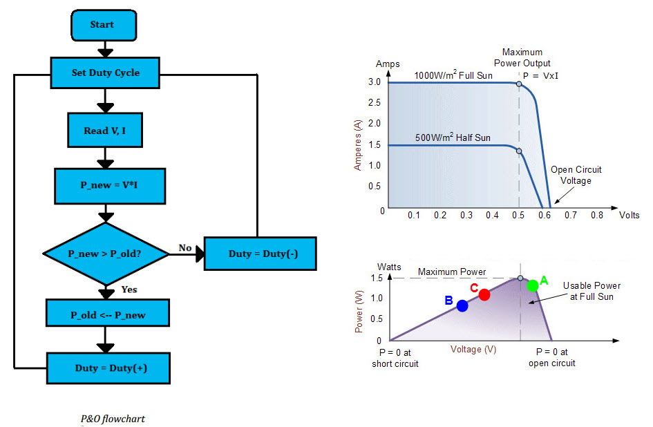

I understand the operation of a standalone buck converter. It's output voltage is less than or equal to the input voltage and depends on input voltage and duty cycle. If duty cycle is increased, output voltage increases. Likewise if input voltage is increased while keeping the duty cycle constant, the output voltage also increases. If both input voltage and duty cycle are increased, the output voltage also increases. But I get confused when buck converter is used as part of mppt charge controller. If you have some more time, please give this video a look. Now please proceed to the queries below.
I think the capacitor C_in in Figure 2 plays the role of input voltage source for the buck converter and at the same time also functions as dummy load or resistance to the panel.
An mppt charge controller is only programmed to find the maximum power point (ignoring the battery charging algorithm). An mppt only varies the rate of pulse width modulation to the switch such as MOSFET of buck converter to find maximum power point. In Figure 1, it is shown that maximum power point occurs at the same voltage for several curves. Perhaps, in reality this is not really true and maximum power point occurs at slightly different voltage values. But I would say the difference between those real voltage values won't be too much because if it were then the output voltage will vary. But as it is evident from the linked video above, the output voltage doesn't change. So, what do we conclude from this? My first conclusion would be that maximum power point occurs at roughly same voltage. My second observation would be that during search for maximum power point output voltage continuously varies because the rate of pulse width modulation is constantly changed.
Section 3:
When P_new is less than P_old then according to the flowchart the duty cycle is decreased. To me decreasing the duty cycle would mean that the charge on capacitor would increase and hence more voltage on it. Let's say P_new is the green point "A" in the power figure. To get back to maximum power point, the capacitor needs to lose some of its charge and hence voltage on it, and for this duty cycle needs to be increased and not decreased, so that the charge can get more time to flow toward the output load. Where do I have it wrong?
When P_new is greater than P_old then according to the flowchart P_old is updated with P_new and duty cycle is increased. Again, it seems kinda contradictory to me. Let's say P_new is red point "C" in the power figure and P_old is the blue point "B". Clearly P_old should be updated with P_new but I don't see why duty cycle should be increased. In my view duty cycle should either be held constant or decreased so that more charge can accumulate in capacitor which will raise it voltage. Where am I going wrong?

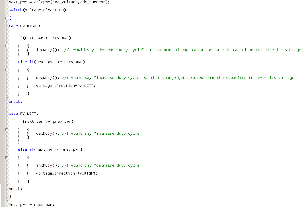

Please also have a look on this pseudocode.

You don't really need a separate light sensor when you have panels.
The charging profile for RE system is similar for all lead-acid batteries and looks like the picture you attached.
2. There are 2 separate regimes. When battery is discharged, you want as much power as you can get, so you track MPPT and don't worry about current into battery or its voltage. When battery is nearing its full charge, you forget about MPPT and worry only about the battery voltage. The panel voltage will naturally go above MPPT.
MPPT does depend on the level of light, but very little. It does depend on the temperature to greater degree. Setting aside partial shading, that's all it depends on.
3. The flowchart is wrong. You perturb. If you see more power, you stay at the new point or move further in this direction. If you get less power, you return back. Very simple in theory. The biggest problem is to keep it stable when clouds are passing by and the light conditions change rapidly.
