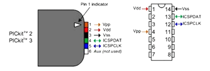

I'm in the process of making a DC-motor . However, I'm getting an error, the problem is that my PICKIT3 will not connect to the microcontroller. What am I doing wrong?
I'm using PIC16F15325 controller and using MPLAB X IDE v5.45. I'm using PICKIT3 for programming/debugging.
What I think has gone wrong; could it be because pin 5 on PICKIT3-PGC is connected to VDD on the PIC?

Here are my circuits and schematics:
What do I have to do, any suggestions?
As mentioned, you've connected it wrong. Plus, you need to power the circuit to get it to work. The PK3 will not power your circuit.
So actually on the last picture I have attached, so the last (left) has no connection? So basically, the one to left, has to be free (not used)?

the arrow on pickit is mclr, vdd is beside it
Yeah, I found that out. Thanks for helping.

I am getting 'Failed to program device... Target Vdd not detected. Please ensure the target device is connected' - So that means, that the battery is done?
Exit everything, unplug the PK3 and try again. MPLABX is disgustingly buggy and Microchip should be VERY ashamed of it.
How long are the wires from PK3 to mcu ? They need to be as short as possible..
