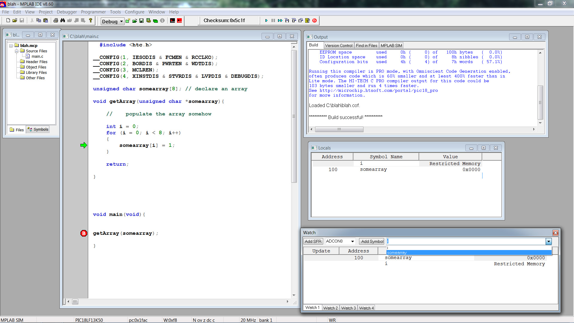

I have attached a jpg that has the program code and also the mplab environment in it.
MPLAB SIM doesn't appear to be seeing the variable i, and is in a forever loop when it should eventually break out of the for loop. Secondly, in the watch window, it shows the variables as "restricted Memory" and does not see the array as an array. Should I not be able to see the values in the subroutine?
I'm kind of baffled about this and want to get on with debugging my program but it doesn't help when I can't see the variables within a subroutine... The other weird thing about it is that I once was able to see these variables and now cannot, and I don't think I did anything to change it.

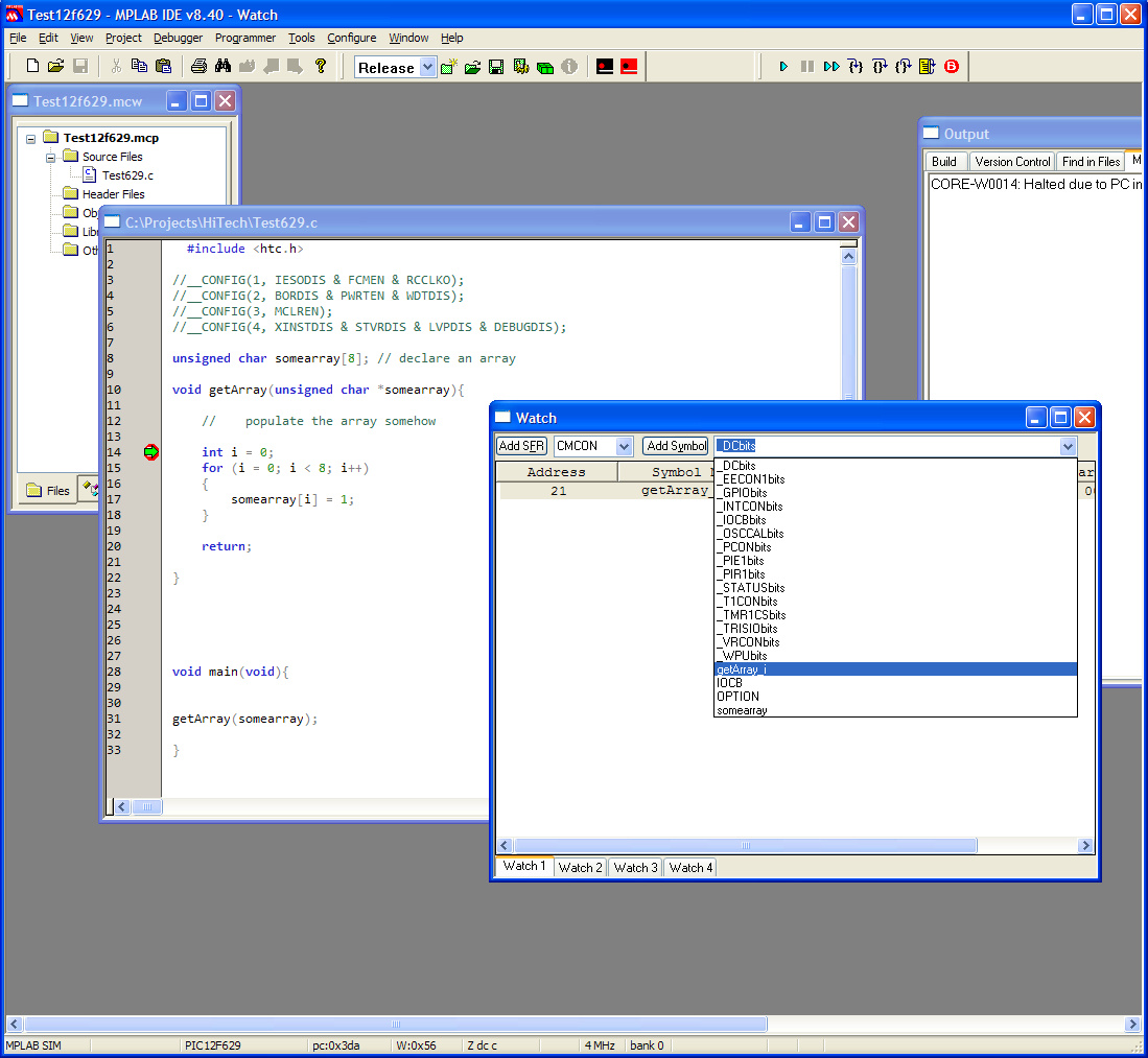

I typed in your code as it was. Most sane people would have provided code that could have been cut and pasted.
I ran it in the simulator with no problems. The variable "i" looked just fine in the LOCALs window while I was in its function. Scope is important here. No loop problems.

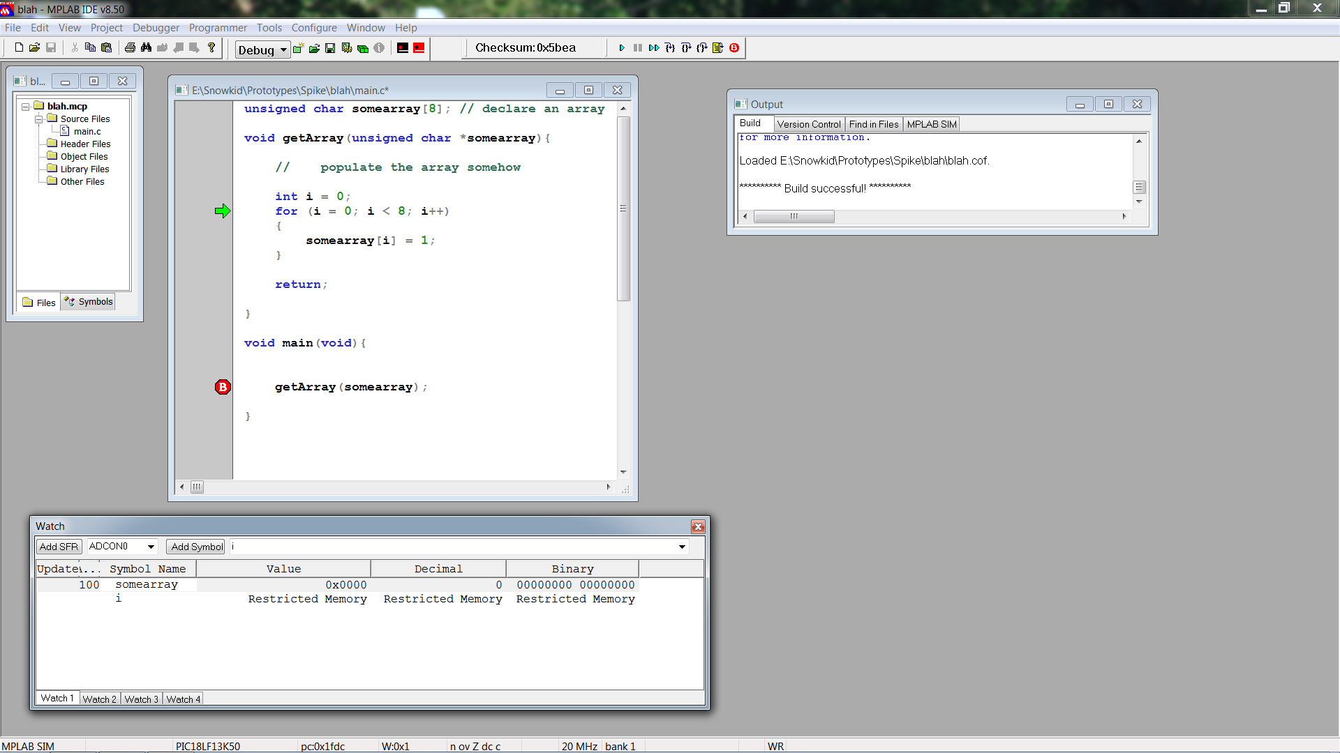

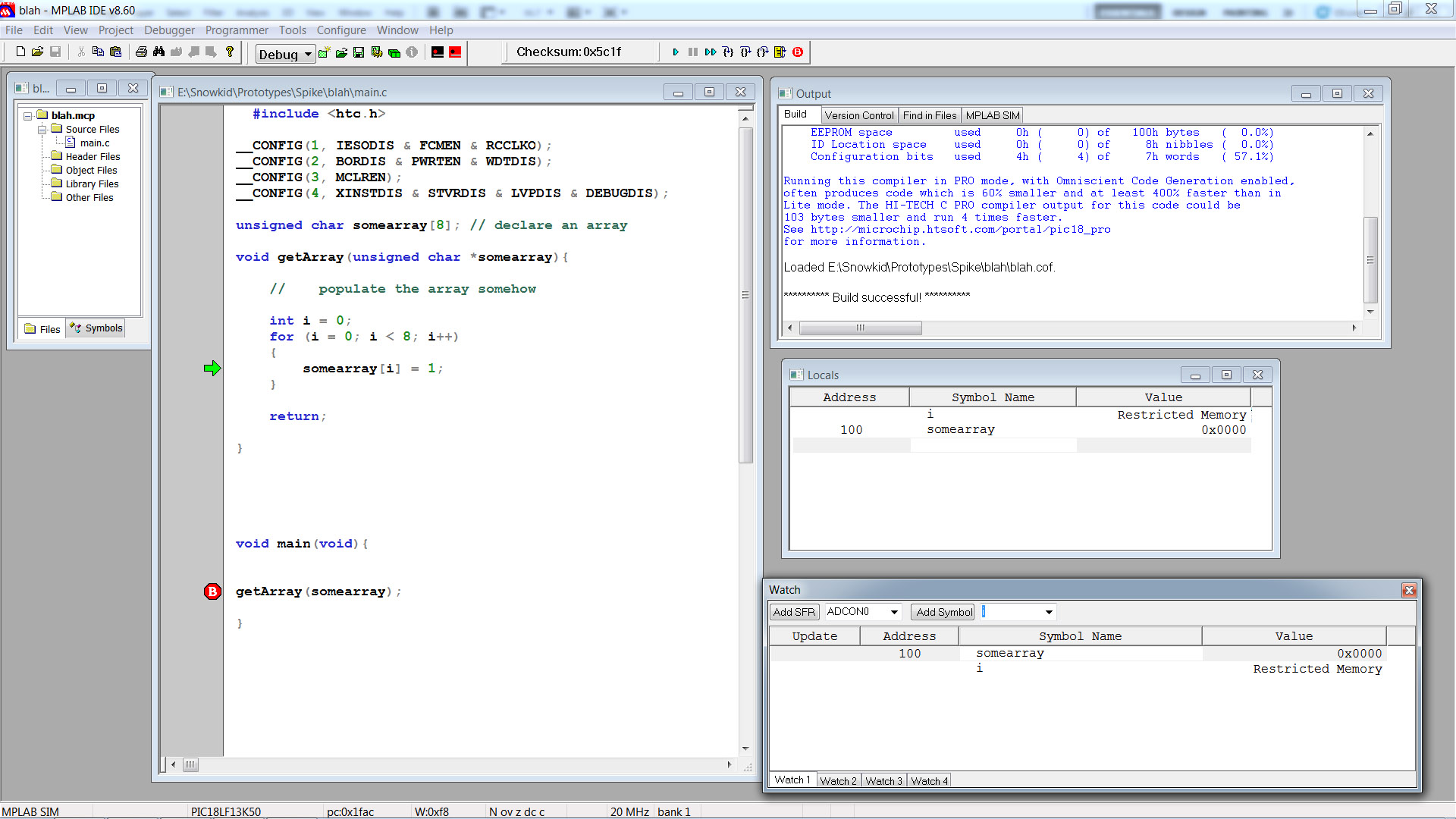

ok and here is a new screen grab with the locals window adding the configuration word and htc.h. I am still getting the problem in the watch window AND the locals window...

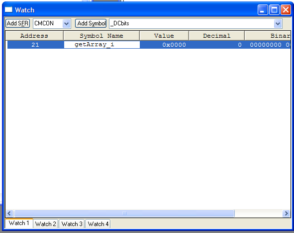

In HiTech C the local variables are preceded by the function name. So you should be looking at getArray_i.

It's in the righthand drop down box of the watch window. You will have to rerun the code for it to show the correct value.

The variable somearray is your array. You should be looking for getArray_i.
The colour variation is just Photoshop converting it to png. I'm on version 8.40.
could the compile line have something to do with it?
Executing: "C:\Program Files (x86)\HI-TECH Software\PICC-18\PRO\9.63\bin\picc18.exe" -oblah.cof -mblah.map --summary=default,-psect,-class,+mem,-hex --output=default,-inhx032 main.p1 --chip=18LF13K50 -P --runtime=default,+clear,+init,-keep,-download,+stackwarn,-config,+clib,-plib --opt=default,-asm,-speed,+space,-9 --warn=0 -D__DEBUG=1 -g --asmlist "--errformat=Error [%n] %f; %l.%c %s" "--msgformat=Advisory[%n] %s" "--warnformat=Warning [%n] %f; %l.%c %s"
Try starting a new project and cut and past your code into it.
Edit, I just checked and the version of HiTech C I have doesn't support that chip.
I can duplicate the problem for the pic18lf13k50. Works fine with the 18F1320.
Someone needs to look at the generated asm.
EDIT: Mike. I find it strange that the compiler does not complain about a chip it can not generate code for.
