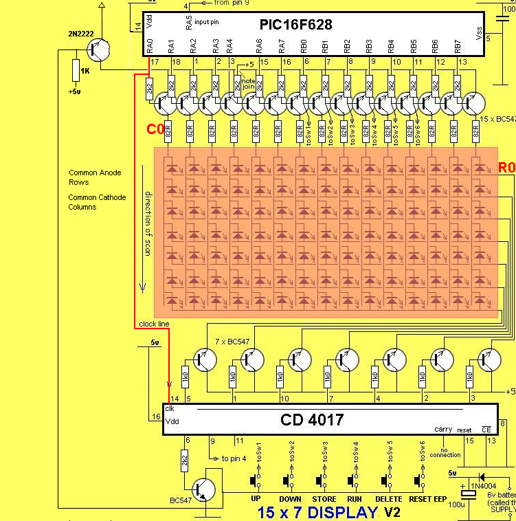

I'm trying to construct your 15x7 LED Display but got confused on the following part of the schematic..
RA4 is DIRECTLY connected to BASE BC547? and the 2k2 resistor to +5VDC?
Also all the tact switches terminals that are connected together all connects to BC547 collector, no other connection?
Thanks for the time..
BR
hi BR,
I am just helping a fellow member with that 15 *7 .
On that PIC, RA4 is an open collector output, so the 2k2 pull up to +5V is required, the RA4 pin goes directly to the transistor base.
The low side of the 6 switches goes to the collector of that transistor connected to pin6 of the 4017.
The top of the 6 switches go to PB0...5.
I have his 15 * 7 running OK on my bench.

Final question. Those 6 switches are brought to LOW by BC547 via pin6 of 4017? since I saw an extra wire after SW6, I presumed it's not connected somewhere else??
BTW right now I'm working on a PCB layout of this circuit...
Thanks..

That wire after pin 6 is just a drawing error.
When pin 6 of the 4017 goes high, the 6 switches are enabled, at the same time the PIC's PORTB is set for input.
If a switch is pressed the pin its connected to is pulled low so the program detects that switch and does whatever its programmed to to do.
Up/Dn/Store etc
everything is clear now..i'm finalizing my layout...thanks again eric...:D

Colin,
The 15*7 matrix using 'common anode' Rows works OK.
BigAl_Scorpio built this modified version, I just helped with the debug.
I have attached the png and asm files, feel free to add them to your site.
I have modified the program so that sw6 , 'effects' now resets the EEPROM message len to 1, this quickly clears old messages.
In addition to the changes by Al, I have added a 2N2222 that is controlled by 4017/pin6. This was needed because when PORTB was set to input, the weak pull ups were looking into a base emitter junction of the column drive transistors.
To the program it appeared that the sw1 thru sw6 were always low.
