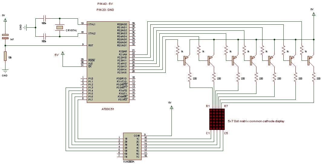

I am designing a moving message display using atmel ATmega controller,74HC595 and dotmatrix with both red and green color using c for programming..My problem is that how can i show message in two colors? 2nd i want to display time and temperature also.anybody have the coding routine?
try to proteus this file
