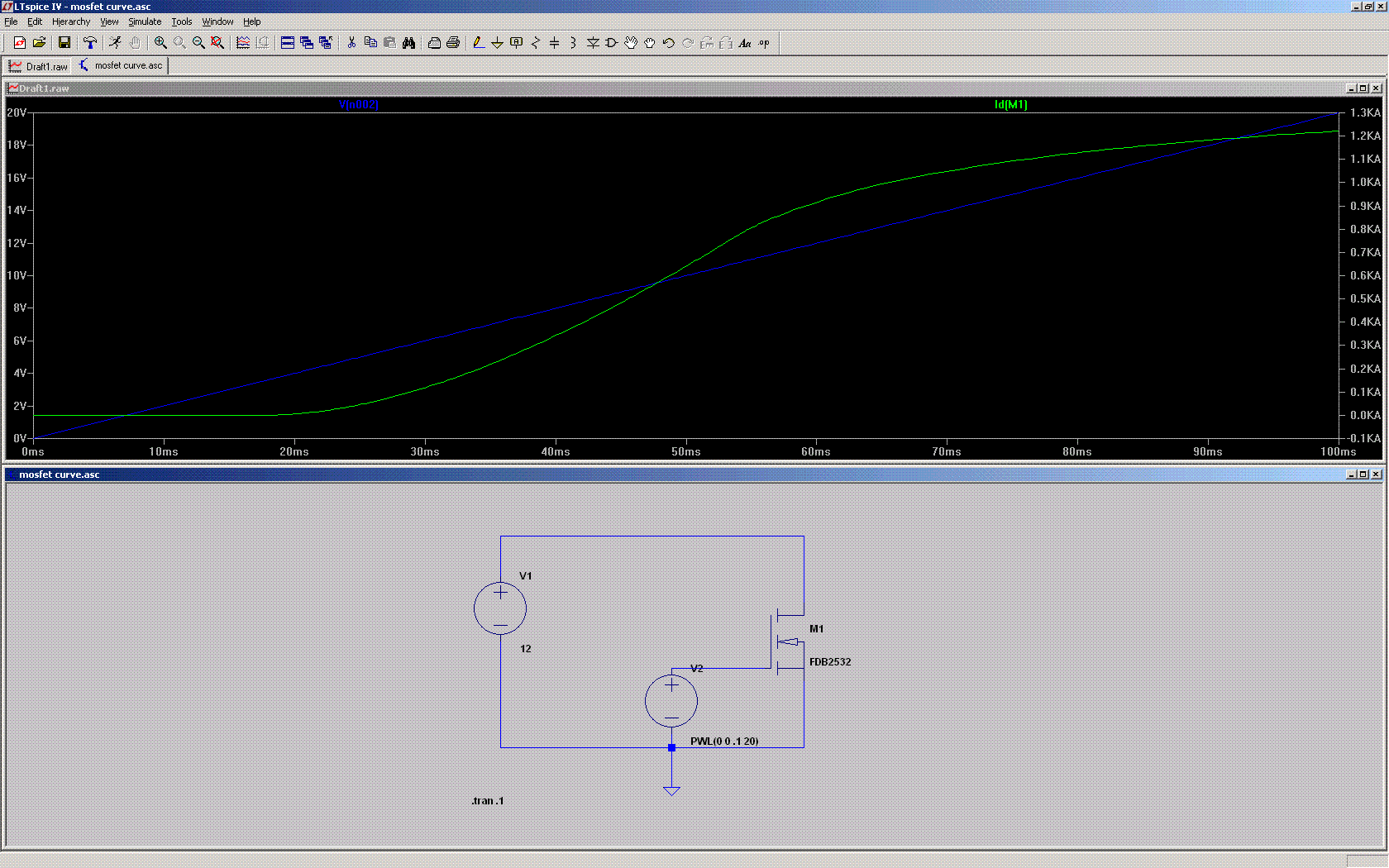

EDIT: LTSpice of all three regions. Mikes sim doesn't show the pinch-off effect in the saturation region.
  • mosfet curve.asc
You're making this too complicated. To minimize dissipation, you want to move to the left (lower Vds), on the Id/Vds curve, assuming constant Id.
Every (without exception) Vgs curve is above and to the left of the one below it. Do the math. It works.
