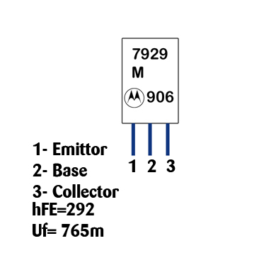

Hello,
I need help looking for this transistor
I believe it to be a PNP
#7929
I did a Photoshop picture exactly how it looks.
Please if anyone can help.. I would greatly appreciate it..
I need to replace this. It's burnt.. I found the same exact one without the identification marks shaved off..
The one I found works fine.. But I need more
Test the gain of the part, get all working limits taking into account Vc, and Ve, Ie and Ib, from the circuit that works fine. then get a transistor that will work similarly

The most important info is WHAT the transistor did in the circuit. Can you show photos of the PCB etc and/or schematic showing what the part does in the circuit, and what the PSU voltages are etc?
That information will allow the choice of one of the common modern transistors to replace it.

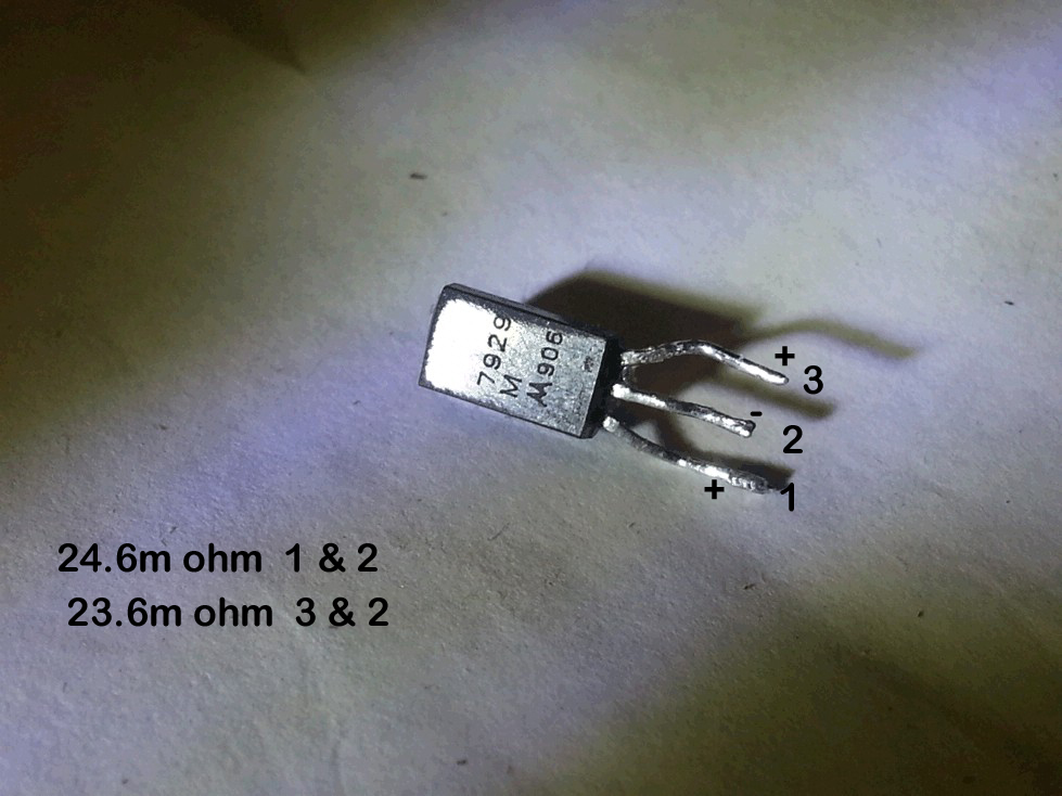

I figured out the pinouts.. Can someone point to me a better substitute.
The originals work fine after 3 months then it burns out again.
Maybe there is a better one out there?
PNP
1- Emitter
2- Base
3- Collector
hFE=292
Uf= 765m
