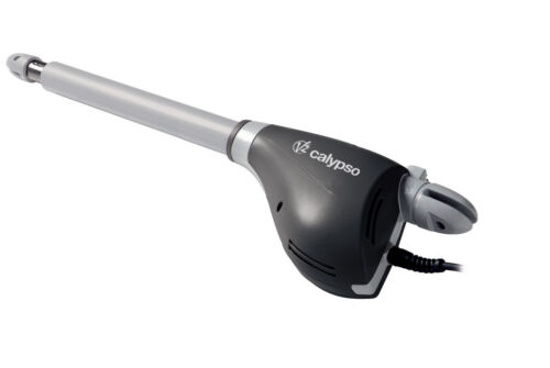

I'd look at motors designed to operate such as large swing gates, especially linear types as Max suggested - they are far cheaper than rotary ones.
eg.

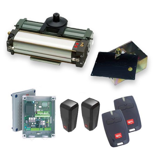

You can also get electric/hydraulic types;
"Pure" rotary actuators for high mass loads tend to be rather expensive..

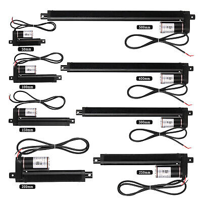

Basic, "bare" linear actuators are very cheap, but you need to provide the motor speed control and allow for acceleration / deceleration, safety switches etc.
A 630Kg door slamming at high speed would not do anything any good - especially if a person or limb is in the way!
