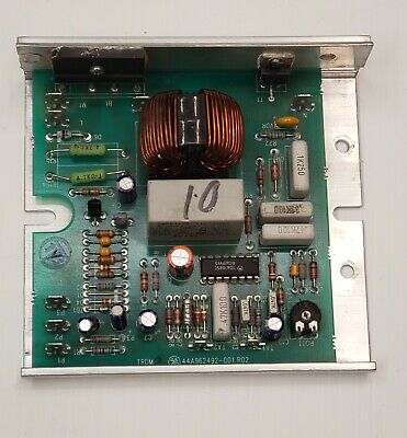

I have a motor and the controller from a treadmill that I would like to use on a project. When I first got it the motor worked but after letting it sit collecting dust for awhile now nothing. I have not been able to find a schematic for the control and was wondering if someone could help me out with that. If I had that I think I can find what is wrong and repair it. The control was made by GE and the number on the board is 44A962492-001 R00. Thank you all for any help here.

The motor has a wound field as well as a wound armature and is 2hp 90 volts. 4 wires going in, two for the field and two for the armature. I can hook up a DC source to it but how much do I need to supply to the field and how much to the armature. Don't want to burn it up. When I had the controller hooked up to it the voltage was next to nothing suppling the motor. There are a couple of resistors that get warmer than they should with no load so I am suspecting a problem with the board. The pot has no value printed on it but measures 8K. Thank you
Here is a picture of the controller.
The absence of large electrolytic cap would indicate it is not PWM and possibly SCR.
Can you see the device numbers of the heatsink ?

Thank you MaxHeadRoom. Should I just call you Max? Anyway, been without my computer for two or three hours. Phone was down. The number on the heatsink is, I'll just give you all of them, IC3645TMRM1A and then there is KK6201T R04 VJ. Not sure what all that means but maybe you can explain it to me.

After doing some more reading I found out that the motor is called a shunt wound motor. I hooked it up to a 24v supply and it runs just fine so the problem is in the controller. Printed circuits are kind of hard to follow but I am going to try. I doubt that I will be able to draw a schematic though. I checked for voltage at the connection going to the motor and there was nothing. Didn't matter where the pot was set. I should look to see if I could just buy a speed control that would work that would not be too expensive.

That is a better pic that seems to show a bridge rectifier and a TDA1085 which is a Motorola IC that was developed to control a Universal motor for washing machine use.
The TDA1085 controlled a Triac. (T1?)
It also has a low-res digital input for a simple tach.
The board does not appear to have inputs for the field so it could be a universal (series field?) motor

Check to see if it is in fact a Universal (AC/DC) motor, the field in series with the armature, it also should have the tach, which is paramount using a Universal motor for T.M. operation.
Terminals TA1 & TA2 = tach?
How are you sure it was not used in a series fashion?
Also if that is a Triac on the H.S., then it again points to being a Universal motor..
I remember about 30+ yrs ago when Honeywell developed this IC for W.M. use for these motors.
There are 4 wires plus a ground going to the motor. The info on the motor tag is ---DC motor type BD6219 059142/092836 (don't know what these numbers are for) Volts 120 A. 6.2 K94 Hp 2 MW XJB (don't know what these are for either but they were on the tag) Cust pt 5P80GY3 I will google some of this stuff and see what I can learn.
I am guessing that two are the motor, 2 for the tach and GND?
And it is a Universal (series field) motor.
