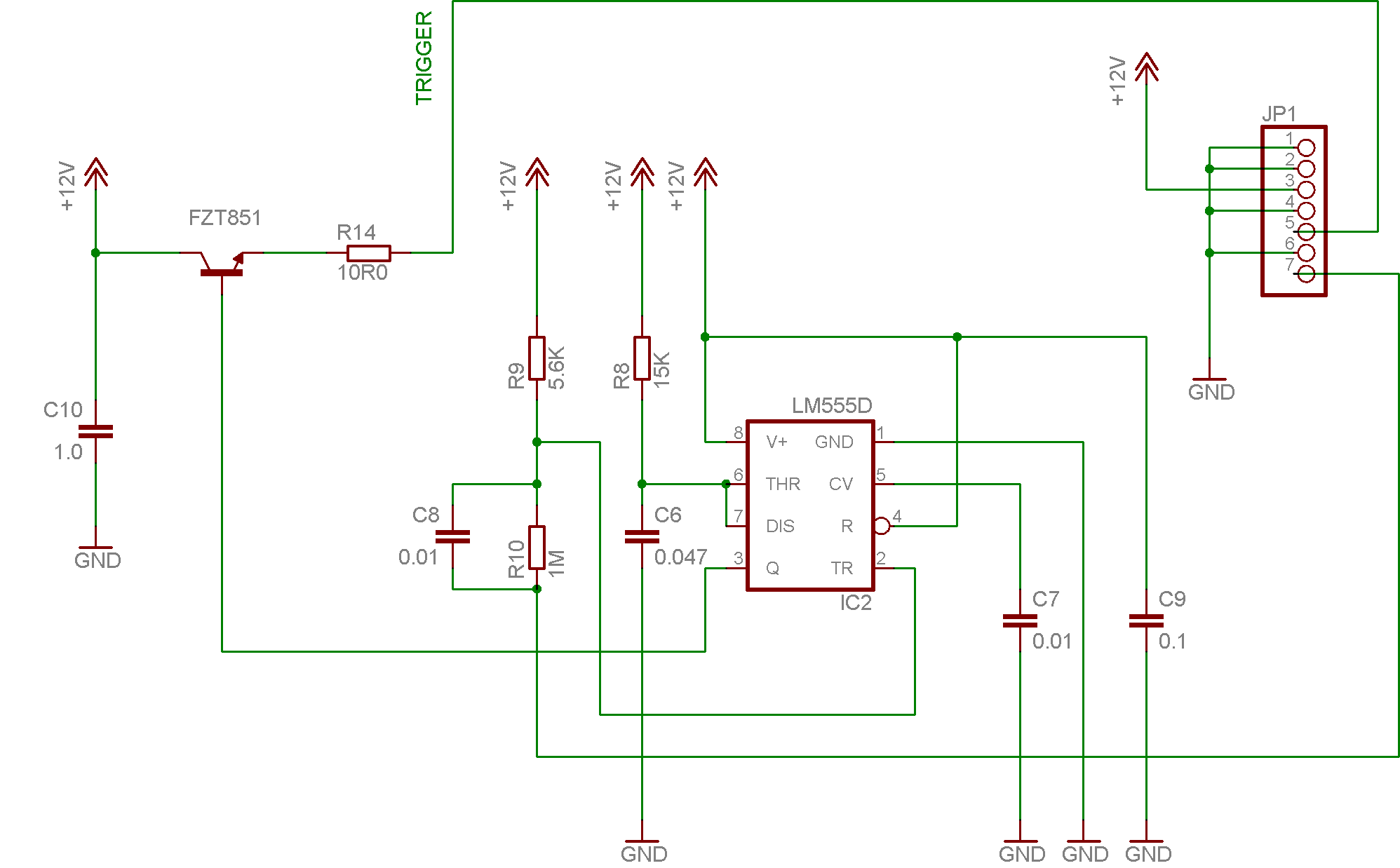

A 555 configured as a Monostable will give a single pulse of defined width every time you push a button.
Look at the 555 datasheet for the Monostable.
You may require a current buffer between the output of the 555 and the 10 MOS gates.
This is to ensure a very fast turn ON, which I think you are asking for.
you should be able to expect less than 5uS switching time with a 200mA 555 output. That would be a problem in a power converter but you are only switching it once in a while.
BTW, that tendency to "stay on" is a mixed blessing. it is the cause of the both the low power drive capability (try putting 100A through a bipolar with out a heatsink) and the static sensitivity (though some FETs have built in gate source zeners these days that helps with that).

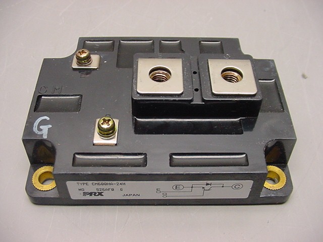

If you are making some sort of pulse device, have you considered a large inductrial SCR or mosfet like this.
The one shown is expensive, as it is new. I got three, large SCRs (pulse current 1500A or so) for about $10 on ebay awhile back. I used the 555-based trigger circuit, attached. John

The problem with the 555 timer circuit is; if the pushbutton is held down it keeps sending pulses.
So one has to let the pushbutton go fast enough so this won't happen.
Actually that is not the case. The circuit I posted, which is simply an implementation of the monostable suggested by ericgibbs, gives only one pulse. Moreover, it does not give a secondary pulse when the switch is released.

@jpanhalt
I rechecked the circuit and I found a component wasn't properly connected.
It works great now.
