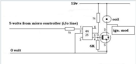

ok here is how i have conected the mosfets until now whit small changes
the lastes sheme is here

yeah i already see coming up all e meseges whit the question why do you connect the gate to 0 whit a resistance..
well...if i don't connect it to 0 after given it the pulse and cutting the pulse of it keeps connecting drain to source..!!
and if i don't do it whit a resistance then the gate doesn't notice a voltage..
TKS
p.s. i thing the diode betwween drain and source is making the problem
but i cant find a fet whit out a diode in it..
relay
almost forgot to tell that a relay is to slow in my posision..
it has to be a real rpm killer..
soow if you put it on 3000 rpm..
it NEVER comes higher than that and if you give full trotle all the time
it never comes lower..
soow
thats it
and now show me you fet connection methode
TKS
I don't see why a FET is really necessary for this application. Why not try an NPN power transistor? - the 2N3055 should be just fine, and probably more robust.
Fet vs power transistor
If you can give me a sheme drawed in my version whit your idea i wil try it and we will see
TKS
Re: Fet vs power transistor
From your last schematic, just take out the fet and put the transistor in it's place - Collector goes where the drain is; Emitter goes where the source is; Base goes where the gate is...
