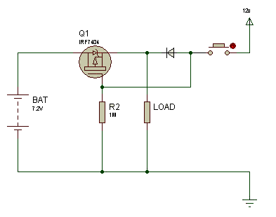

I'm trying to make a battery-powered device that plugs into an AC adapter for recharging. When it is plugged in, the circuit should still be powered from the adapter. I want to prevent the adapter from directly connecting to the the battery (limiting the connection through the dedicated recharge IC). In the past I've just used a schottky diode in series with the high side of the battery, but I've decided that even a few hundred millivolts is too much to waste. I've been trying to find another solution but so far haven't found anything that seems identical to my setup. Most sites suggest using a mosfet, but this is offered as a solution to reverse battery protection. Can I use a mosfet in series with a battery as I've drawn in the following schematic to prevent the adapter voltage (marked 12V) from flowing into the battery? Thanks.
What about a switched socket for the adaptor to plug into?
You can use a MOSFET, but you have to control its gate. As Mneary says, the MOSFET conducts in both directions when turned on. The power connections you have on the IRF7404 is correct, but you have to raise the gate voltage, to turn off the MOSFET, when the mains power is available.
I assume you're not bothered about the diode losses from 12V, it's the battery that's the problem?
You need a diode in series with the 12V and to connect the gate to 12V so it can turn off the MOSFET when its connected.

Thanks very much. That answers my questions both about how mosfets work, and about what to do.

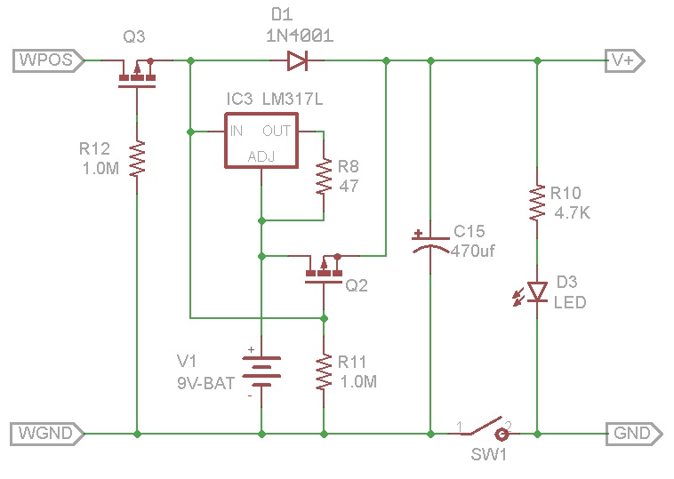

Battery/Adapter Switching Circuit
I am also interested in a circuit that will switch between a battery and an AC/DC adapter with minimal voltage drop of the battery. I also want the circuit to charge the NiMH battery while the adapter is plugged in (using an LM317 regulator to provide a constant current to the battery). Will the attached schematic work to block the battery when the adapter is plugged in?
-Jeff
