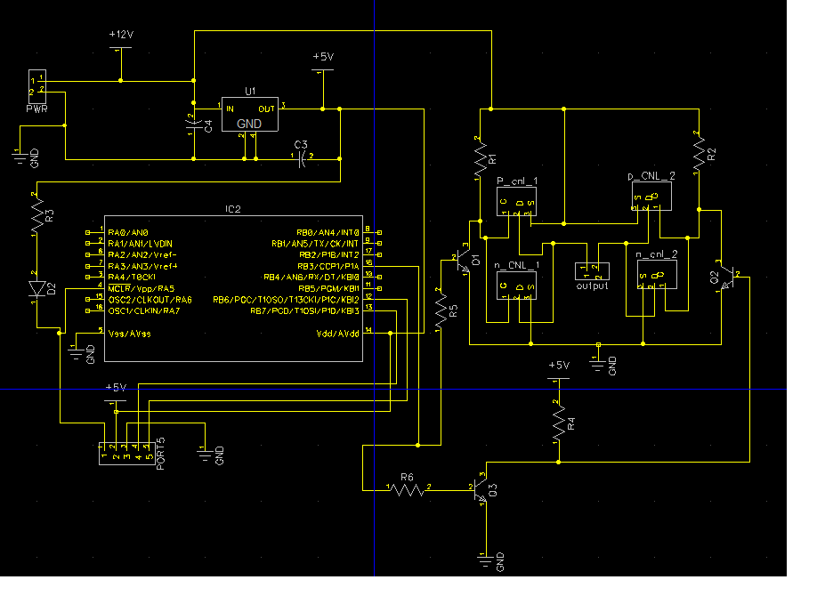

mosfet amp transistors getting HOT!
The datasheets for your Mosfets show that the N-channel one conducts 18.6 times better than the P-channel one so the P-channel ones are much warmer.
The piezo current is not high so the "shoot-through" current is what causes the heating of the P-channel Mosfets.
You cannot bolt both P-channel Mosfets to the same heatsink unless they have mica or polymer electrical insulation.
A heatsink inside a closed box is almost useless unless the box is huge. Use the surface of an aluminum box as the heatsink. The air outside the box will cool it.

Mosfets switch extremely fast. It is the high capacitance at their gate that slows down their driving circuit.
You have a 1k resistor that takes a long time to charge or discharge the gate capacitance. a lower value resistor or an active transistor will produce a higher current which will charge and gischarge the gate capacitance quicker.

I have never used surface-mount resistors. They are small so do not dissipate much heat. With 12V across 500 ohms half the time then the heating is half of (12 squared/500 ohms)= 0.144W. Is 500 ohms a standard value? 470 ohms is a standard for ordinary resistors.

One of the most important specs for Mosfets is the on-resistance. If the on-resistance is very low then most of the power goes to the load and only a small amount of power heats the Mosfet. If the on-resistance is high then much of the power that should go to the load heats the Mosfet instead.
The drive circuit for a Mosfet must switch fast, then the Mosfet will switch fast. Then the shoot-through current lasts a very short amount of time then the heating is low.
Mosfets have a high input capacitance that takes a lot of current to quickly charge and discharge.
The Mosfets you selected have a P-channel that works fairly well with a 4.5V or 10V gate voltage. Its max on-resistance with a 10V gate voltage is 0.105 ohms when cold and its gate charge is 47nC max.
The N-channel Mosfet is spec'd only with a 10V gate voltage and its on-resistance is 0.028 ohms max when cold and its gate charge is 67nC max.

Your kind of stuck. You either need to slow down the turn on time of the fets or limit the shoot through current. To minimize rework I think I would try to limit the shoot through current by placing a resistor (1 ohm would probably do it) in the 12 volt line feeding the top fets. The 330 ohm resistors still need to go straight to +12. The rating on the resistor will depend on the frequency you are running the piezo at and the current through the piezo.
Like I tried to say about 30 posts ago; that H-bridge circuit is brain-dead because it has NO provision to prevent shoot through!!!!

It was suggested by Audio Guru to replace R1 & R2 w/ 330 ohm instead of 1K.

Your new schematic software produces an awful negative image instead of a positive image like most are. But I am glad that the lines are straight.
It also produces a simple box instead of a Mosfet.
The schematic has no values for the resistors so it might not work.

The addition of a 1 ohm resistor might work but going to try the 330 ohm first as the circuit board is already to etch. Just inserting a 330 in place of the 1K (R1 & R2)
PLUS I am using heat sinks instead of a short piece of aluminium for each P channel TO-220 Mosfet.
