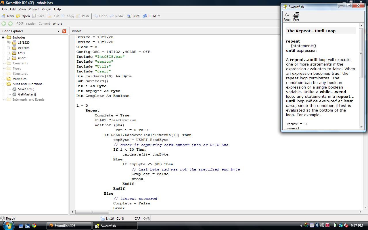

Here probably the best way to learn is to put your mouse pointer over any text in the IDE and hit F1
Look at the pic and you'll see what i mean it will pop up and show you how to use or how it is being used.
